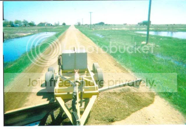

On my blade I get the cutting edges from john deere, they are a little cheaper than caterpillar. I run two 8' x 8" edges and the last ones I got were around a $140 each. These are the curved type. Bolt pattern is usally standard unless your blade is home built, the edges already have the holes in them. Not sure why the nuts are welded on, all edges I have seen usually use countersunk bolts.
