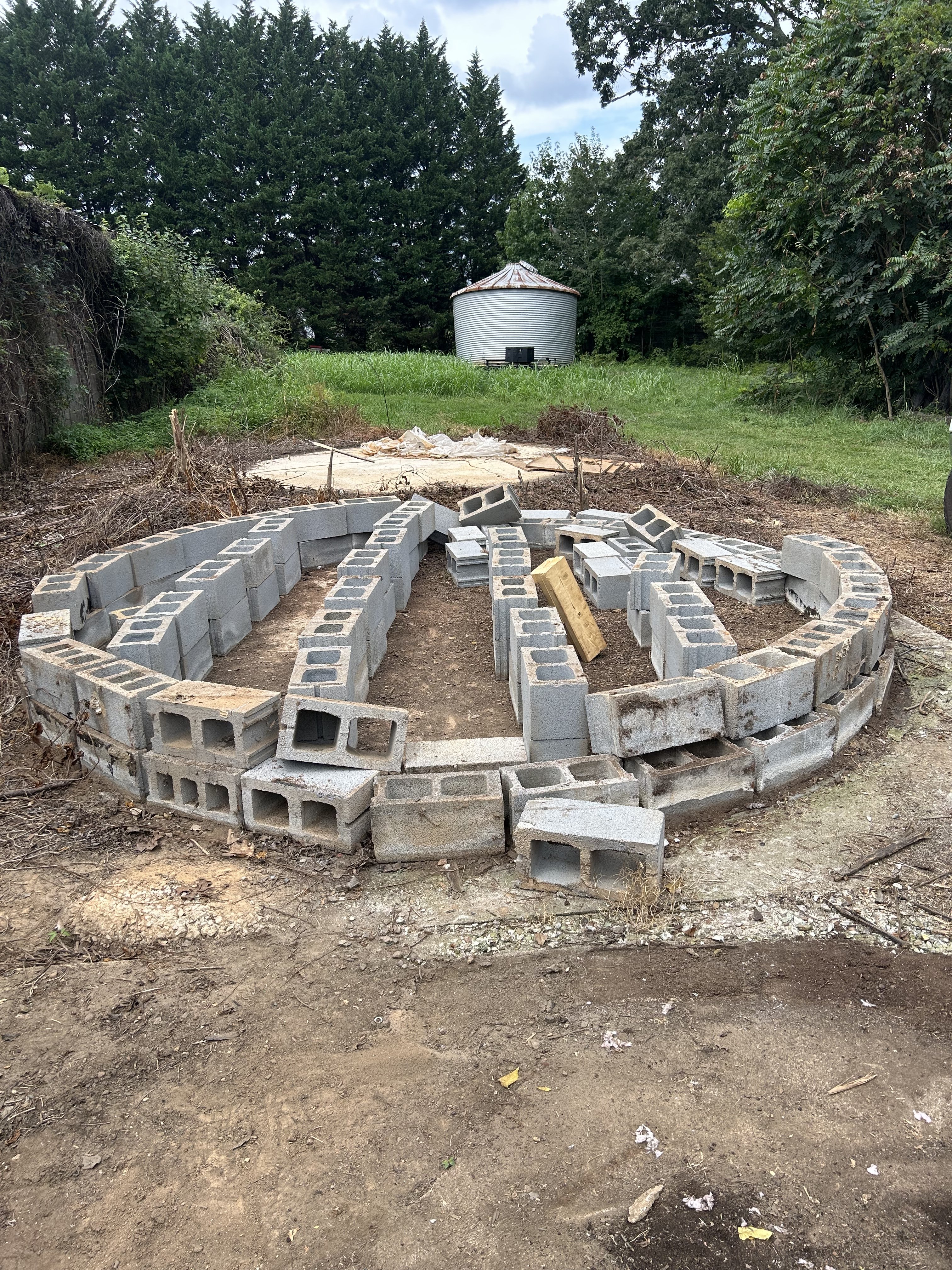

Grain bin height
Cinder blocks under the floor
Interesting. Seems every company has a different way of doing it. None of my bins have that partial ring at the bottom. They are all a full ring, with holes predrilled part way up for the flashing. I wonder if the concrete blocks were the bin company's idea or the original builder? Mine all have the metal stands. The blocks look like a major impediment to air flow.
That was under the other bin beside the first pic
