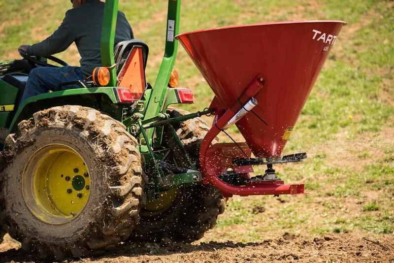

For food plots I like that 3pt spinner pictured and a section of harrow; but I don’t think you have a 3pt. They made bolt on and pull type but harder to find.

As wide as tractor would be best. Problem with spin on and disc if the soil needs a packer you need to harrow packer after broadcast. If you find broadcasting worked then I would probably stay that route as you can do fertilizer as well. Wash it real well and store inside with very little room needed
A seed broadcaster could work well. I do have a 2pt to 3pt adapter that i use for a grader box. I have 2 more that need a lil tlc.
Thanks for all the good advice. I guess it depends on what shows up for sale in good condition. Will look in local dealerships and see if rent is an option, or co ops. I didn't think of that.
Spreaders near me are overpriced and rusted out. Best one I just saw in marketplace for $500, might as well buy a new one at agrisupply for 700. If i see a 5-6' drill then that would probably be best for the plot size. I just haven't seen one for sale. My powerline is about 65 yards wide, with woods on both sides.
