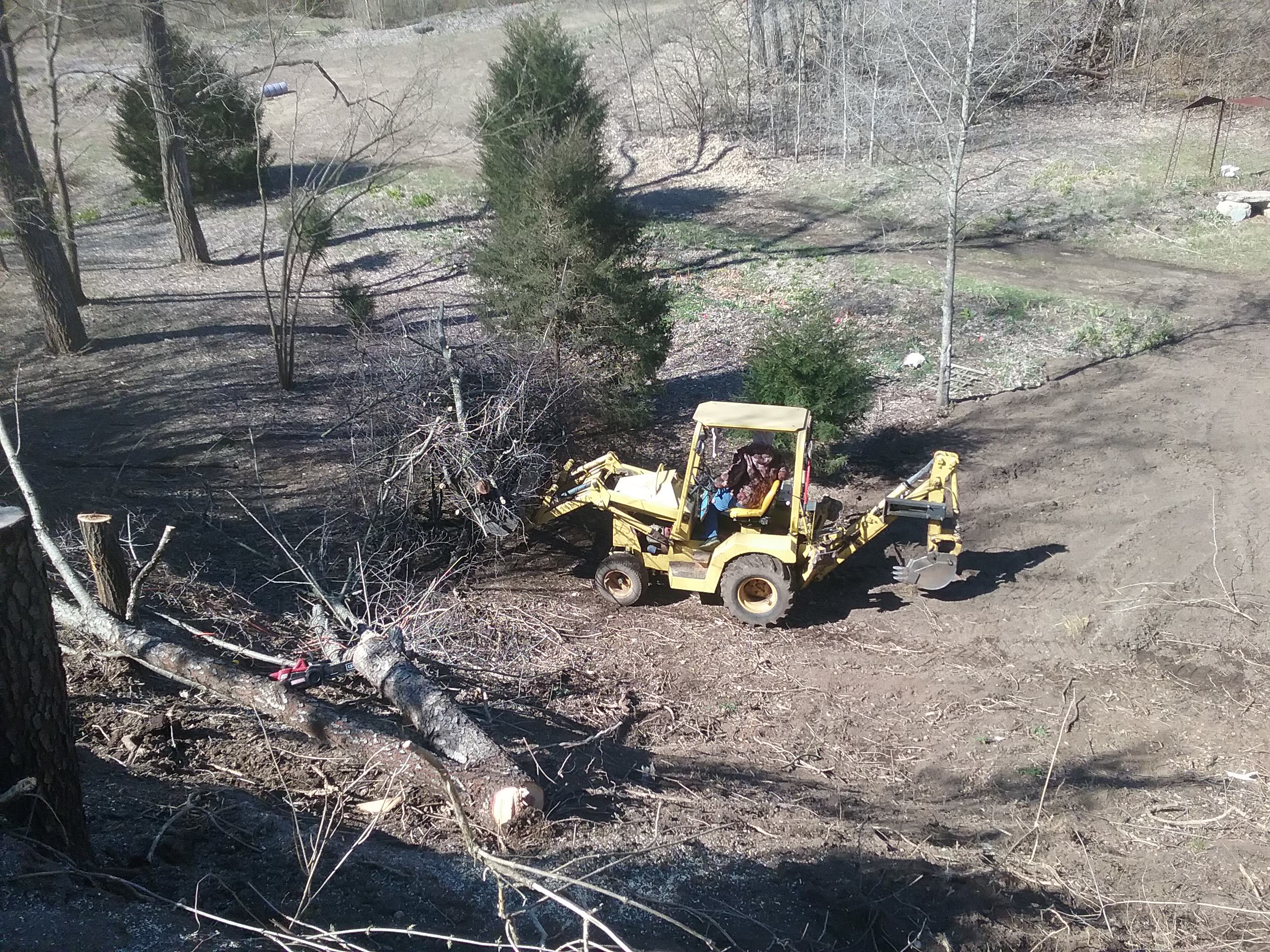

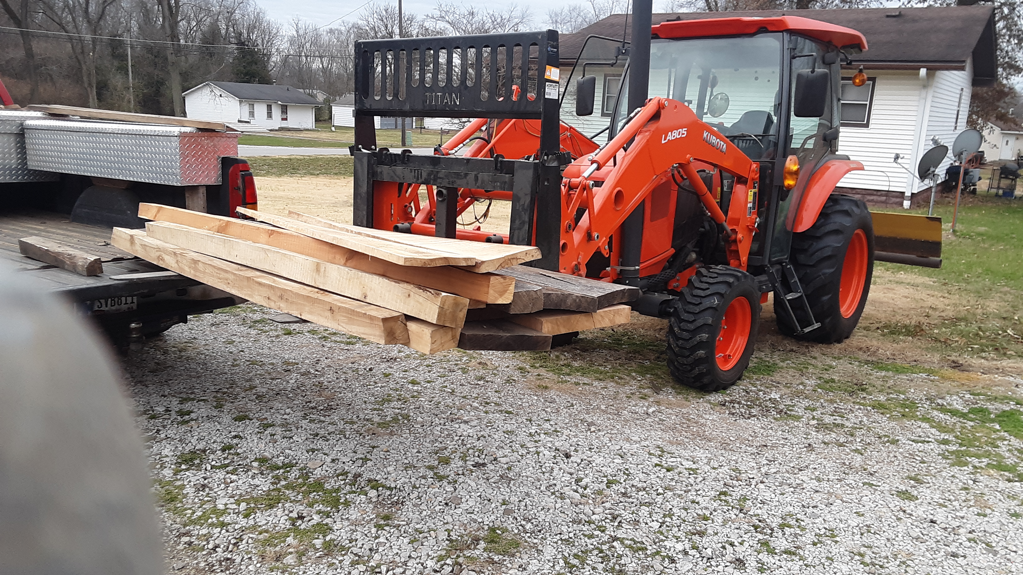

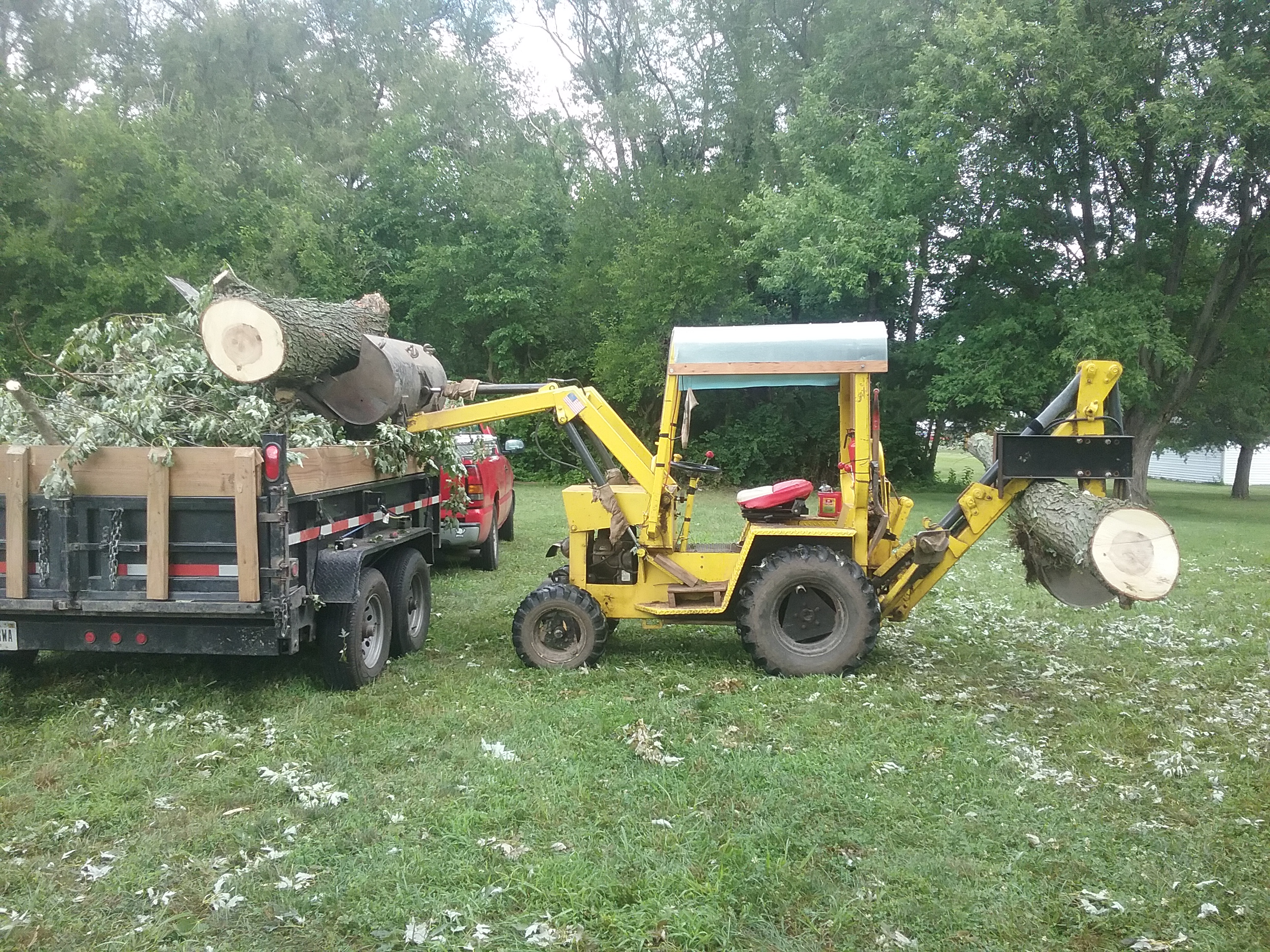

I have 4 ft forks for my L3560.. I made 4 ft forks for my Terramites.
I worry about using forks on my L3560 to pick up sticks. Many times I've picked up sticks with my terramite.
that would poke holes in radiators. My Terramets are Air cooled. One time I damaged the crankshaft seal on
the terramite with a stick .
One can pick up more sticks with forks than a grapple.
If I only had the Kubota, I would put a piece of plywood in front of my Titian forks brush guard to prevent
damaging the radiator. I might want a second layer of protection to protect the radiator.
I picked up all the branches with the terramite forks then loaded the logs.
With a little practice, forks will pick up sticks. The last pic is my Boss picking up sticks. How many have a woman that use your tractors?
My Boss is a country girl raised on a sod farm and no stranger to using tractors. She can dig small stumps with the backhoe.
I would try using forks instead of a grapple.
