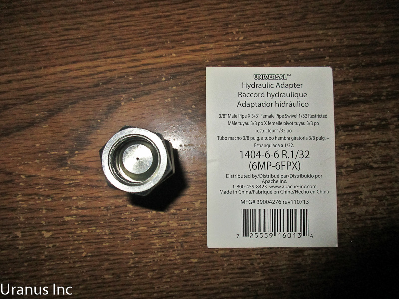

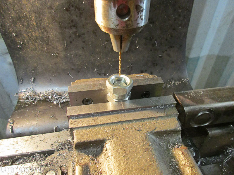

Built a grapple years ago, and ran into something somewhat similar. Violent cylinder movement.
You probably need a flow restrictor on those lines. It slows it down.
Chances are.........you'll need to fine tune the orifice. I drilled mine out a bit to allow more flow.
As far as both cylinders not reacting at the same time. It's normal. Unless all lines are equal length(and sometimes that doesn't really work well), like diesel injector lines. it will never operate in tandem. Or.....you can spend a ton of money to do it with flow control.........which isn't necessary.
