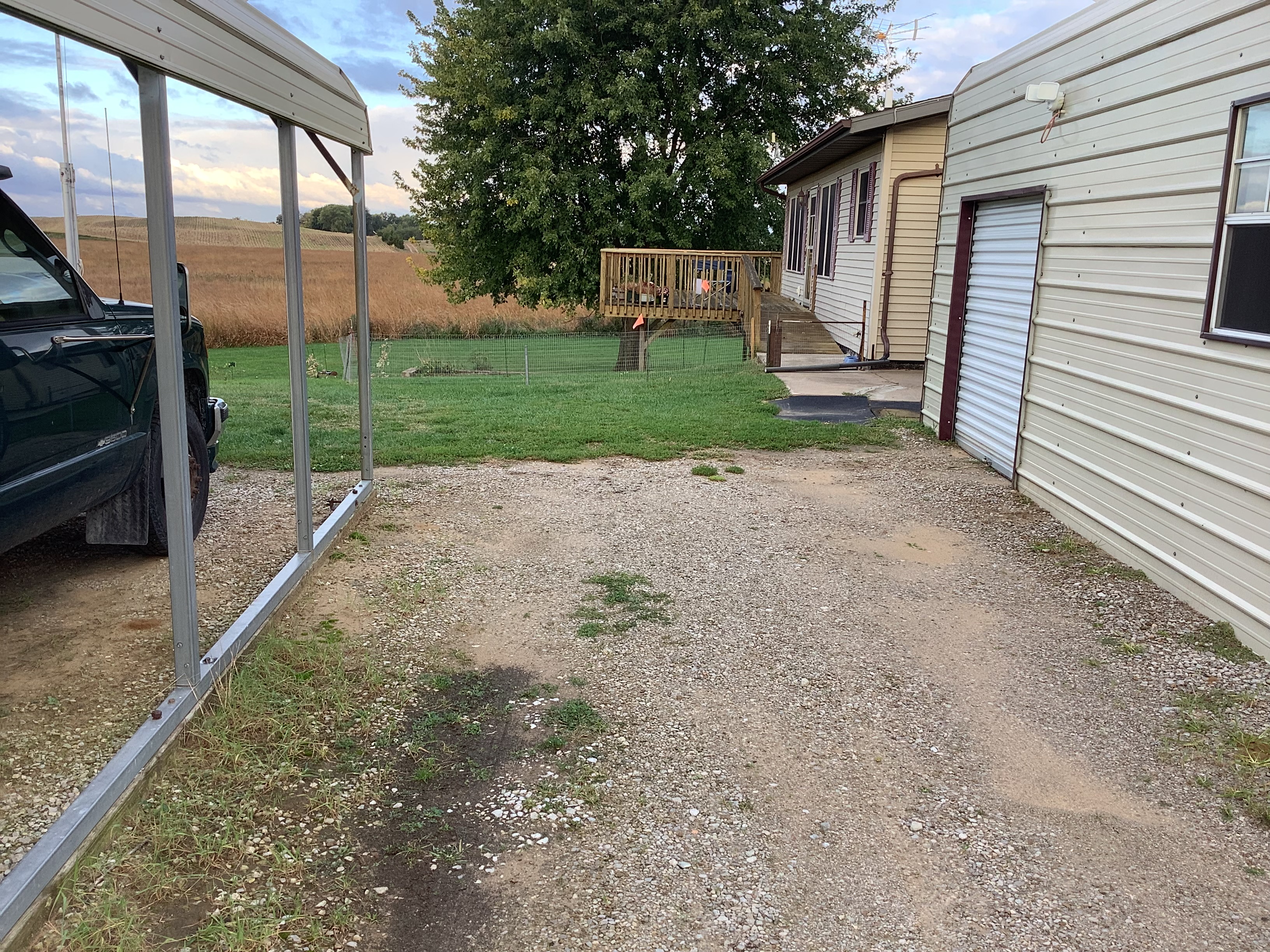

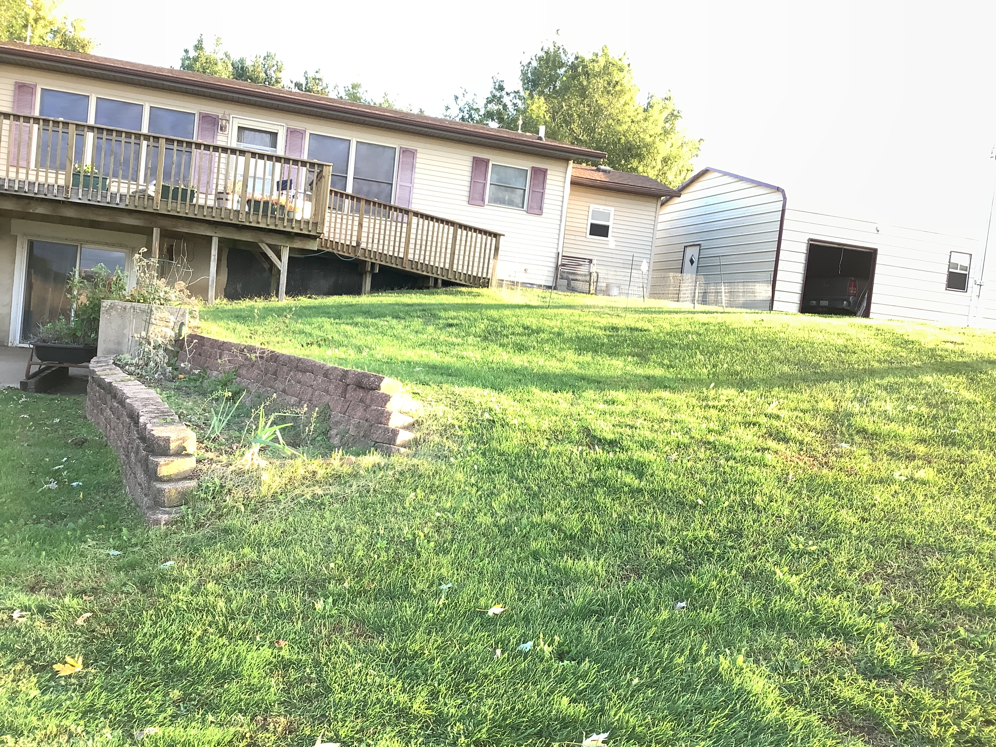

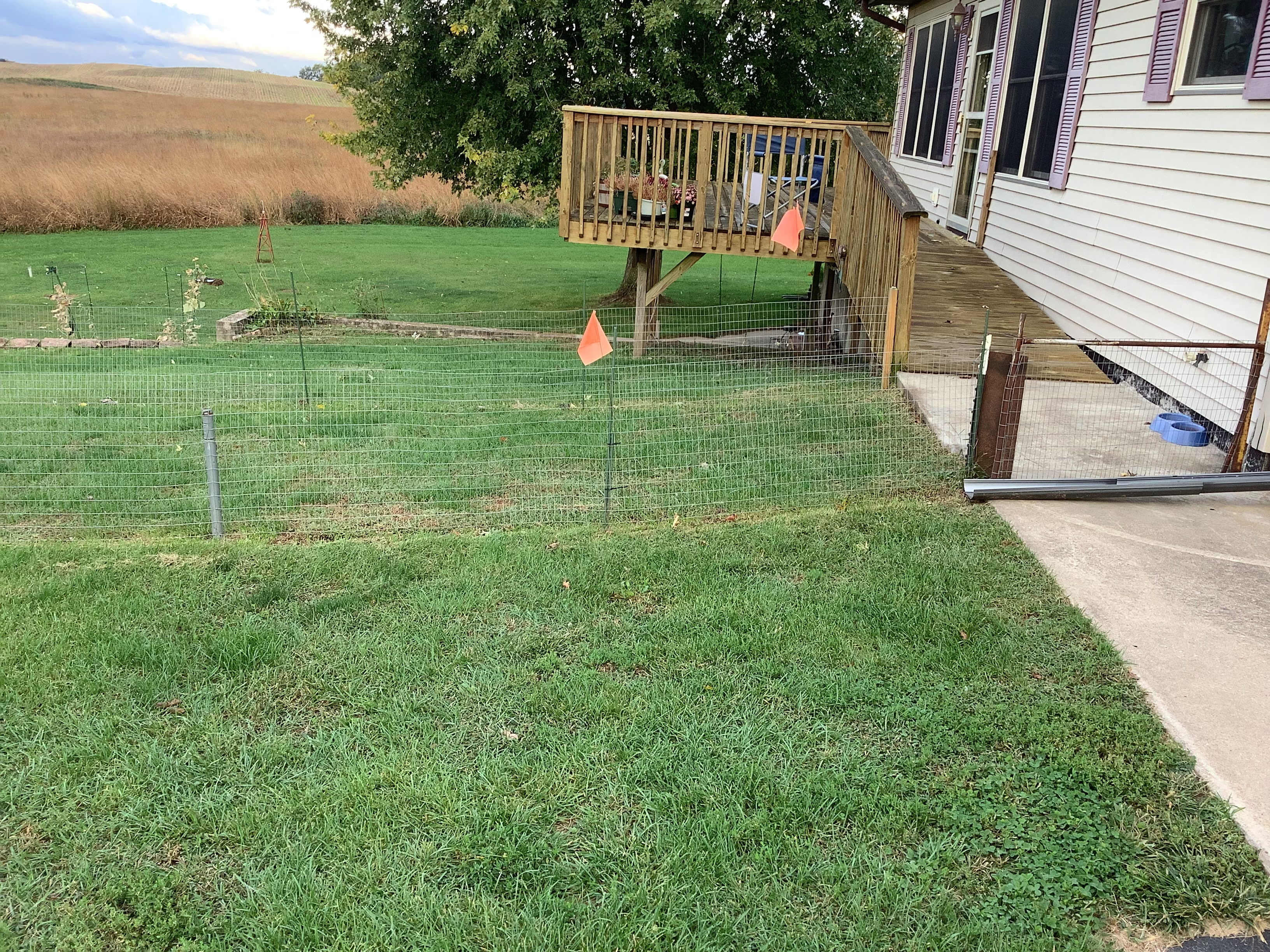

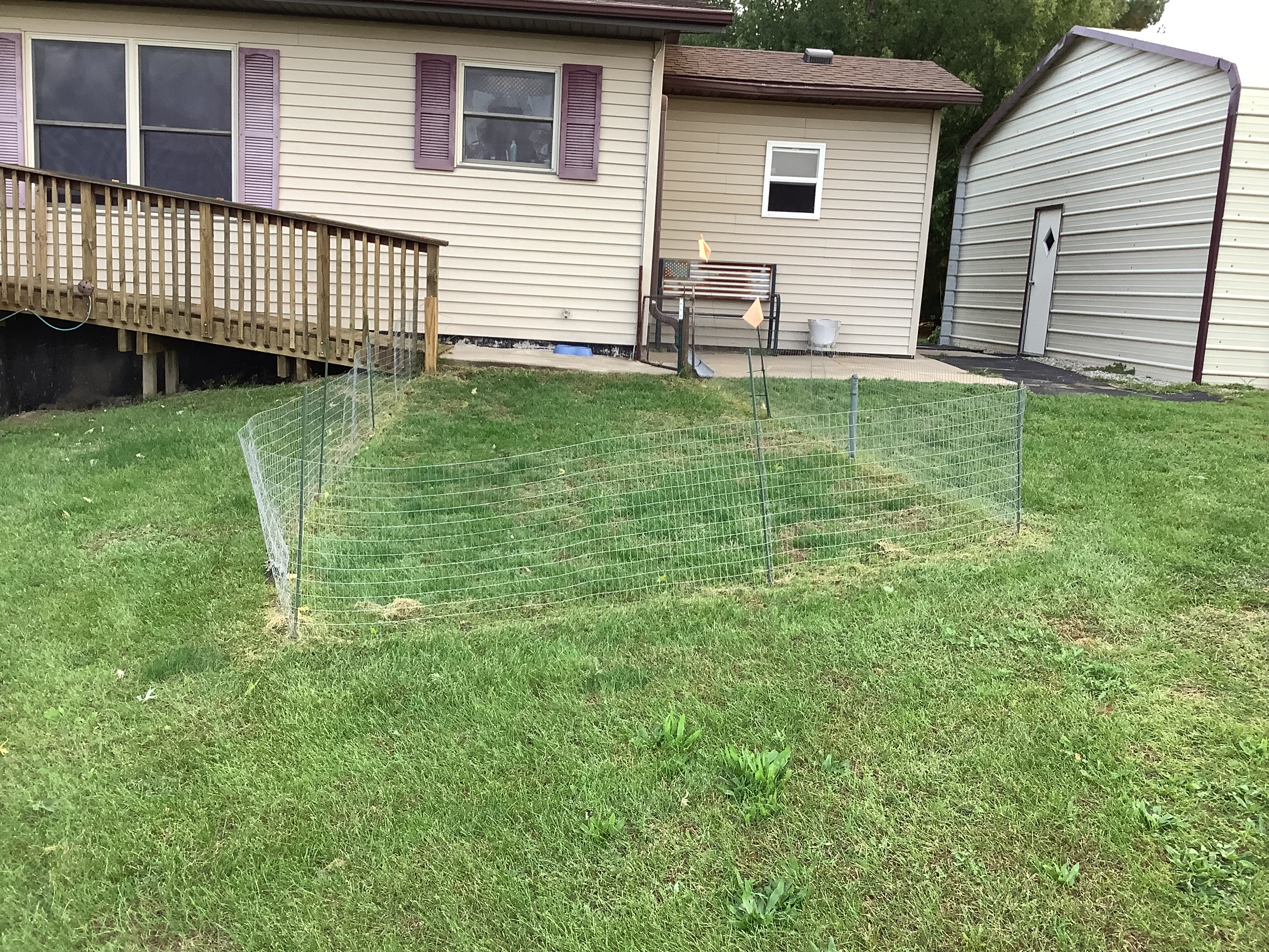

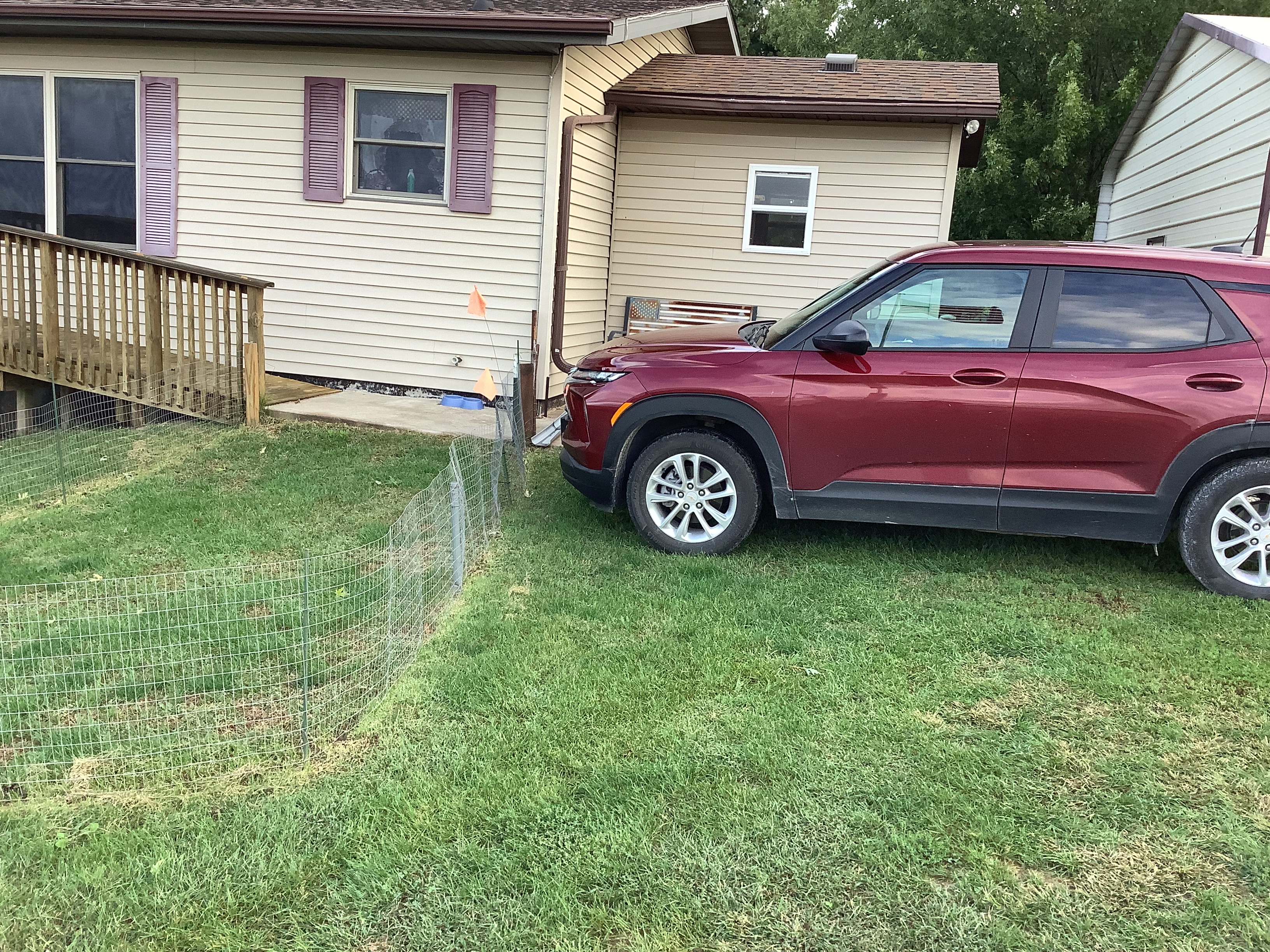

I need to add a place to drive up close to the ramp from my deck to be able to get my wife out of the house and into the car, she can't do the 2 steps from the other door anymore. It's just grass now with a slight downhill grade. When the snow gets here, I'm afraid of getting the car stuck. I need to remove a little dirt to make it level and then rock or crushed blacktop to drive up on. I'm thinking that the blacktop would be a smoother surface than gravel for snow removal. I can get crushed blacktop for $15 a ton, rock is quite a bit more. Anyone have experience using the crushed blacktop? If I get a tandem load can I move it ok with my loader? The dog fence will go away. Thinking I’ll need railroad ties or something to make a wall at the ledge. Thoughts?
I would like to pull the car up to the end of the handrail.

Pro: it knits well, drains reasonably, and low spots can be easily filled.
Con: it remains tacky for a long time and especially in hot weather so small bits will stick to shoes and track inside.
Buddy had it for years but eventually paved over but mostly for snow removal.

Millings as I have come to know ground blacktop does work well and packs down well and get also like it had been poured and rolled over time. Hauled many a load back when I still drove dump truck in this area
My one experience with using it was I let it sit overnight after being dumped in a pile. It was a hot summer day, and by the next day it was already hardening. I got it leveled out with my skidsteer, but I was surprised at how quickly it was getting firm. A few days, and I think I would have had one big hard lump to deal with……
My opinion, level it out right away after delivery.
Good stuff. Real expensive around here. My brother was in the excavating business and sold a lot of it. My west driveway has it. It always held up to the semi milk truck coming in and out every day, year around. I have it between the barns too. Only place it didn't hold up was in front of the feedlot gate and the bunks. Anywhere that I had to scrape it off with the loader, eventually I dig holes in it and once you gouge a hole in it, it's done. My son has it in his driveway all the way up to the approach to his garage and the pole barn. He just had some spread for his new machine shop too. The experience we've had with it, when you first dump a load, you about have to spread it with a bull dozer. If you drive up over it once, it's set too hard to get it smooth any other way. We haven't had any issues with it getting tacky in hot weather. It sets up like regular asphalt. I've ridden on it on rails to trails bike paths too. As long as you're in the packed groove and not up on any loose stones, it's smooth and hard.
i have had good luck with it, i had 2 tri axles of it dumped in front of my shop 30 years ago when i built it. good smooth surface but like M nut said work it sone after to get it were you want it.
Quality of the product can vary depending how much gravel got picked up with the asphalt. Sizing of the product can be an issue too depending on if it is straight from the reclaimer, or if it has been run through a crusher. I have seen some recycled asphalt laid down with chunks the size of your fist. Local sale barn had their lot done. It can be a bear to walk on with the chunks in it. I would ask to see a sample of their product before committing to having it laid down where a relatively smooth surface is the desired outcome. IMO. YMMV.

A number 1 thing is prep. Top soil, sod, down to hard pan. Looks like will drain, bonus. I think 411 crushed limestone, packs well and snowblower safe, will look better with the driveway now. That will be your call.
