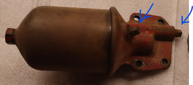

Do they make a spin on assembly for an H? IF so, who has it. ALSO, does anyone sell the rubber rings that fit underneath the canister minus the filter?
Everyone sells it a quick google search will lead you down a couple paths. Mine for the super c came from case ih themselves they don’t list it as for a c but the h kit fits unless they discontinued something in the last 5 years that’s how I did it. 51051 wix is what I’ve used

Go to case ih. All them square o rings fit all those tractor models from that era.
Yep so after you pull the plug you still make the mess anyway because you can’t pop the hole in the side down low to get the rest out. Both of them hold the oil in the same spot. One you can poke a hole and get it out nice and clean and one you dump all over pulling a bolt out.
Guess I'm not following you. The filter base has 2 pipe plugs , can use either one, and they drain neatly into a pan. I'm not getting the part about poking a hole in the can.

Don’t see how u dump oil all over. I use a soup can and drain the oil filter housing with the drain plug with the canister bolt loosened.

Fixing Farmer. I see strenier dosnt have it Barnyardengineering. It isnt a matter of inconvenience. Its a matter of not being able to get the SOB to seal. Ive never had much luck with getting a seal using the origional equipment. It had a tiny leak before, and I needed it today, and as yet cant get it to seal. Fritz, mine only has one drain plug, and the one that was in it had been turned in and out so much that the square head was rounded off. I finally got it out and bought a new one

Where exactly is it leaking???
I have seen the top of canister deform from over tightening. Good & snug with a wrench should do it.
The other thing is to be sure all the old gaskets are out of the bottom, That groove is quite deep.
It will never seal if there is old gasket left in the groove.

Keep a close eye on your oil pressure if you put one of the spin on oil filters on your tractor. I put two, one my H and another on my C. The oil pressure was lots lower on both tractors. I took them off and pitched them. I would rather use the original filter and have good oil pressure. Just my experience.
