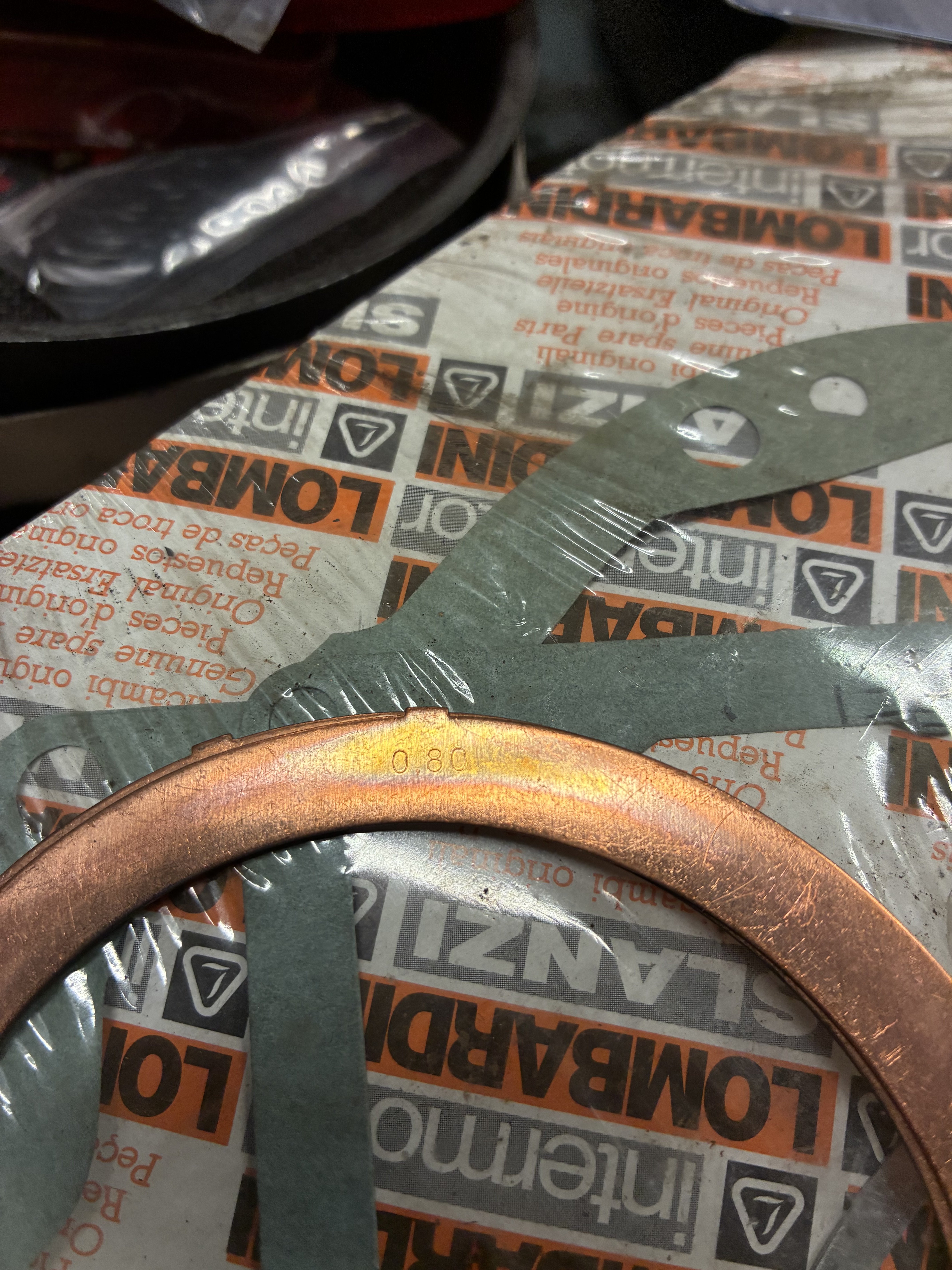

I am working on a 1965/66 cast Italian orchard tractor with a 35 up slanzi air coold diesel trying to find head gaskets i found some info. If correct the 435l and the lambardini 12ld share the same gasket just hate to spend another 150.00 on gaskets I can't use any help locating the right gaskets would be appreciated
It's not the money it the fact that they will say these gaskets fit so you buy them then they don't fit once you get them just trying to find the right gaskets

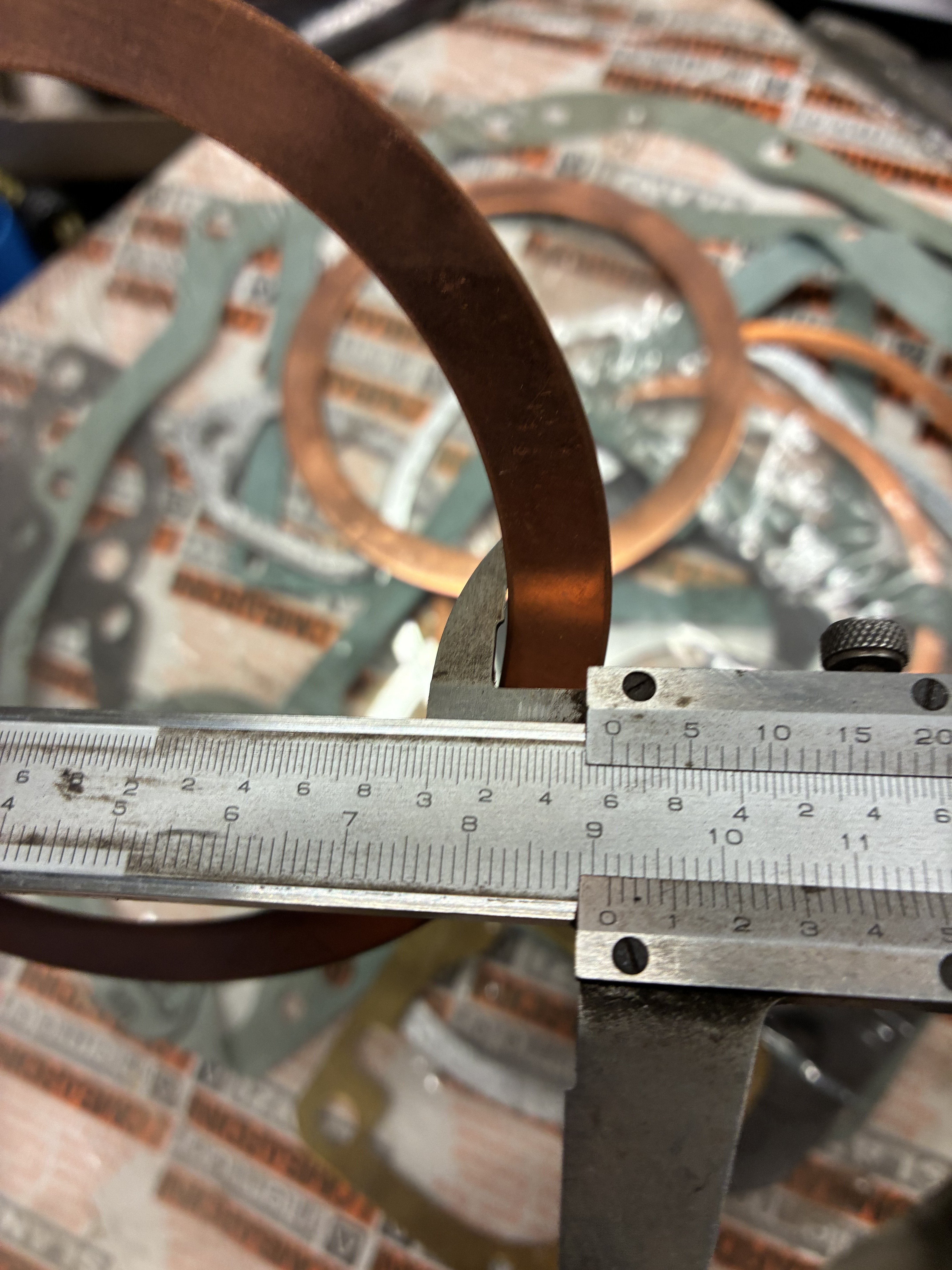

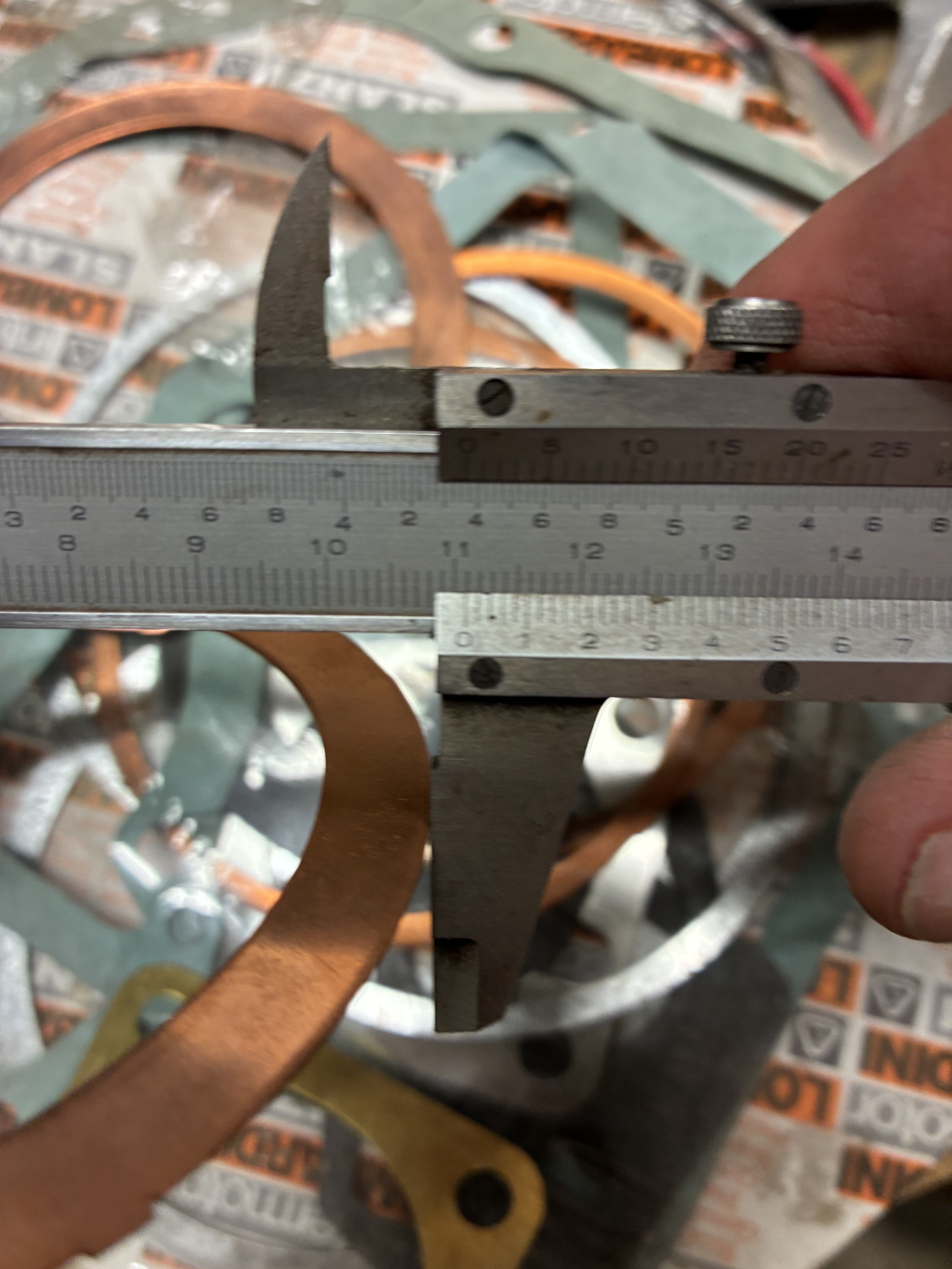

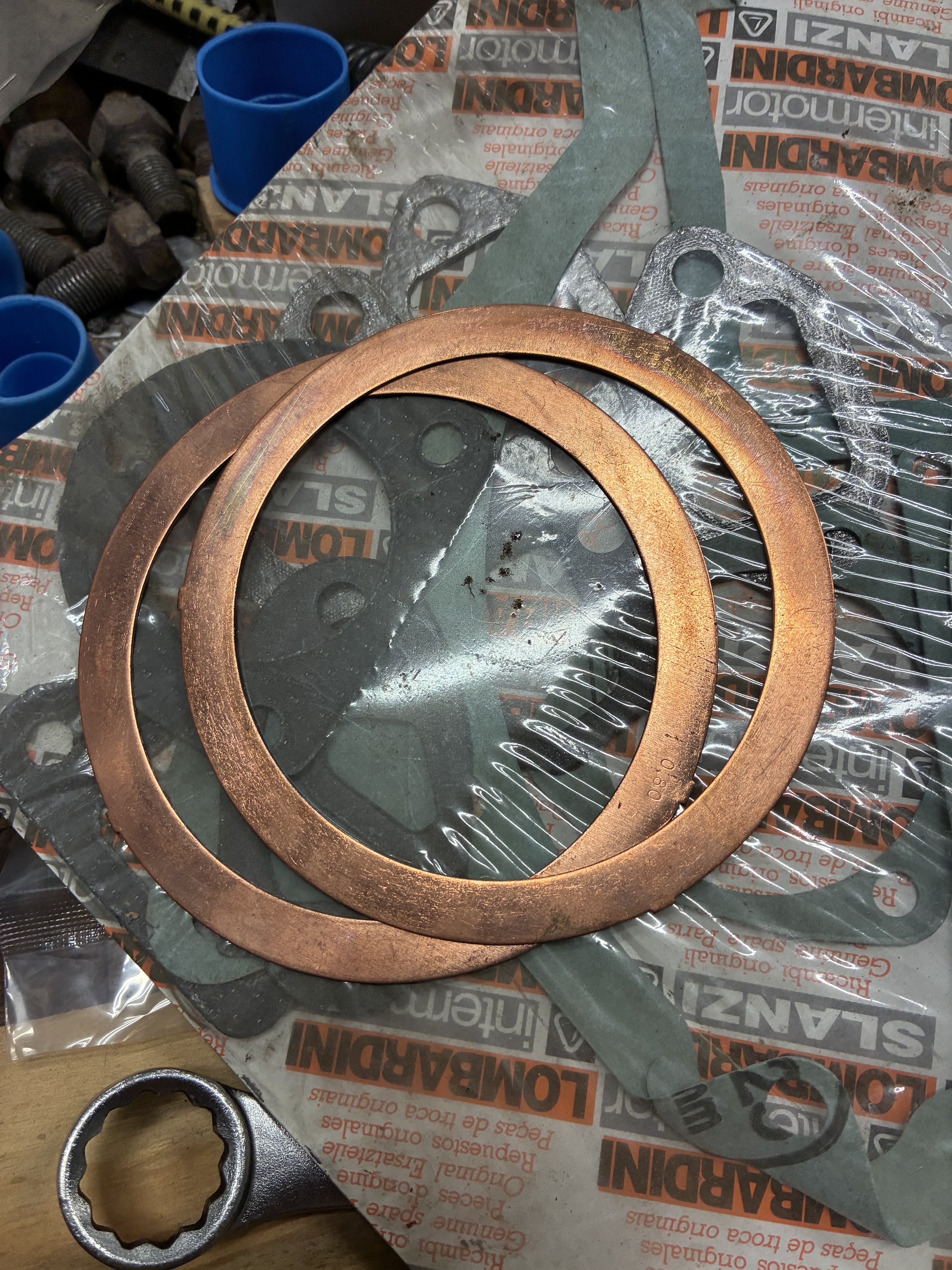

Looks like the right inside dia, but bigger outside. 0.8 mm thick.

Correct thickness IMO is important. So far I have seen, .75 mm, .80 mm,.90 mm and owners estimation of 1,5 mm. I would be looking for same thickness as removed or you may come to grief with too thin . Too thick and reduced performance and harder starting. Some one could have doctored this thing in prior lifetime and you really need 1,5mm. gaskets. Have fun.
