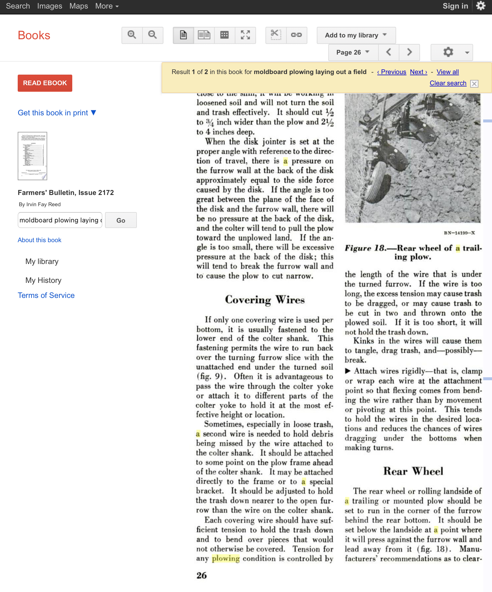

Best way to deal with a tall cover crop was always to tie a good heavy long wire on each coulter bracket very near the coulter center. Let the stiff wire flow across and into the furrow long enough to hold the wire down into the furrow covered with dirt, the cover crop would be folded under the wire and covered up very nicely. You could turn right very easily, you had to be careful making the passes turning left on headlands as dropping the plow on the wires would cut them off and make them way too short.

The wires need something to attach to, and the low bracket of the coulter is the perfect location to tie the wire to. I’m not sure how to make the wires work right without the coulters.

So cause i don't have coulters to attach the wire to.. will it work attaching the wire to the frame or will that be too high? should i maybe attach a bar where the coulter should be about 6 inches down from frame and attach wire there?

As a young kid all the way into college I plowed our tall (3 to 4 feet) sweet clover using wires. I attached fairly long wires to the frame of the plow so they were well buried in the turned over furrow. Worked great and most of the time there wasn't any clover sticking up out of the furrow. All of it was buried.
