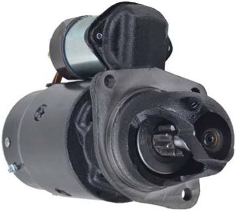

A fellow Funk owner told me that he believes Funk used Minneapolis-Moline starter drives. these aren't pulled into the ring gear like were common for Ford at the time. They are shoved into the ring gear as they are today. It looks like a mirror image of the Lincoln / Truck 337 starter drive. There are very faint markings on the body but too faint to even imagine one letter. Does this look familiar?
Thanks, Chris
EDIT: These are custom built starters and the nose cones are said to be made specifically for the 6 cylinder and V8 adaptation to N Series Fords.

All MM used Delco starters except in early 60's when tried Prestolite. If have original starter model can cross to most all drives. No MM used the Ford type starter like on Y blocks.

Thank you for chiming in. I went back and added relevant details I originally left out. Pictured is the nose cone slid in place and the side of the tractor where the factory 4 cylinder starter would have been. Starter drive could be pre 48'. This information came to me second hand from a man who met one of the living Funk brothers in the 1980's.

To me the R, Z and U starters looked about the same. Some of the loose starter drives said to be for these starters had the champher on the wrong side. Can help but think these were flipped images. None of them were exactly of the same design as mine. The starter in the link below looked like it had the same action and champher as the drive on mine. Thanks for helping find a place to start.

One pictured is a Jet Star starter with mechanical/electrical solenoid. UZR use a saddle type electric solenoid. UZR starters look the same but all different Delco numbers.
If you are looking for another starter drive, is there a tag still on the starter?
The bendix you show makes me think 'aftermarket' because of the cover just behind the gear.

I'd appreciate it if someone has some time to measure their 4" starter drive against the measurements I supplied. You would be a hero in the Funk community and surpass any modern archeologist.
The drive I have appears to be a mirror image of the 337 starter for the Ford 8EL-11002-B starter. Of course being a mirror image it won't work in this application.

I run FE and MEL in 65-66 F Series pickup's in case you have questions or need measurements of anything. Been helping if and where I could for years.
MM UZR isn't that type of bendix. It has light spring on end. More like a G. U is 4 inches teeth .70 and diameter is 1.52
This spring offers light resistance also. I'll ask the starter builder to look at a G and go from there. Thanks
