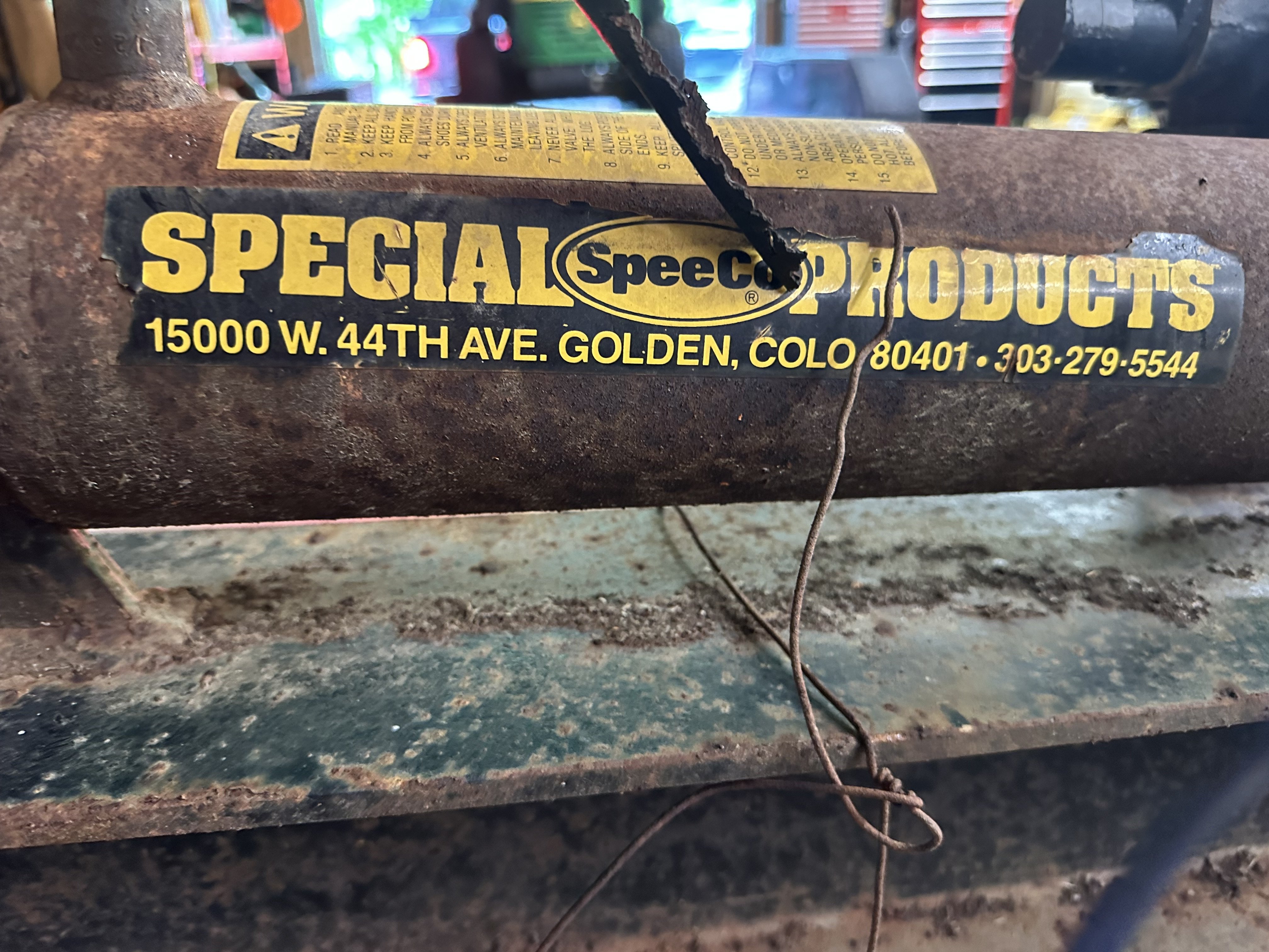

Probably a Speeco. They were made in Golden,CO. Speeco painted their stuff yellow. They also mode 3 point hitches and wide fronts,and a whole bunch of other stuff.
what are you rebuilding on the splitter? I have a Speeco splitter from the 70s or 80s. I think may have to just research each component on it's own. You can probably get seals for ram from hydraulics shop, or replace it with one from Surplus Equipment. Valve is ordinary hydraulic valve, probably with a detent in one direction.
They were made from vendor/component parts.Common off the shelf items. Get at any hydraulic shop. I doubt very much that Speeco will have ANY repair parts.

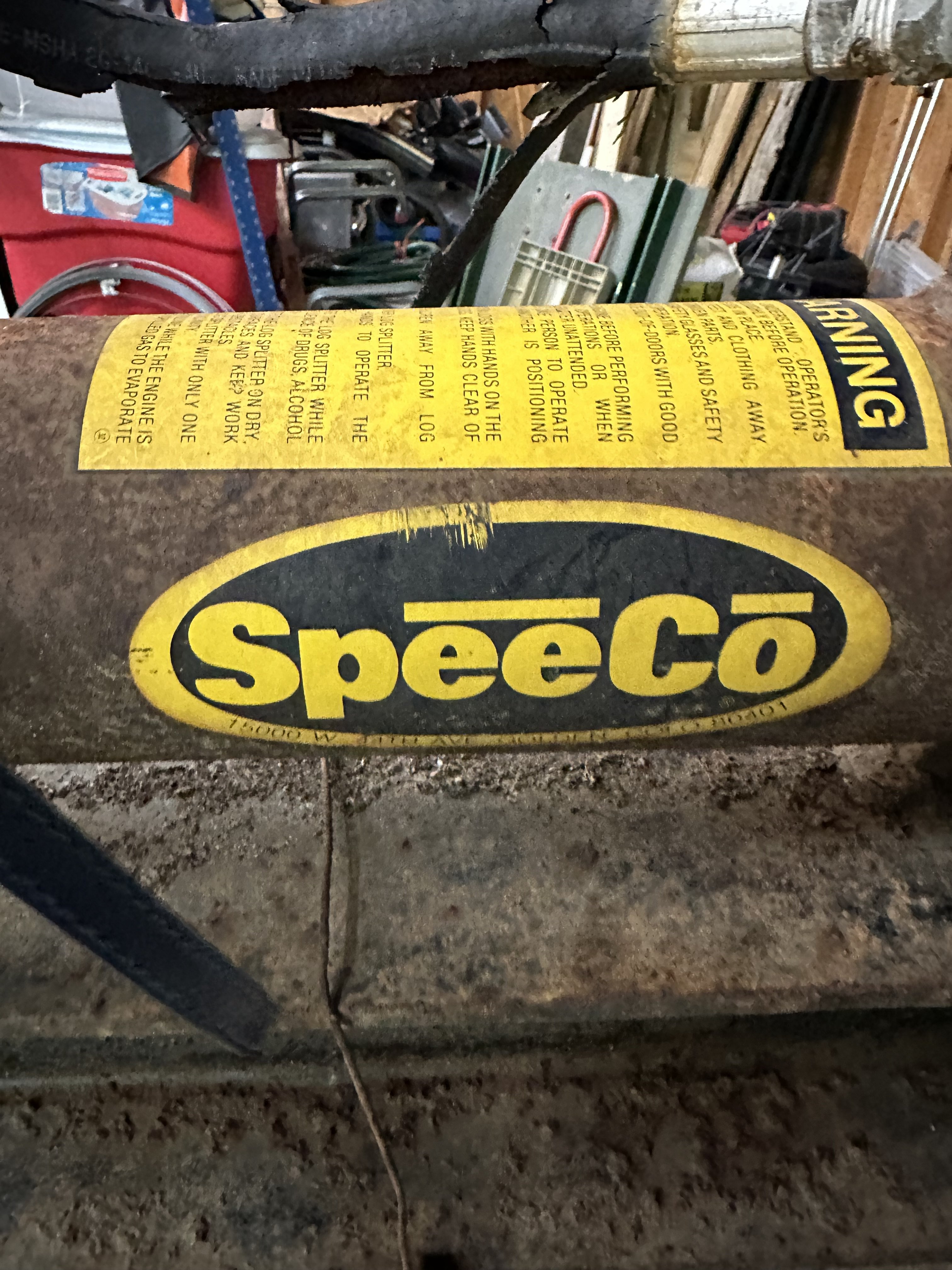

I just was given this one looking for parts
Check out Ruggedmade.com for wood splitter parts.

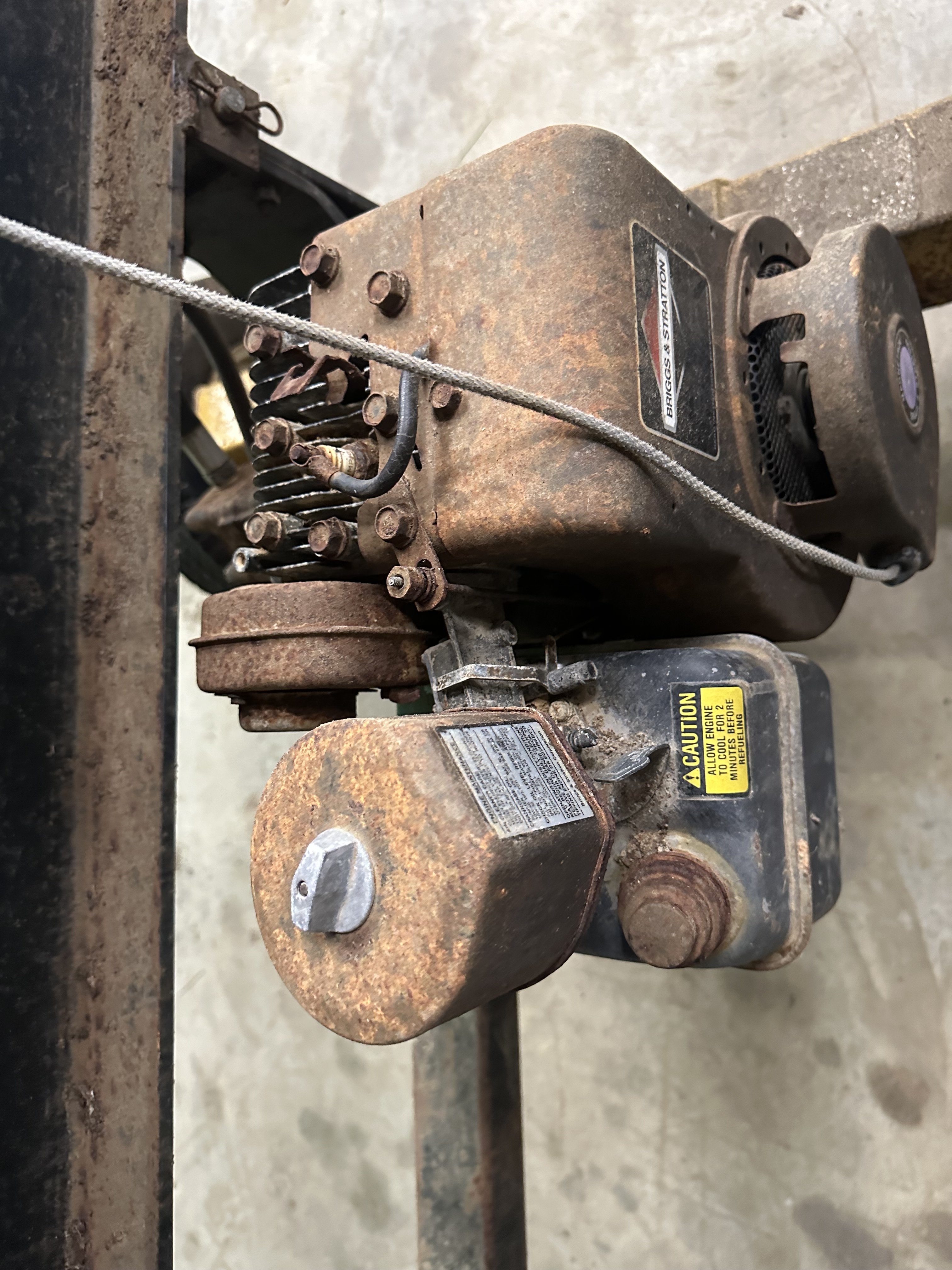

Parts, as in what, though? Have you tried to operate it yet? Looks like it could use hoses for sure.
The engine is a common Briggs and Stratton 5HP. If the engine is beyond repair, most would just replace it with a Predator 212cc from Harbor Freight. It will bolt right up.
Pump is just a common off the shelf wood splitter pump. Can get them from 100s of places online, or Tractor Supply if you want to pay more.
Hoses are just common off the shelf 1/2" NPT hydraulic hoses you can get at Tractor Supply or another farm/ranch type store if you prefer. Just measure length and buy the closest match.
Cylinder may be a cheap welded cylinder that will cost more to repair than replace. Not sure if it's a full 24" stroke or a little shorter. You'd have to measure that. Lots of places to buy a new cylinder.
