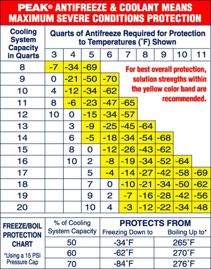

but I put PREMIXED in I so I think it should be 70% premix and 30% water come to think if it

Sounds more like the 70 is water. Here is a common antifreeze mix/performance chart

I would for certain throw out that tester or revisit the instructions as to how it is supposed to be read. One thing that is common when using the glass tube type with the floating balls is that air bubbles adhere to the small floating balls. This throws off their accuracy. You need to repeatedly squeeze the bulb to flush the coolant over the balls so their surfaces become fully “wetted” and the “hitchhiker” air bubbles are gone. Secondly, do you still have the jug it came in? Recently antifreeze companies have followed suit to soda pop companies and are selling water at a very inflated cost. I am talking about premix antifreeze. If you mistakenly bought antifreeze that was already premixed and diluted it again this creates a problem.
As far as running it, I would suggest placing a tarp over the hood and engine that will touch the ground on both sides and cover the front grill. This way any heat crested by the engine and the exhaust system is recirculated back up under the tractor. You may need to prop boards against the tractor so the tarp is held away from the exhaust in that area. Once the engine is warm to the touch drain out about 3 quarts of coolant and fill it back up with full strength concentrate antifreeze, this means NOT premix.

Thanks, used red MN. I just reread #12, first pass I was thinking he got 70/30 premix blend which would be strange. He added water to premixed and that raised the freeze point up.
that8nguy,
You do not add water to premix antifreeze. You are best served with a 50/50 mix for freezing and boil over.
Never heard of 70/30 premix. Ours up here is all 50/50. I would start it up but put a sheet of cardboard in front so you do not pull cold air through the rad. watch the temp on the engine and even open the rad cap so you can see the water circulate. once warmed up let it run for a while and remove cardboard once liquid/no slush. then test again with tester and ad strait antifreeze till you reach the correct ratio. You may need to drain a gallon or so. when testing I do 3-6 tests till I have consistent readings.
