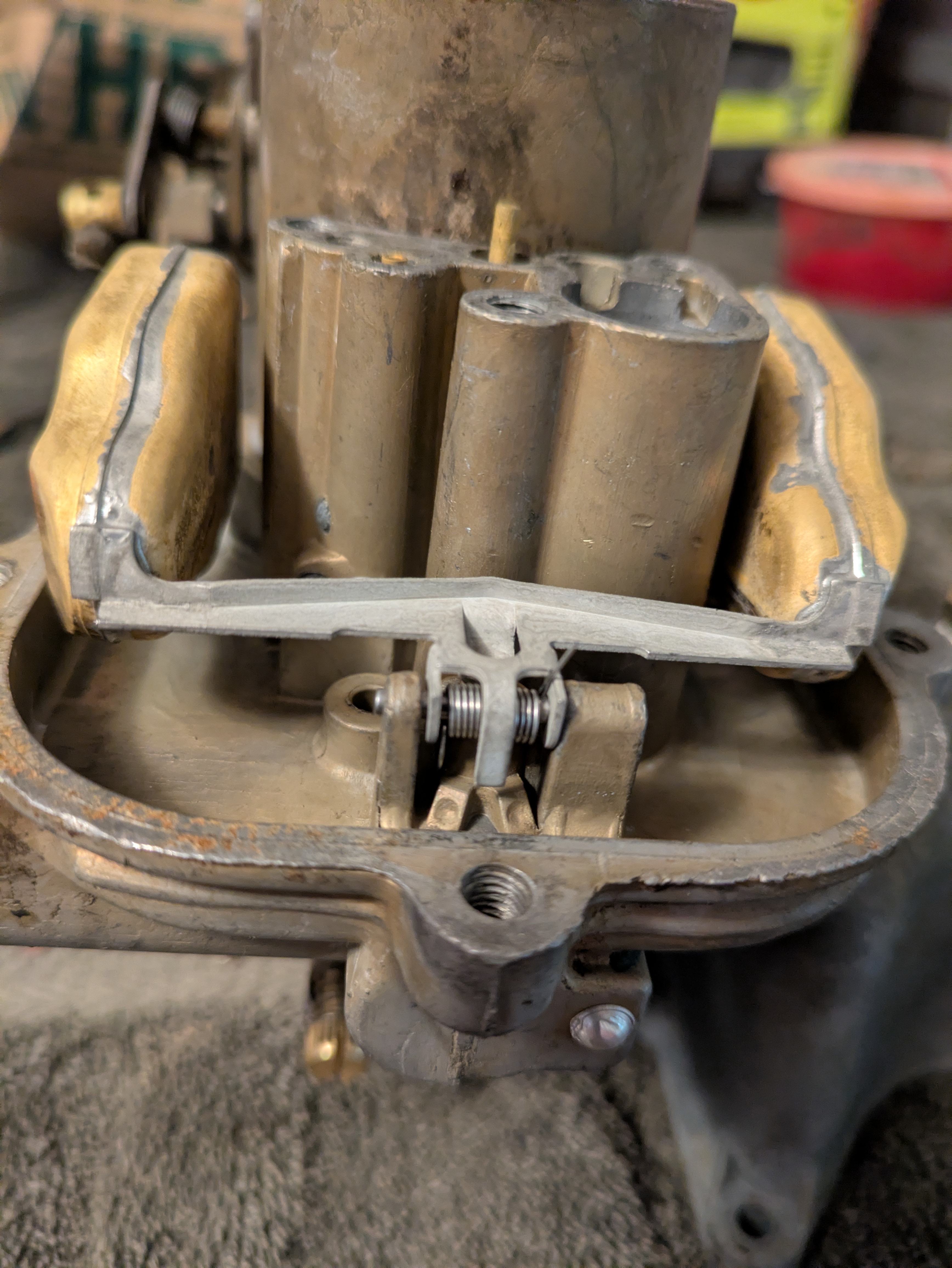

After a very long hiatus, I'm finally getting back to work on my tractor. Along with everything else I'm doing, I decided to rebuild the carburetor. I think the accelerator pump was sticking a little so hopefully when everything goes back together she'll run like a top. Anyway, I've searched and searched and wasted quite a bit of time with no definitive answer. How does the float pin spring go back in? I've read it gives upward tension to the float and I've read it gives downward tension to the float, so which is it? Currently, I have it installed giving some upward tension on the float. What's the consensus?
Perfect, thank you! I'll get it switched around tomorrow. I've got another core so I'll go ahead and build a second one while I'm at it since I know what I'm doing now. Much appreciated.
I just installed the spring but in this orientation there isn't any tension on it at all. Maybe I need to try to wind one side as I'm putting it together? That's part of the reason installed it like I did so there is slight upward tension on the float and enough tension to keep the pin in place and avoid the float bore wear.
