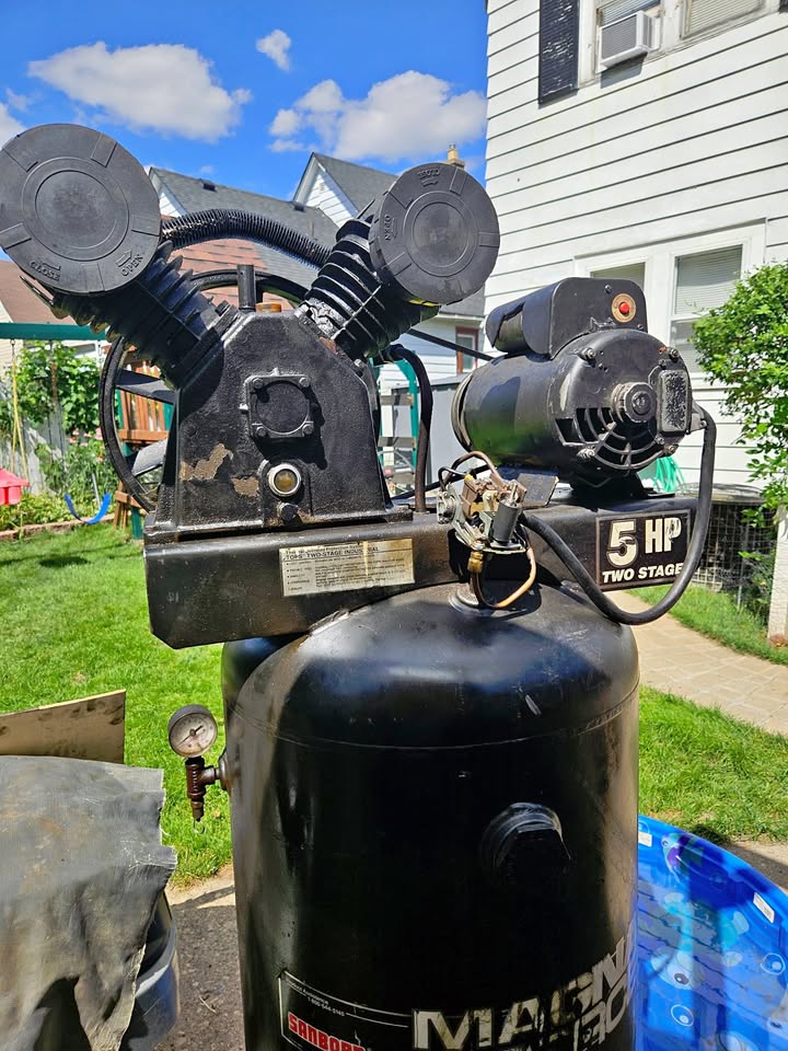

Looking at the compressor that you have pictured, that is the type that unloads through the control switch....I was wrong in saying you couldn't use that; that is the exact item need if the new pump you purchased does not have a centrifugal or a remote unloader.
But....
It will require an electrical solenoid to operate the throttle with the pressure switch. Because you will need to separate unloader devices, one for the pump and one for the throttle; it will be very nearly impossible to make them both work at the same instant, which they need to do. If the pump unloads first, pressure building will cease and the engine will never decelerate. If throttle unloads first, the pump will stop, but remain against tank pressure and require a lot of HP to restart when air is called for. The second scenario is not impossible to overcome, you just need a robust clutch and a lot of HP. I would say that for a 20 cfm pump, 8 HP would be about the lower limit.
I did think of using a electric clutch.
The one we have has no electric switch. It has an air solenoid that works the throttle on the motor. Motor goes to idle and clutch disengages.
Motor only runs pump when pressure is below set point and rpm is high enough to engage clutch. I worked pretty well and was easy om fuel as it idled with mo load unless using air.

Right now I,m waiting for it all to come in, but I ordered all the stuff for a homemade air compressor. Its going to be a 20CFM compressor with a gas engine. Every thing is going to be new besides the air tank, I found a non-working 60 gallon air compressor cheap ($200) for the air tank. when everything has come in I will post a picture of it all.
But....
I have a 7.5Hp engine.

There is a few reasons why that would not work. First of all that air compressor didn't work out, second I don't think it had enough cfm, third I have all ready ordered all of the stuff.
Would actually be better, wouldn't be full of rust like a used receiver might be.

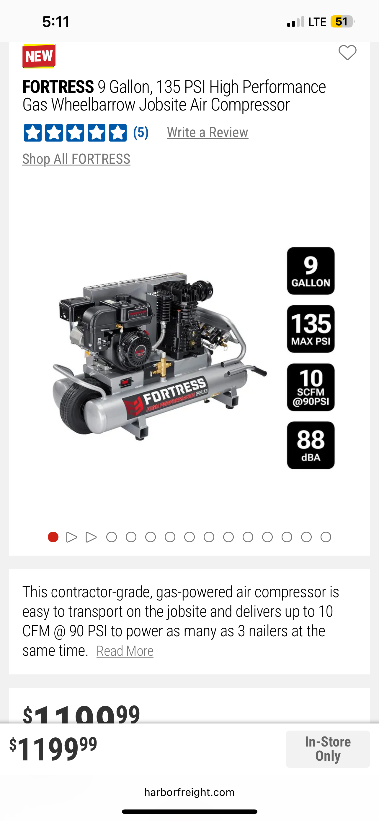

What are you doing that 20 cfm might be inadequate?
I pieced this one together twenty some years ago. Found an almost new Craftsman pressure tank where the pump had failed. Bolted on a used two stage Wayne pump, brand new Harbor Freight motor, new pressure switch, unloader valve and safety pop valve. I adjusted it conservatively to shut off at 125psi and start up at 80psi. Have used it a lot, works reasonably well, no complaints. But, I will just replace it with a new brandname unit when/if it gets tired. I drain the tank of condensation frequently.

I was going to be using it for sand blasting. A 10 cfm would work, but it would be running all the time. BTW I looked at some propane tanks, but they actually cost more then a air tank.
