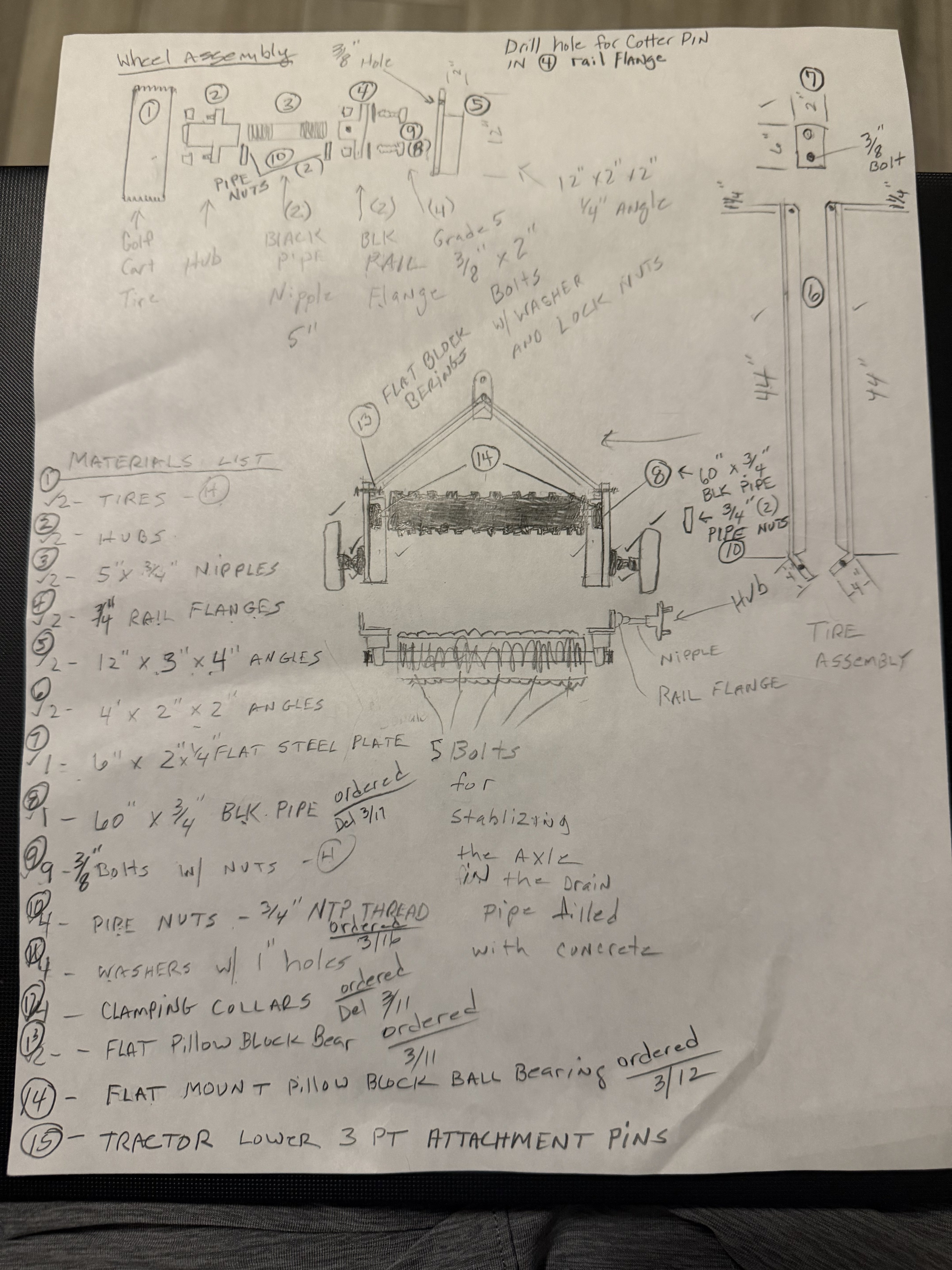

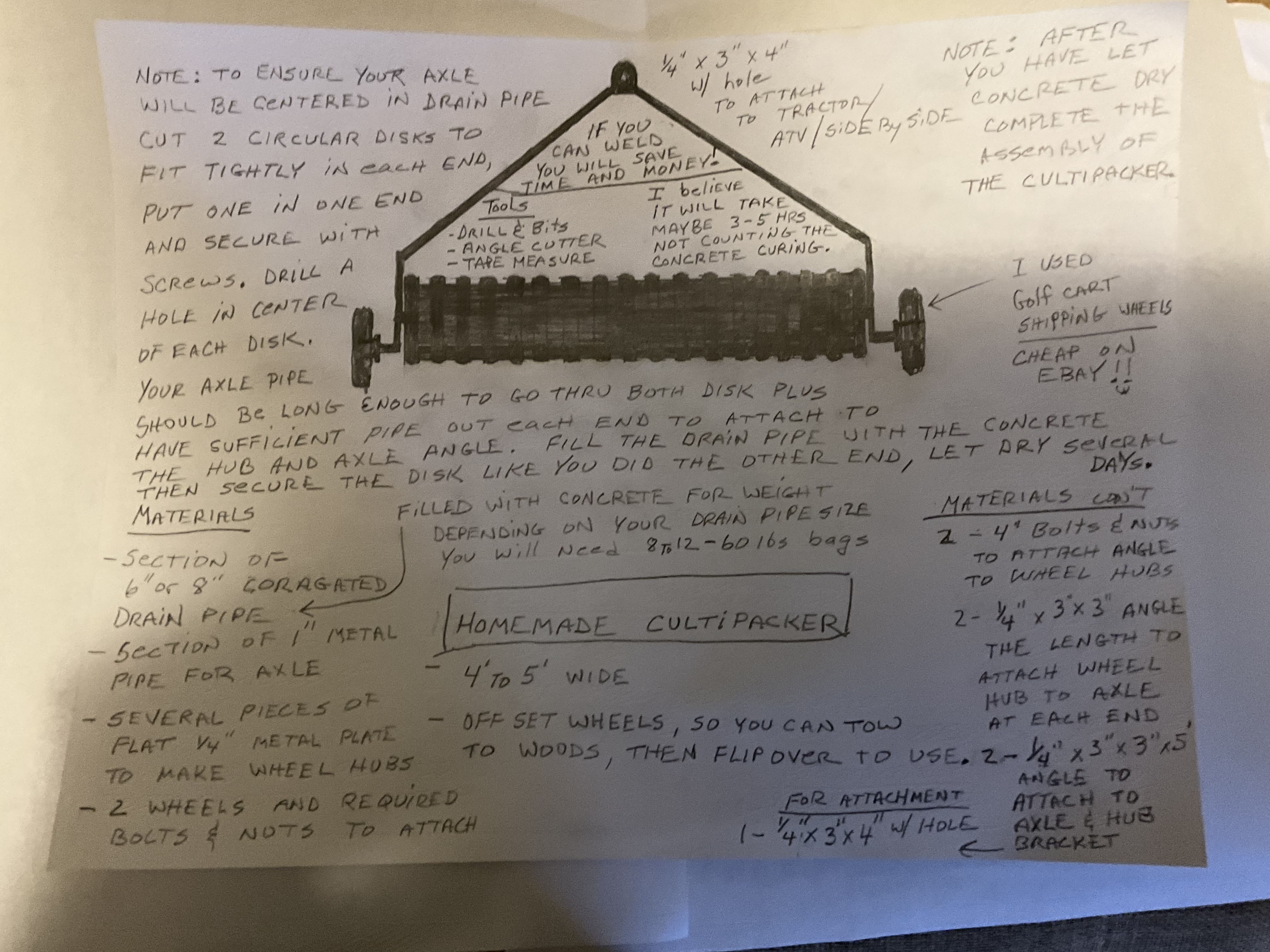

Homemade Cultipacker
I am getting ready to start another project as soon as the Woods mower is done.
Been searching for a reasonable priced one used but they are just too expensive for my budget.
So after doing some searching and researching, I decided to make one. I was able to locate a 10’
Section of 6” corrugated drain pipe for $25. I try to work on planning and purchasing parts and supplies in the evening so I can get stuff done outside during the day! I sat down last night and did a drawing for it and thought I would share it with the forum. So here’s what I am thinking of doing to make it. If anyone has suggestions or ideas that would help me make it better, please feel free to share it with the forum. Thanks in advance for your feedback.
You can also find the wheels on Facebook marketplace and if you have Craigslist in your area, you could probably find them there too. You could also modify the plans and make it a 3 point hitch for the tractor, I have seen a commercially manufactured one that was made for the 3 point hitch but felt that was just more expensive than a towable hitch.

Very interesting idea and I assume you pour the concrete vertically. Make sure you vibrate it to remove all the air you can and insert 2 or 3 pieces of rebar.
Great suggestions had thought about vibrating it but didn’t think about the rebar! I hope to get started soon but need to finish up the mower project and then I have to get all the materials together. Thanks

I don’t want to be ‘that guy’ and I think you have a good idea there.
You are making a roller, which can work very well.
A cultipacker has slightly loose rings rolling in the dirt, which slightly follow the divots in the ground and will do a bit better job putting seed in the ground.
A solid roller like you are making is better at flattening down high spots and pushing rocks in the ground.
Both can do a bit of the job of the other, but they are slightly different machines.

I'll step up and be that guy. I can't see a 10' long by 6' diameter roller with approximately 300 lbs of concrete in it being very effective at anything unless it is used in well tilled mellow soil. Even then the small diameter may not allow it to rotate. IMO. YMMV.
My 12' Brillion crowfoot packer weighs around 1,000? lbs and I wouldn't want it any lighter than that in order to accomplish anything when hooked in tandem behind a disc or digger.
I would consider rigging up some kind of scraper teeth. No reason it shouldn't work if the moisture content of the soil correct, but it some conditions it will stick the pipe and eliminate the efficiency of the ridges.
If the soil is the least bit sticky the grooves of the pipe will pack with dirt and turn into a big ball.

The concrete is ballast to make it heavier. The tube itself isn't flexible and doesn't float in the same way a cultipacker does which is what @paul is pointing out.
I don’t believe that the gravel would be any better than concrete. I think the concrete will not only provide a heavier weight but also make a more solid structure. The gravel would have a tendency to break up over time and may even cause the drain pipe to rupture. To just elaborate further on my filing of the pipe, I plan to also add some wire mesh and rebar. I would cut the mesh into strips, about 4 inches wide and just about the length my drain pipe then wire them together into a square, put 4 pieces of rebar, one at each corner, then cut 2 pieces of mesh to go from corner to corner making an X shaped across to the other corner that will also help with the axle being centered through the pipe.

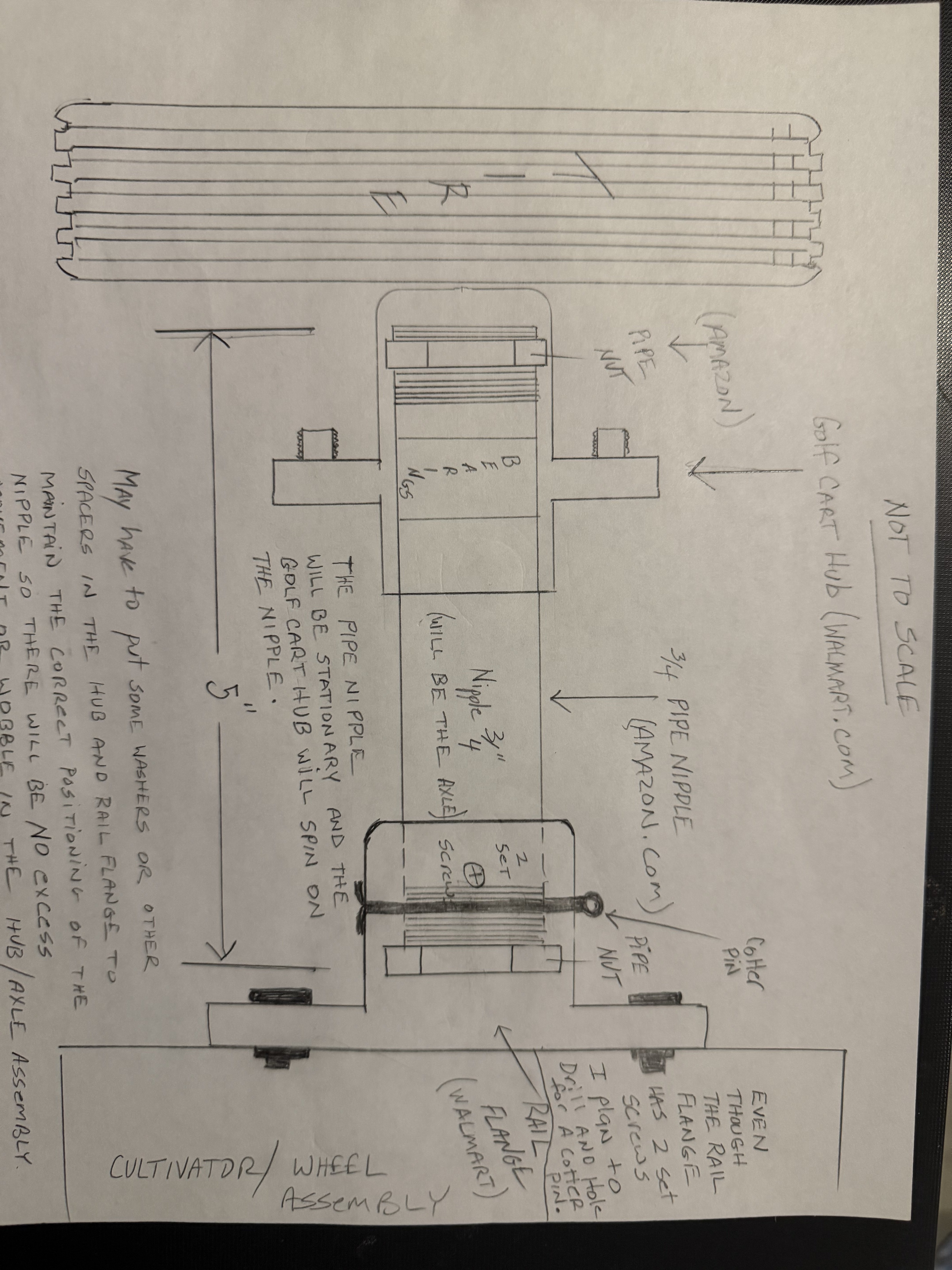

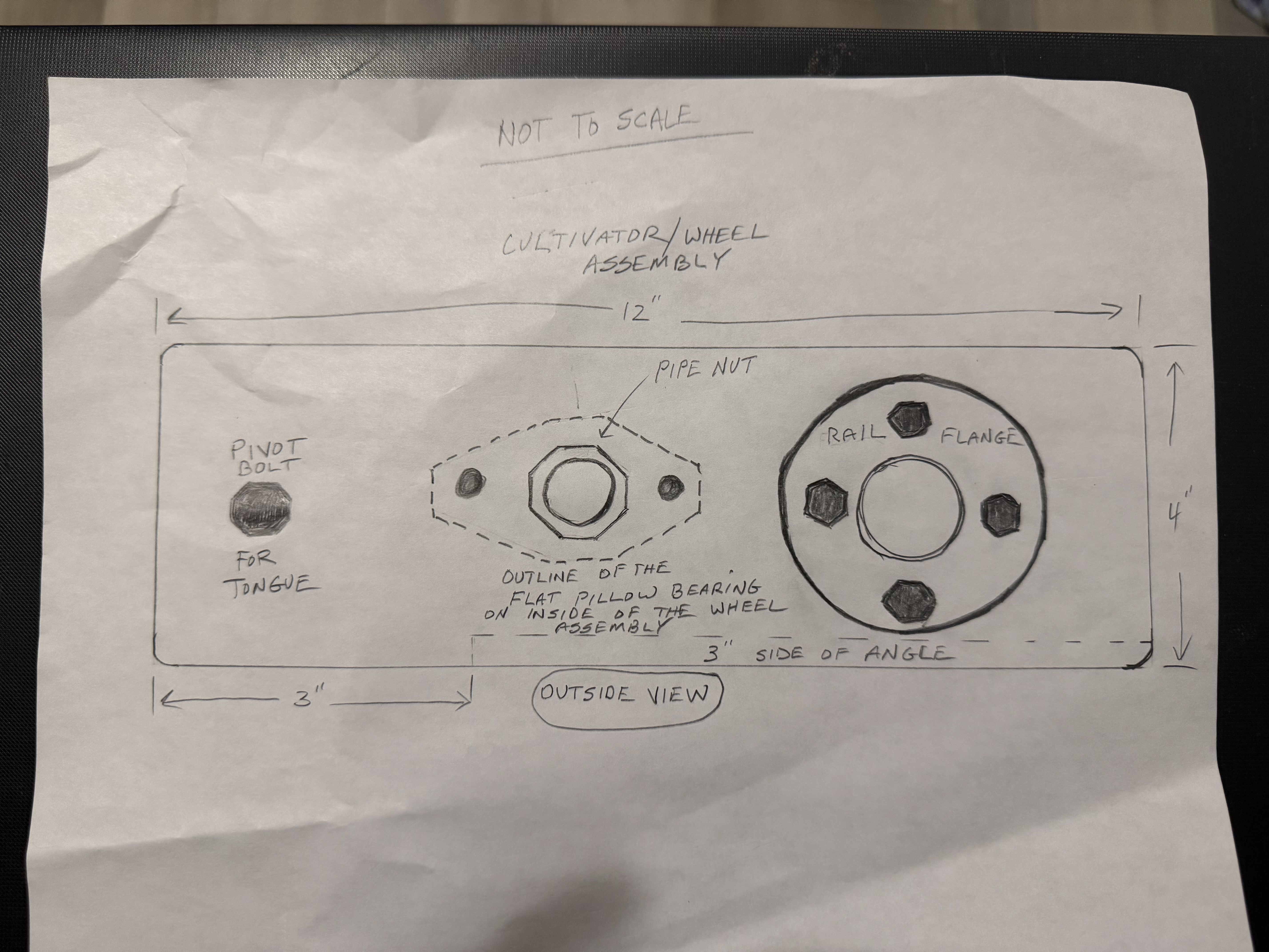

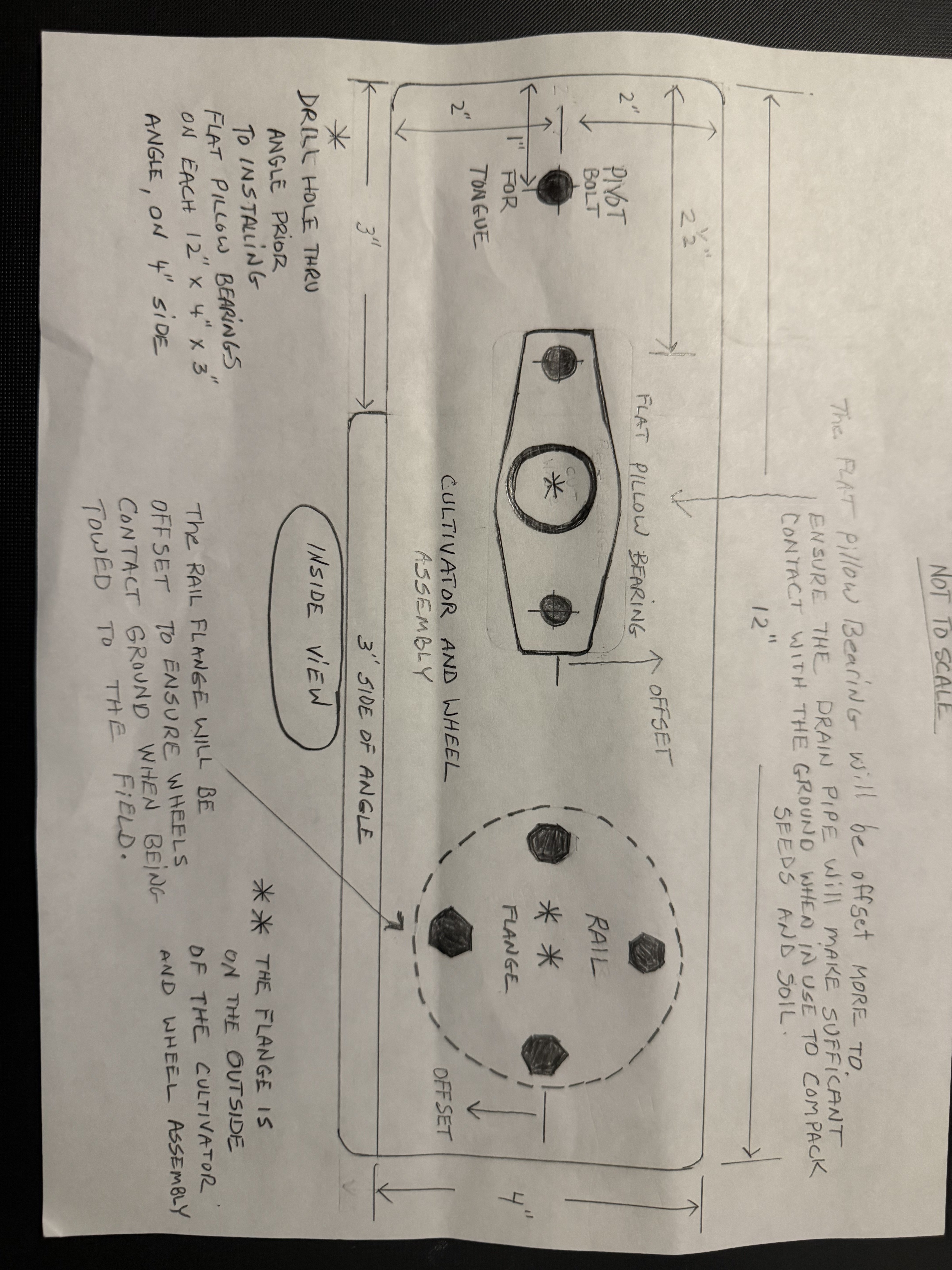

I have ordered all the parts for this project.
I am sure someone would do it different but here’s my material list and parts. I also added a drawing of how I am going to construct the wheel assembly which will have the wheels, wheel hubs, wheel axles and how I will attach to the tongue assembly. I also added the way I plan to attach the cultipacker to the tongue assembly and then the tongue assembly itself.
As I have said in my previous posts, I am ALWAYS open for discussion of ideas that can help me make my projects better. I have only a few years of college but I have had many years of training at the School of Hard Knocks. So by all means, feel free to share your thoughts and ideas about what ever you think of my project for I am always looking for a better way!
I almost forgot, so far I have $346.00 invested in my cultipacker project! Still have to purchase the concrete, and like everything else, it has gone through the roof price wise! I will probably just buy the high strength concrete, 50 lbs bags are $4.38 according to an online calculator, I would need 2 50 lbs bags, so probably I will just buy 2 bags and if I need to get more volume, I’ll just add more rocks to the mix!
