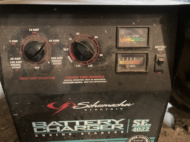

Your charger is not a smart charger.
Some smart chargers won't work on dead battery.
I would only use your charger long enough to put enough charge for a smart charger to work.
Set the timer to 15 minutes and watch the amps.
My favorite Smart charger is a DeWalt charger.
I have two, one at each property.
The DeWalt charger is also a maintainer after it reaches full charge.
It has a desulfating mode as well.
You can put it on 100 amp engine boost too.
Slow charge is better than a fast charge.
The Dewalt charger is the best smart charger I've used and controls the charge, fast in the beginning and slows down as needed.
I think your charger is almost like a jumper battery designed to give a battery a fast charge to start the vehicle or tractor.
If you were to use your charger you may what to charge it a few minutes at a time.
My brother and I many years ago used a charger like yours. It was very cold winter day and he couldn't get his car to start.
He had just put in a new battery and he ran the battery down trying to start the car.
We decided to get inside car while charger put a fast charge in the battery. A good thing we both got inside the car.
As soon as I turned the key there was Big bang, a ball of fire and the battery exploded throwing acid all over.
If were outside close to the battery we would have taken an acid bath and got pieces of battery case in our face.
Dewalt Battery Charger/Maintainer, DXAEC100, 100Amp Engine Start, 12V is by far the best charger I've owned in my lifetime.
