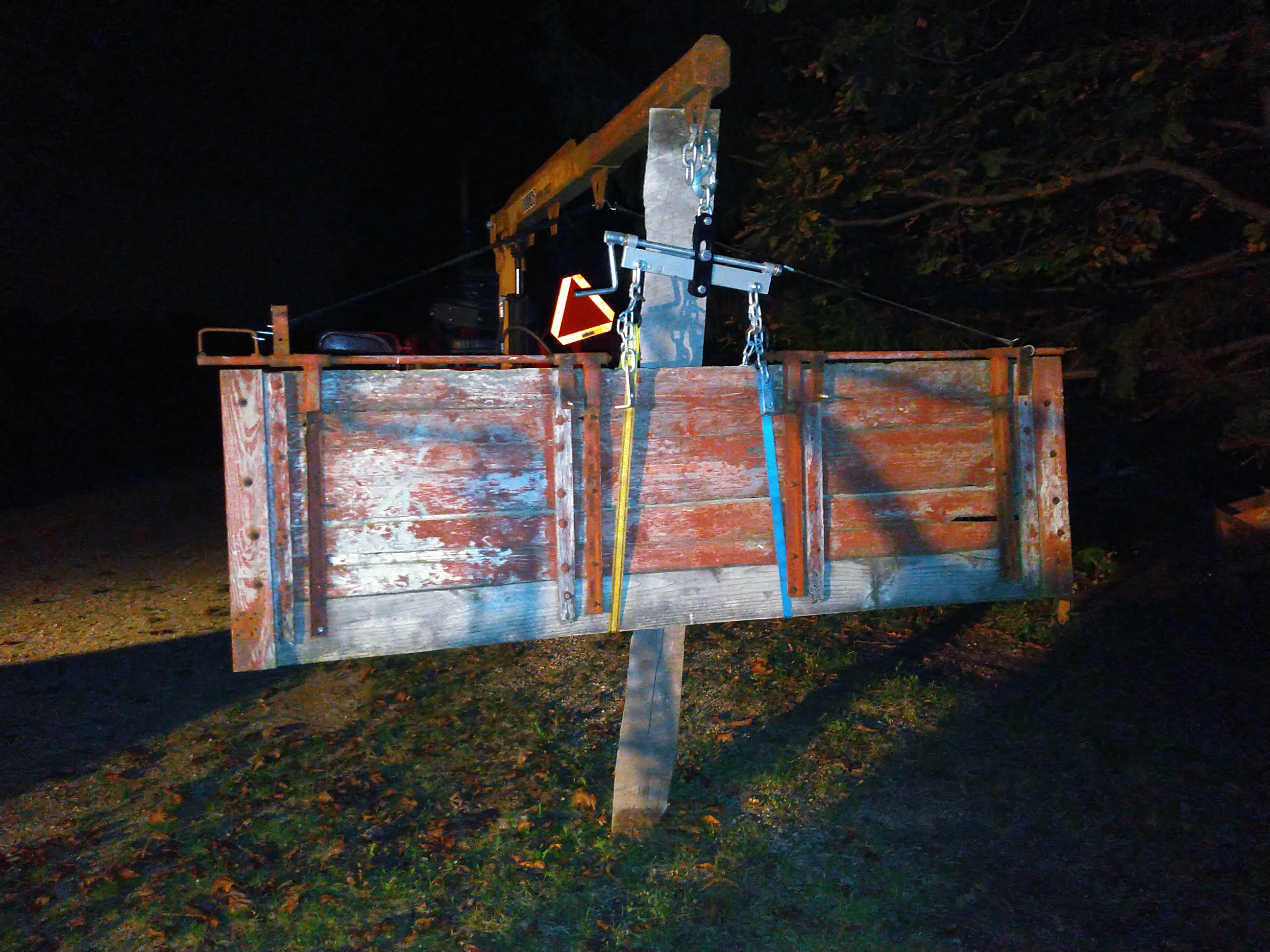

From an Farmall H?
Managed to repurpose some for a project I'm working on. Have them in place holding up a header board between two 4x4 posts & then plan on hanging a door from that on the back of my forage box.
Now, after some thought, I'm wondering if they'll hold up to this job?. This is quite a bit different than what they were meant for. In their usual line of duty, they get longitudinally stressed & not laterally. Can't say how heavy the door will be either. I'm going to be building it up with whatever's laying around here for lumber & some of it is pretty dry. Not putting too much effort into it, as I only need it to work once.

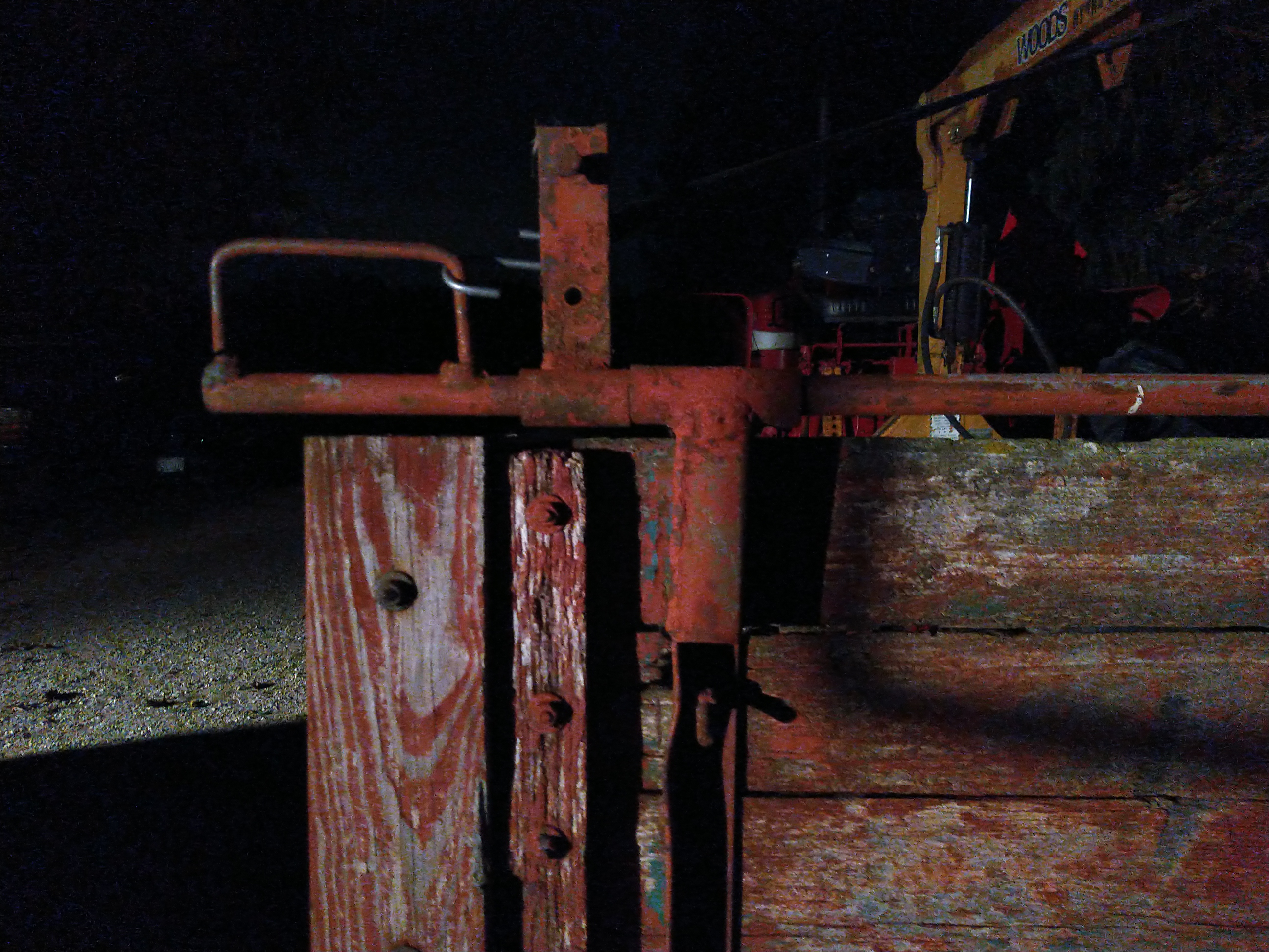

Here's the hinge detail.

Two comments:
1. Way back whenever that was built, the factory would have contracted with some supplier for the pieces their design engineers specified and not necessarily common, garden-variety dimension lumber. I'm sure you know that "4X4" was bigger in any 'before' than it is now. 2X4, 2X6, etc. 'ain't gettin' any bigger'. You'll have to "raise the bridge" (have lumber custom sawn or plane what you have) or "lower the river" (modify the braces).
2. I would be very confident using the hardware you have. Those bolts will surely hold beyond the yield strength of the wood.

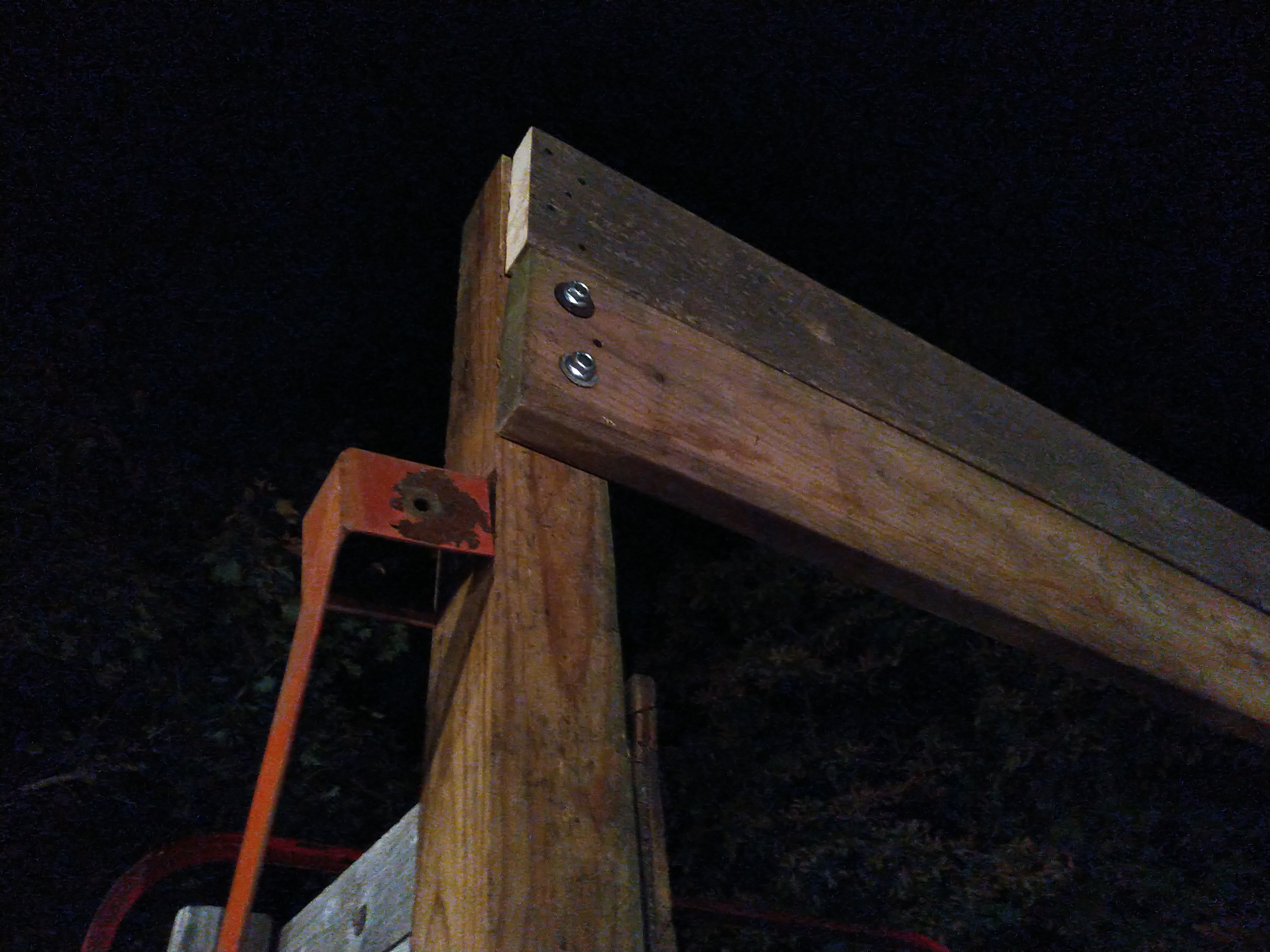

Think I'll notch those 4x4's out where the braces attach, thanks!

If you were building a desk it would be required in code to notch those so that your crosspiece is not just held up by hardware. If you really question the head studs take a 20 dollar bill to Lowes and get new.
No argument here.
The crosspiece will be notched in on the future build of this wagon*. For the moment I just need something to keep the chopped corn in from 8, 200' rows.

its not so much the strength of the bolt but more of the diameter and crushing strength of the wood---the NDS specs are pretty universally used for timber design and has tables for different diameter bolts in various wood for there allowable load
I would venture to guess, there a rule of thumb for how much crush those bolts should be providing? Should the washers remain on the surface or be flush?

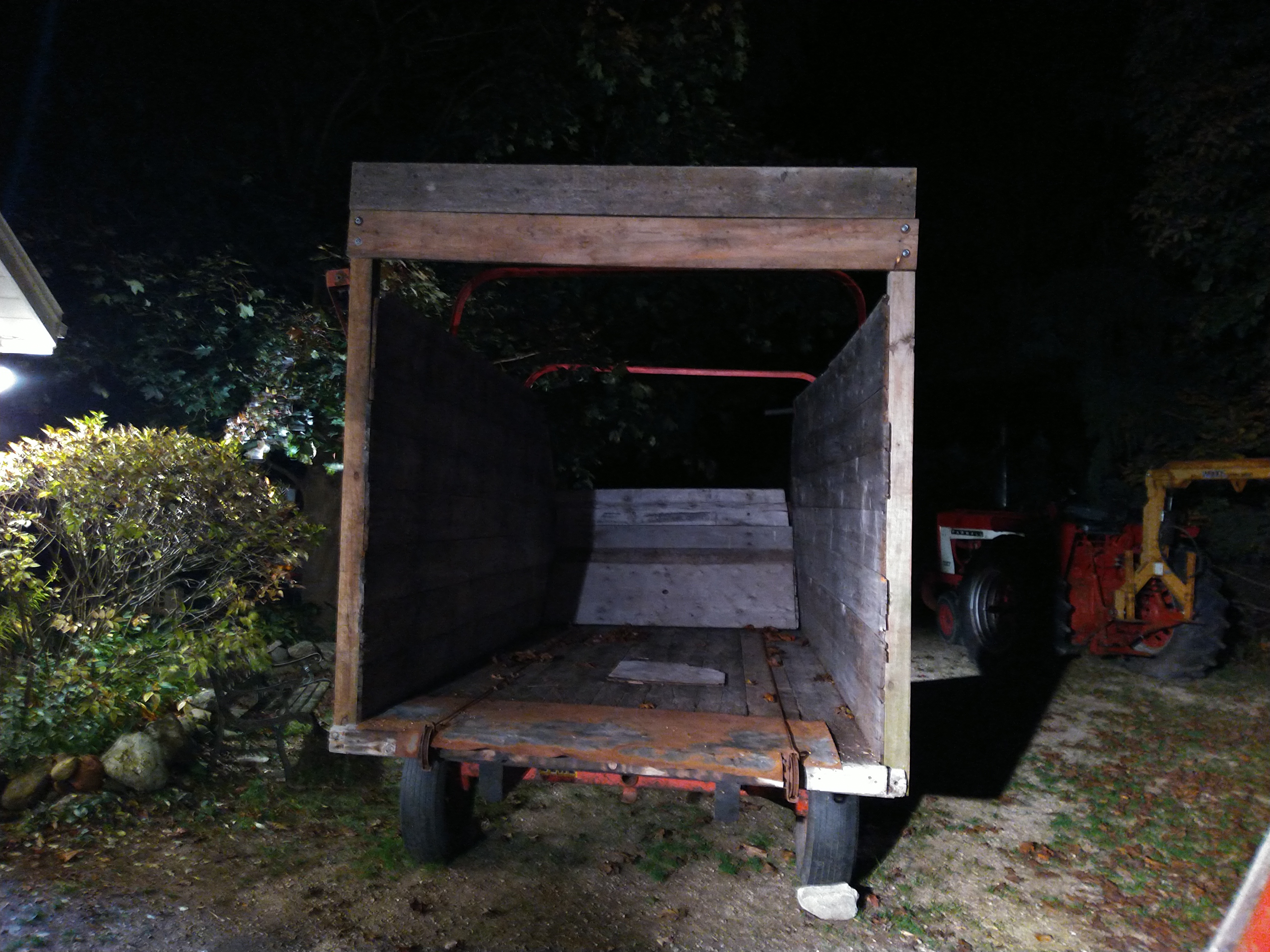

Got a bit more done on the wagon today. More pieces got roughed in. The 4x4 that was slid under the floor was a great pain. Just didn't want to go in. Was a hair too thick. Grabbed my 3lb adjuster & "finessed" it in. Tagged an extra rib onto each end & now the metal braces look like a do-able addition. Just have to notch the 4x4s & it'll be ready for the door.
I did pull it out to a flat spot on the driveway, to see how crooked everything was. Yep, it's all crooked. The front left angle iron brace, by the false front, is short & pulling everything off kilter. Might sneak a big shim in there & see if that makes a difference.
