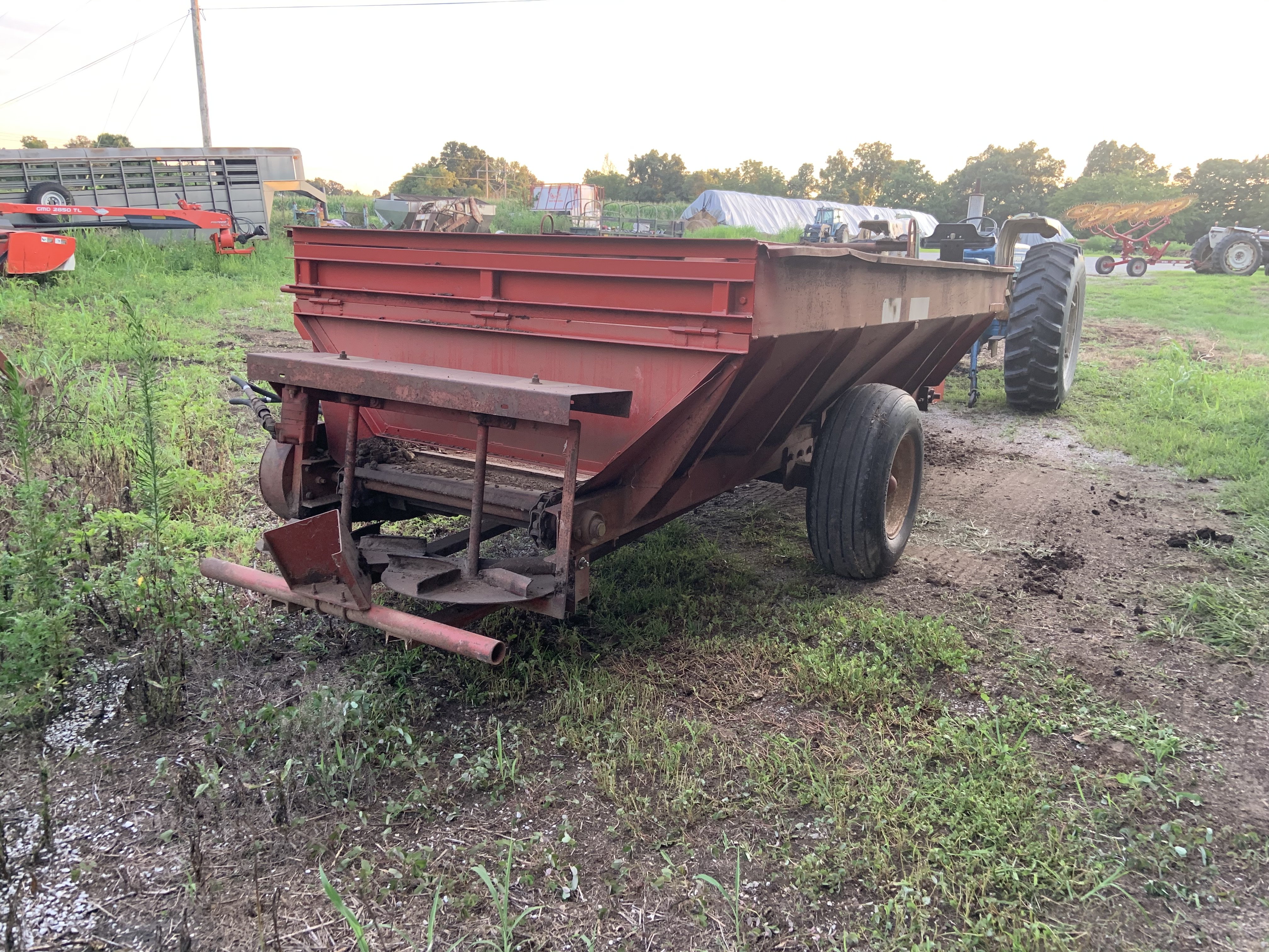

Biggest issue with spreading sawdust is it bridges up in narrow throat fertilize spreaders
Some manure spreaders can have a fine material pan added to keep the sawdust from simply dropping out the back of the spreader

For your question, I would use a manure spreader. There are several types, the typical old beater spreaders we think of. Would have to be sure the apron doesn’t ride up on the sawdust, not sure how it would act with the lighter fine dust materials. You might get a rather heavy application down the middle, and not very much spread to the wheel tracks.
There was the old tub with a shaft and chains hanging in the tub, spin the chains and they would fling the debris out. Wonder how they would do, but I don’t think any of this type have been built in decades.
Vertical beaters are the new in thing, do a very good job of distributing stuff, but very spendy.
There are the type with a few augers in it, and a fast spinning ejector in the front side that really fling the stuff out. Would think that style would work well.
A spinner fertilizer broadcast spreader would be interesting to try, but I assume there are enough bigger bits of bark and wood chips that it would cause problems, these things like really small uniform product to fling.
