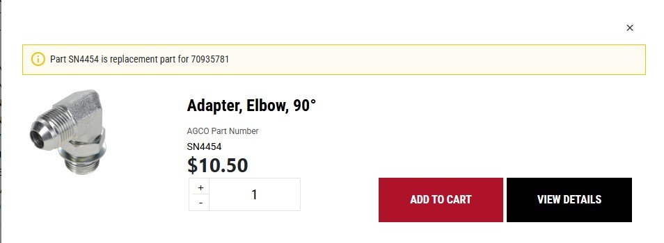

The AGCO parts book for a Farmhand 22 (was Dunham Lehr 22) shows the same swivel part number for both ends of the bucket cylinder 70935781.
Here is a link to the parts book for you.
FarmHand 2 / 22 loader parts book
And here is the replacement for that swivel now, just a male ORB to male JIC elbow. (size not given, you can figure that out from your cylinder port and hose end)

Jim.ME - I struck out on that fitting. The 70935781 came up as a New Holland number so I called my dealer. He said by dropping the last digit it came up a valid but he could no longer get it. Same story with Messick's. I'm gonna go up 25% of area (not diameter) and try that. .063" = .00311 sq.in. so + 25% = .0039 or .070".
Makes sense. Then it needs to put back on the end it came off of.
I can't say if the New Holland part is correct or not. I'm not surprized you didn't get much luck with your NH dealer or Messicks. Your Durham Lehr Loader falls under AGCO's FARMHAND brand, as I posted, not New Holland. Did you talk to an AGCO dealer? An AGCO dealer should have seen the original part number of 70935781 has been subbed to SN4454. That is the info from the parts catalog and a check for price and availability for the 70935781. That is in the picture I posted for you.
That picture shows a common male ORB to male JIC 90-degree elbow fitting. If you can figure out the thread sizes of the male O-ring Boss end in the cylinder and the male JIC end for the hose a local shop or parts store should have a matching elbow. OR just take the old one in hand so they can match the fitting ends. It may be a 3/4-16 thread both sides, if your loader has 1/2" hoses. That would use a 7/8 wrench on the hose fitting and likely the nut you tighten on the ORB side.
