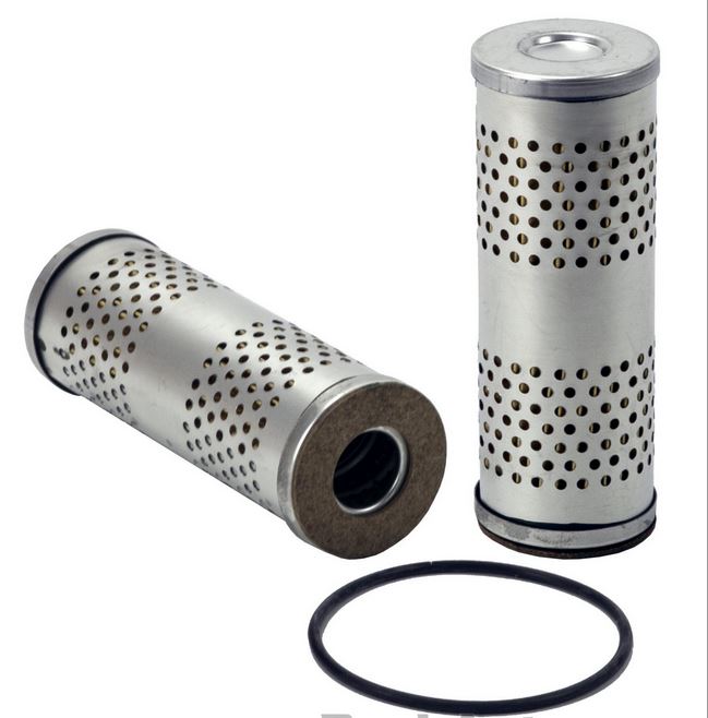

This thing has a sock style oil filter in it.......which I've never found a replacement for. I'm thinking it's the wrong filter put in there by the previous owner.
The filters I do see available are a cardboard style element with an O-ring small, and large seal. The thing is held against the small seal by a spring.
I have no spring in this assembly...........just a fat sock thingy.
Thoughts??????????? Where to get a spring, or at least a length on the spring so I can find something that fits with the proper(?) filter.
Thanks.
My NAPA filter book....from 2001..:LOL:..says it takes a NAPA 1781 or a Wix 51781. (Same thing)
I can't help you with the spring part, but do you think it looks like the correct one?
I would think AGCO or a tractor salvage yard would have the correct spring, if this filter is indeed the correct one. RockAuto shows this filter in their supply chain.
My 1550 was missing the spring. I found one that worked at a hardware store rack display. Took some depth measurements and and got one the diameter and length worked. All it needs to do is keep the gasket end of the filter against the surface. The older models had a disk and spring because both ends of the filter were open.
