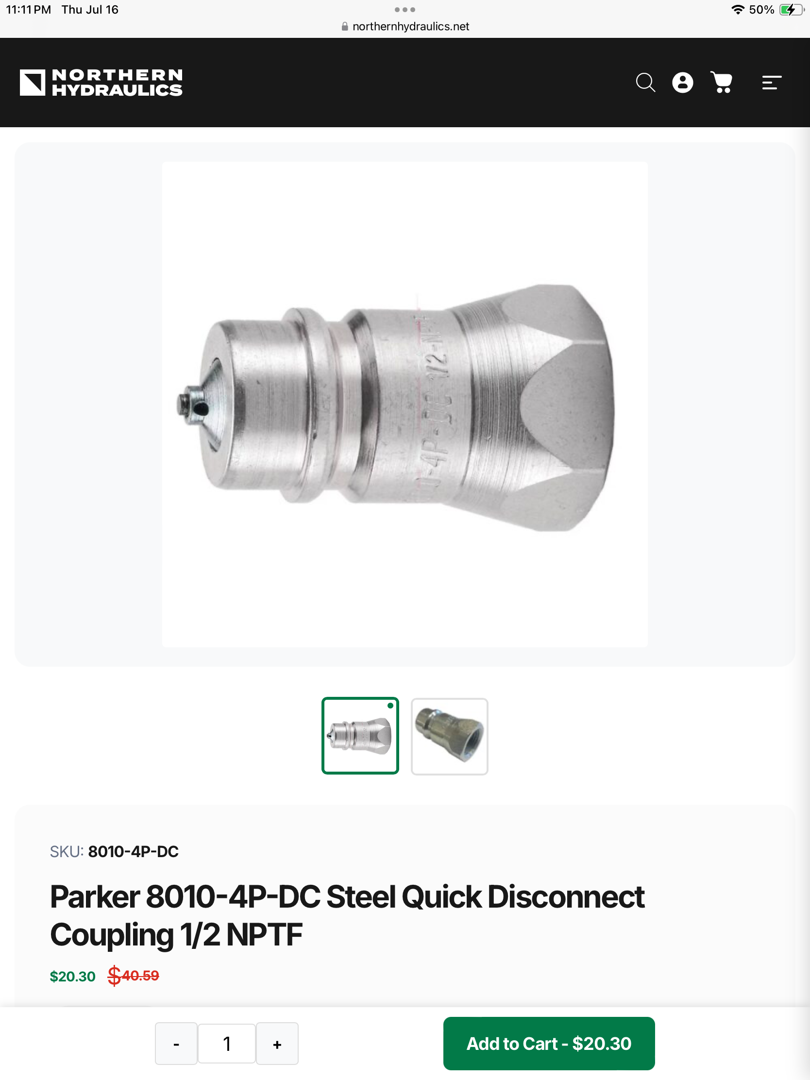

On my MF 245 tractor.the female connectors has the ball type.on .y hydraulic toplink one.it has like a nipple end one.and it don't lock together.what are the style ends called.and do the hose threads all fit connectors.

Is this top link a new attachment you have not hooked up before, or you have used it before and it just won't go together this time.
The ball type and nipple type will go together if they are the same series such as ISO. does either one have pressure behind the ball/nipple? Pressure can keep you from putting them together. Tractor turned off and the valve lever moved both directions to relieve line pressure?
You need to know what type and size the hose ends are to get the correct couplers to fit the hoses. They are not all the same. My MF 245 has ORB quick couplers to match the hose ends on the factory aux hydraulic system hoses.

The top link is new and never have used it.on the tractor it looks like the hydraulic part was added.
