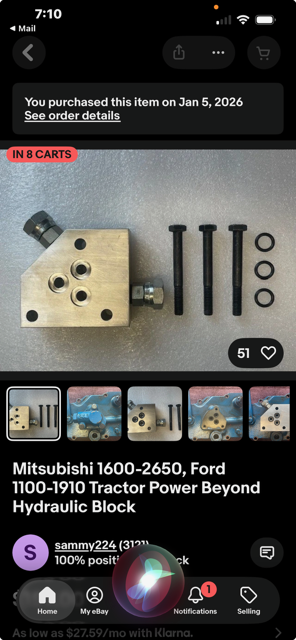

Thanks Gentlemen for the advice, however I found a Power Beyond Block that's meant to power a Backhoe. I know it'll be slow, but that's how the backhoes were attached when you bought a BH from the dealer without remotes. Parts catalog don't show it, but was a special attachment.

Why would you need or use such a block? Your tractor has one built in and all it requires is two hoses.run to the rear. Where and how does this block fit your tractor? I see three ports which presumably correspond to P, T, and N which is EXACTLY what you already have.

Ford used a hydraulic block mounted between the relief valve and lift cover when installing a loader on 1100 to 1900 tractors. The 3 ports are pressure in and pressure out and the 3rd port is return to sump when the relief valve opens. There is only to hose connections so it is not actually a power beyond block.

Thanks Mark but lets not get hung...Can you even mount that block on a 1710? TOH
The part number for the relief valve is the same so it should fit. As you know that type setup creates back pressure in the hydraulic system which is why they went to the loader valve with power beyond.

The parts site says that it fits the xx00 models of the compact tractors, but not the xx10 models.
Probably because its not needed or used on the xx10 models which have a built in diverter.
I am with Mark -Its nothing but a diverter plate. If the relief valve cover is the same the ports and bolt holes will line up and it should work on a 1710. Why you would chose to purchase and use it escapes me. For the cost of that plate you could put two rear remote valves on the tractor and actually gain something.
