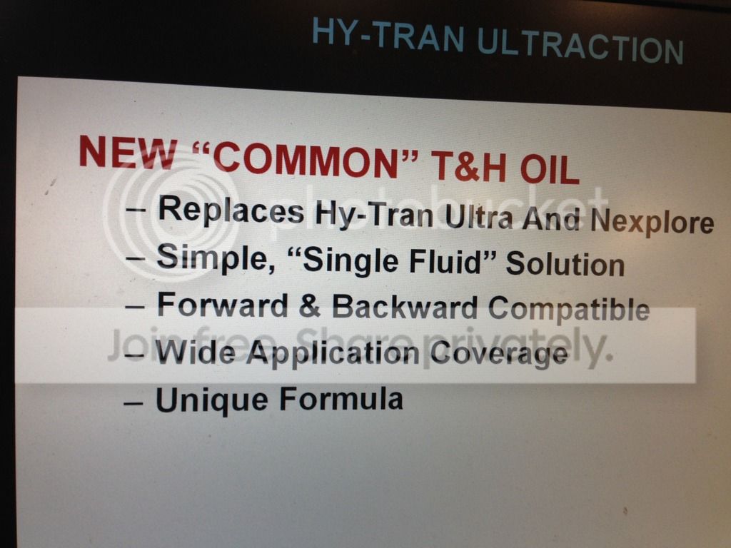

CNH just introducted the new Ultraction family of hydraulic oils:
Their new Mastertran Ultraction is now recommended for use in all applications that previously used MasterTran and/or Multi-G 134. Mastertran Ultraction is made by Viscosity Oil - the same folks that made the older products:
[u:3847410497]Mastertran Ultraction[/u:3847410497]
Their new HyTran Ultraction is now recommended for all HyTran Ultra and and most but not all Nexplore applications. Hytran Ultraction is made by Akcella - the same folks that made the older Hytarn products:
[u:3847410497]HyTran Ultraction[/u:3847410497]
The images below are from a CNH presentaion on the new oils - take careful note of the compatability warnings....
TOH
