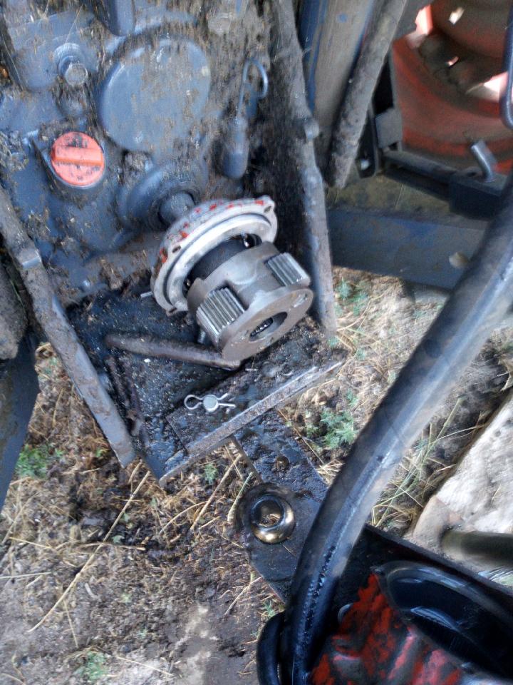

I thought about taking some pix, right after I drained it and tore it apart - so we shall see how that move turns out...
Here is what I now have after my last attempt.
Any thoughts are appreciated.
Thanks!

Thank you so much for this tip! This worked and finally have that pto unstuck. Hopefully can now find some replacement parts.
