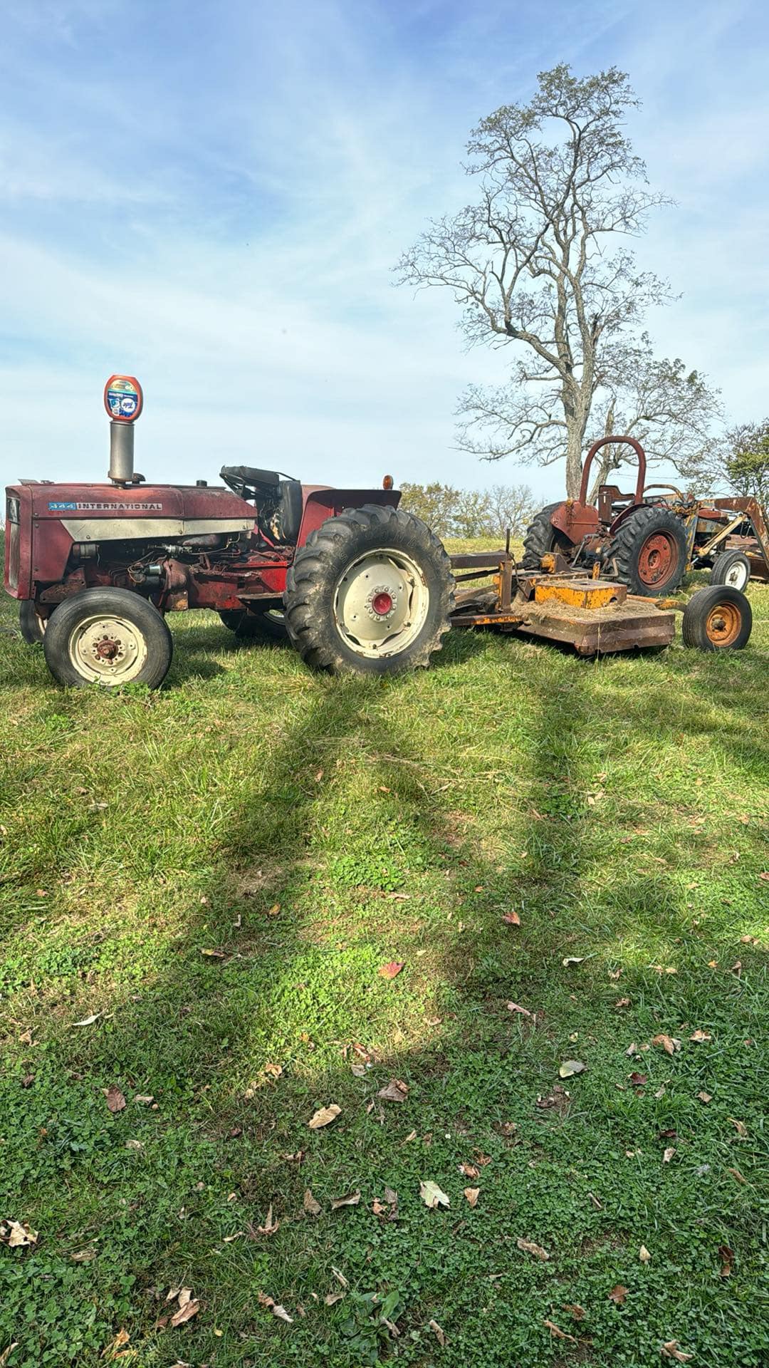

On my IH 444 when bush hogging I have to keep my foot on the pto lever, if not it will kick back out. I did this while cutting 4 acres, when I was almost done the pto kept stopping on me, I could push the clutch in and let it back out and the pto would take off again, any ideal what could be wrong?

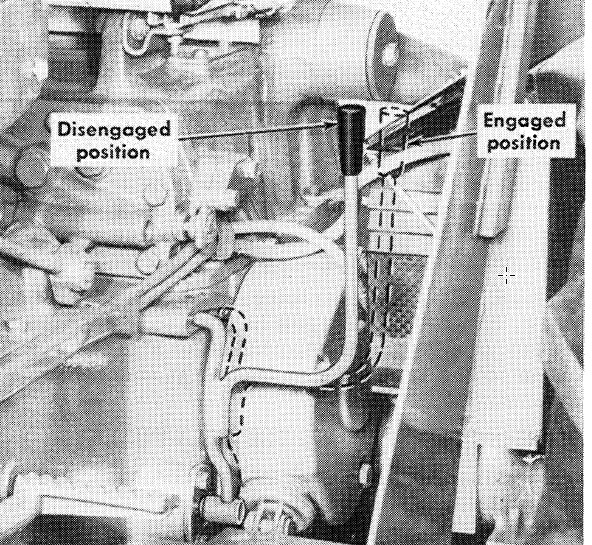

from my owners manual this is what our 444 should have. I didn't relize that little elbow sticking off the side went into a detent. I wonder how much stain that puts on things bending the lever to move/bend it out to go between the detents for engaged/disengaged. Also looks like (has been broke since i got it so I'm just guessing) my disengaged position is way more forward travel than what this picture shows for the forward disengaged position. anyone have a picture of their tractor with this style ever on it?

Lever is a sort of "spring steel" and bends and springs back, no issue there. I don't think.
It would appear that your 444 is a crate unit(power train only) build at the IH Bradford, UK plant and then final assembly in the IH plant in Louisville, KY, USA where they used US built parts to do the final assembly. The US parts were not a replica of the IH UK parts but parts that were common to the IH 404/504 tractors made in the US. Some parts like the Delco electric system were a big improvement, other parts were equivalent and other parts were not as good as the IH UK part and the PTO lever was one of them.
See below of a photo of the PTO lever on an IH UK made tractor.
History of the PTO lever on the Grandfather of these IH Bradford, UK built tractors was the B250, B275 and B414. The drum brakes on these tractors were barely adequate to stop the tractor with a heavy load behind, on the next revision IH increased the size of the brake drums and now the brake drum interfered with the existing PTO lever so the lever had to be redesigned with a curve in to go around the larger brake drum and still lock into the "Engage" hole in the diff casting. The IH Louisville assembled tractors had a problem with Operators forcing the IH, US PTO lever and either bending it so it no longer Engaged the PTO properly or breaking the lever.

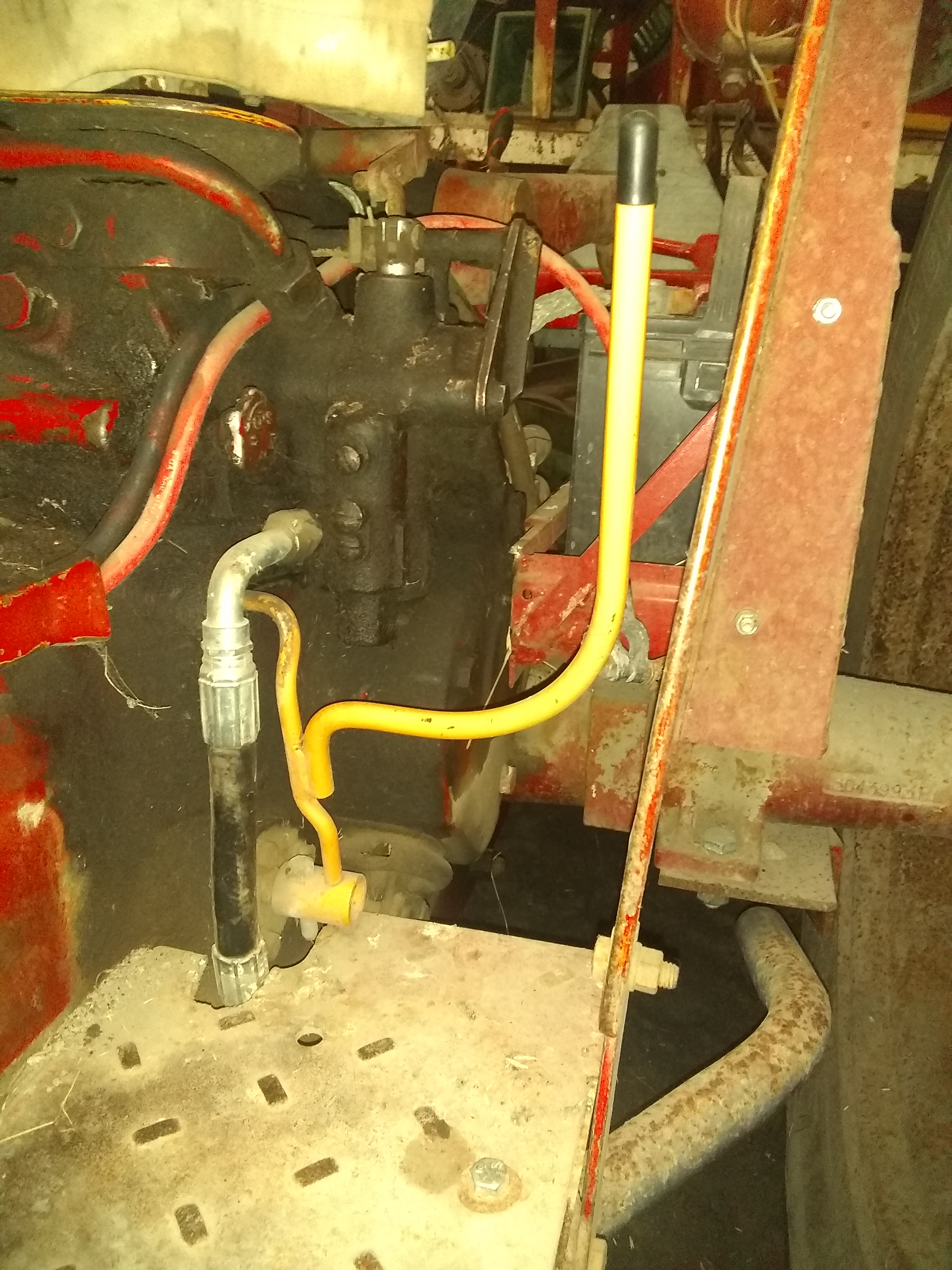

Here' s the replacement lever on my "424", I got it from the CIH dealer probably 20-some years ago, it was in a Mahindra bag with a CIH part # sticker over the Mahindra part number.
