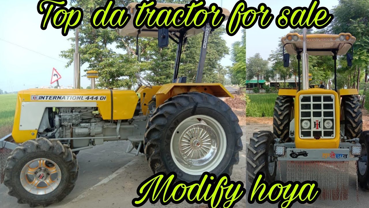

Bonus UK 444 pic (as found on the 'net), just for grins:
