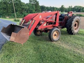

Thank you for your reply. With the swept back front axle, could 1000- 1200 lbs be too much that it will take too much weight off the front causing steering issues? I attached a 574 pic. Thank you.
Thank you for your reply. With the swept back front axle, could 1000- 1200 lbs be too much that it will take too much weight off the front causing steering issues? I attached a 574 pic. Thank you.View attachment 81530
I would start with about 1000 lbs. If you put a 750 lb. bush hog on back it would act like 1000 lb. due to the center of its weight being further back than a box of 1000 lbs. I have a 2 ft x 2ft x 3ft. one that is about 1800 lbs. You don't need a big block as 150 lb. per cubic foot is an approximate weight for estimating a size to build.
Not even close. 1000lbs won't even balance it out. Remember your grade school physics lessons with the fat kid and the skinny kid on the teeter-totter. The tractor is the teeter-totter and the rear axle is the balance point because that's where your traction is.
You put 1000lbs way out front, and 1000lbs up close to the rear axle, it's not going to balance out. 1000lbs will help, but you would probably want 2000lbs back there to really balance it out with a load in the bucket. But you also have to consider practicality. With the bucket empty you really don't need that 2000lbs back there so you find a kind of middle ground.
