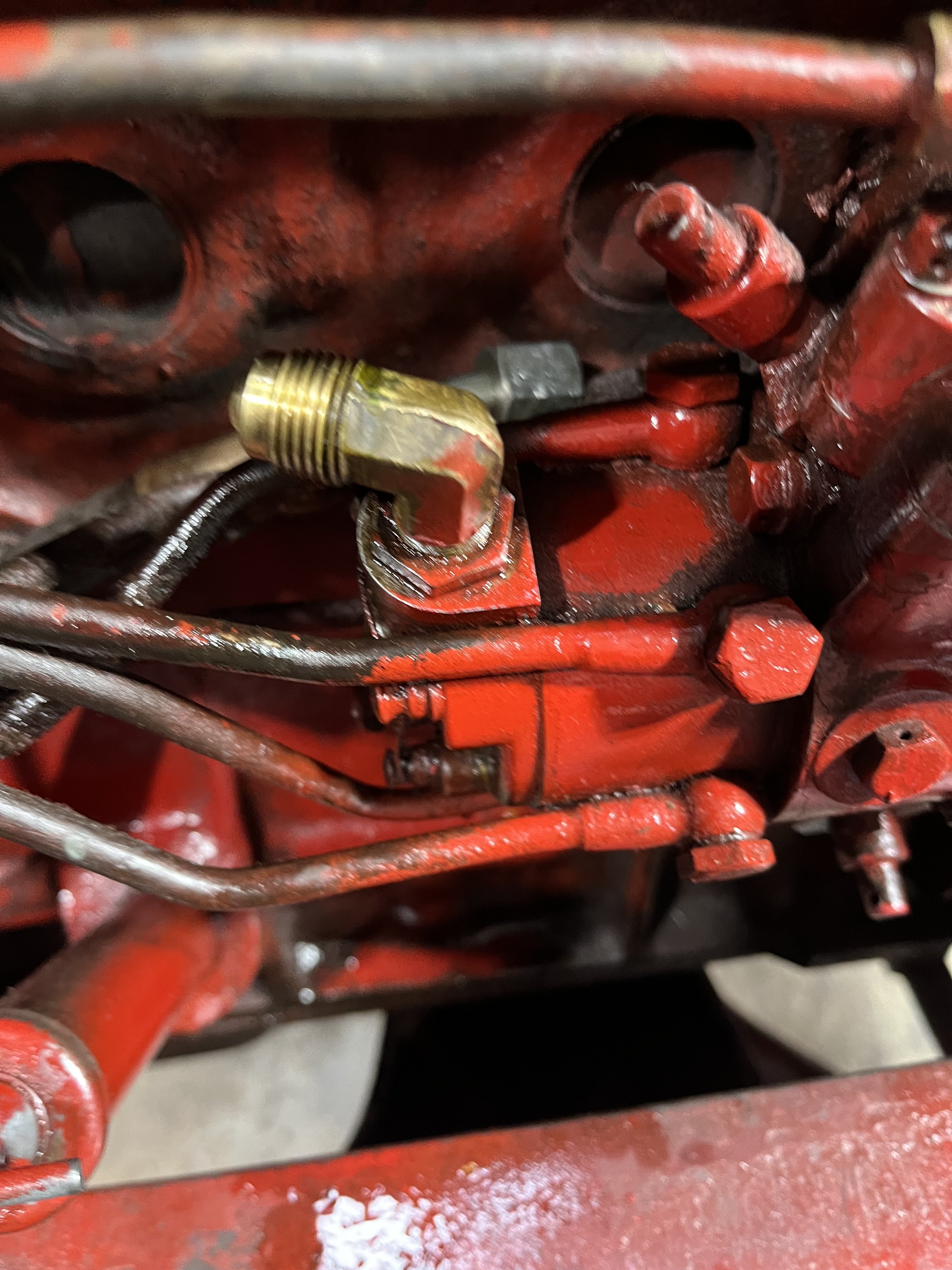

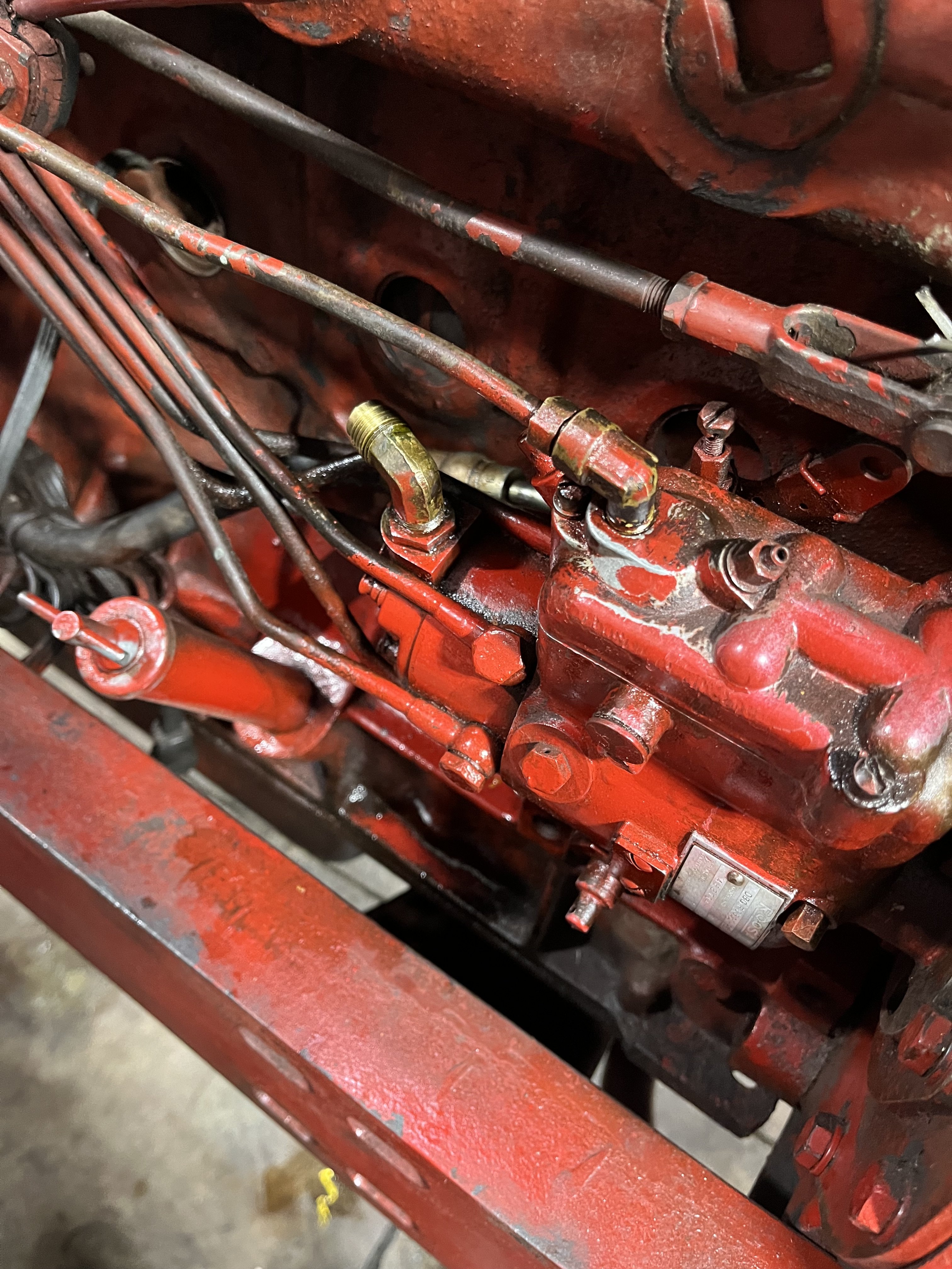

Hi guys the main fuel line elbow that goes into the injection pump is leaking and the elbow is shot, is there anything below that elbow like a ball and spring or something or can I just replace it this is on a Rossa master injection pump.
Use TWO wrenches, one on the elbow fitting and one on the 3/4 hex to hold it while removing the fitting. DO NOT remove the 3/4 steel hex fitting, that's the transfer pressure regulator assembly and some parts MIGHT be lost if it's removed.
