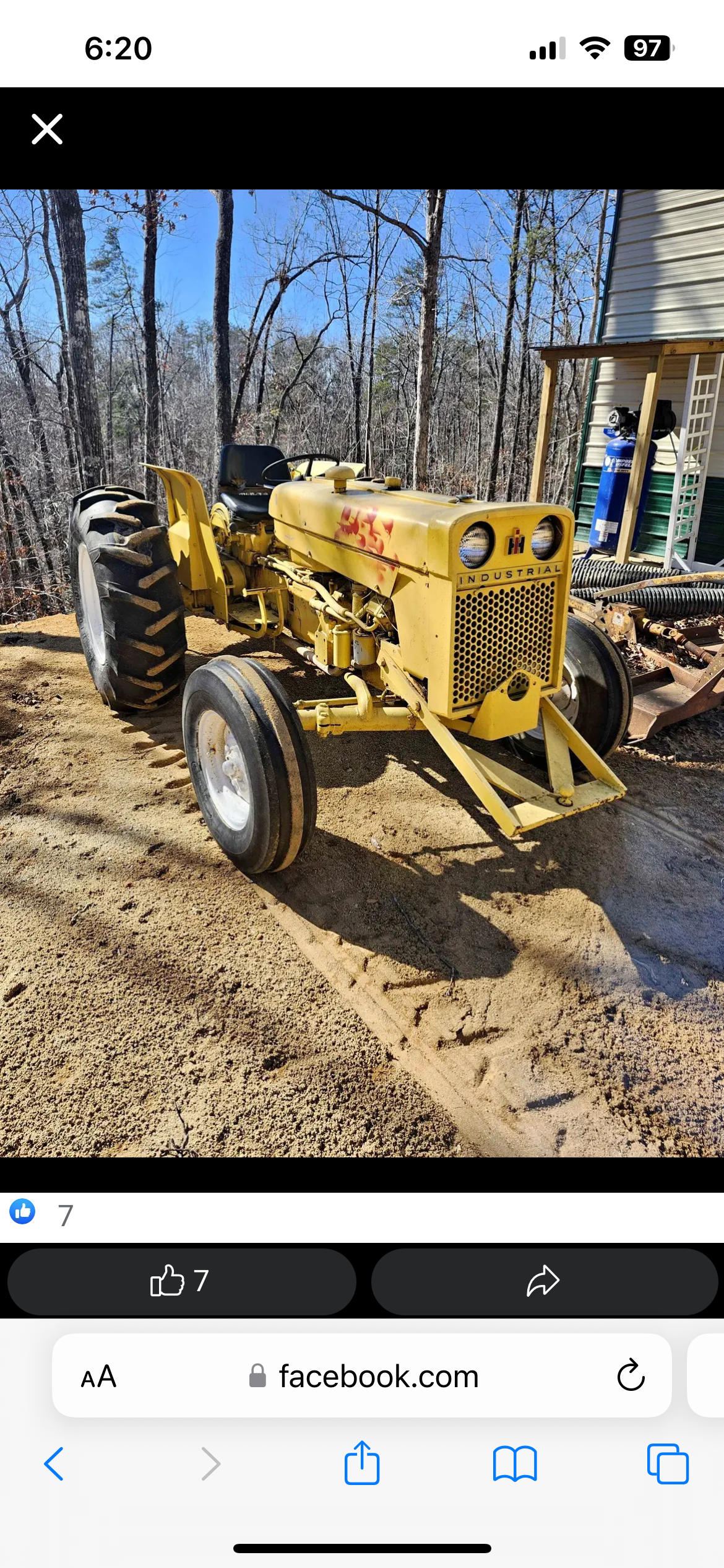

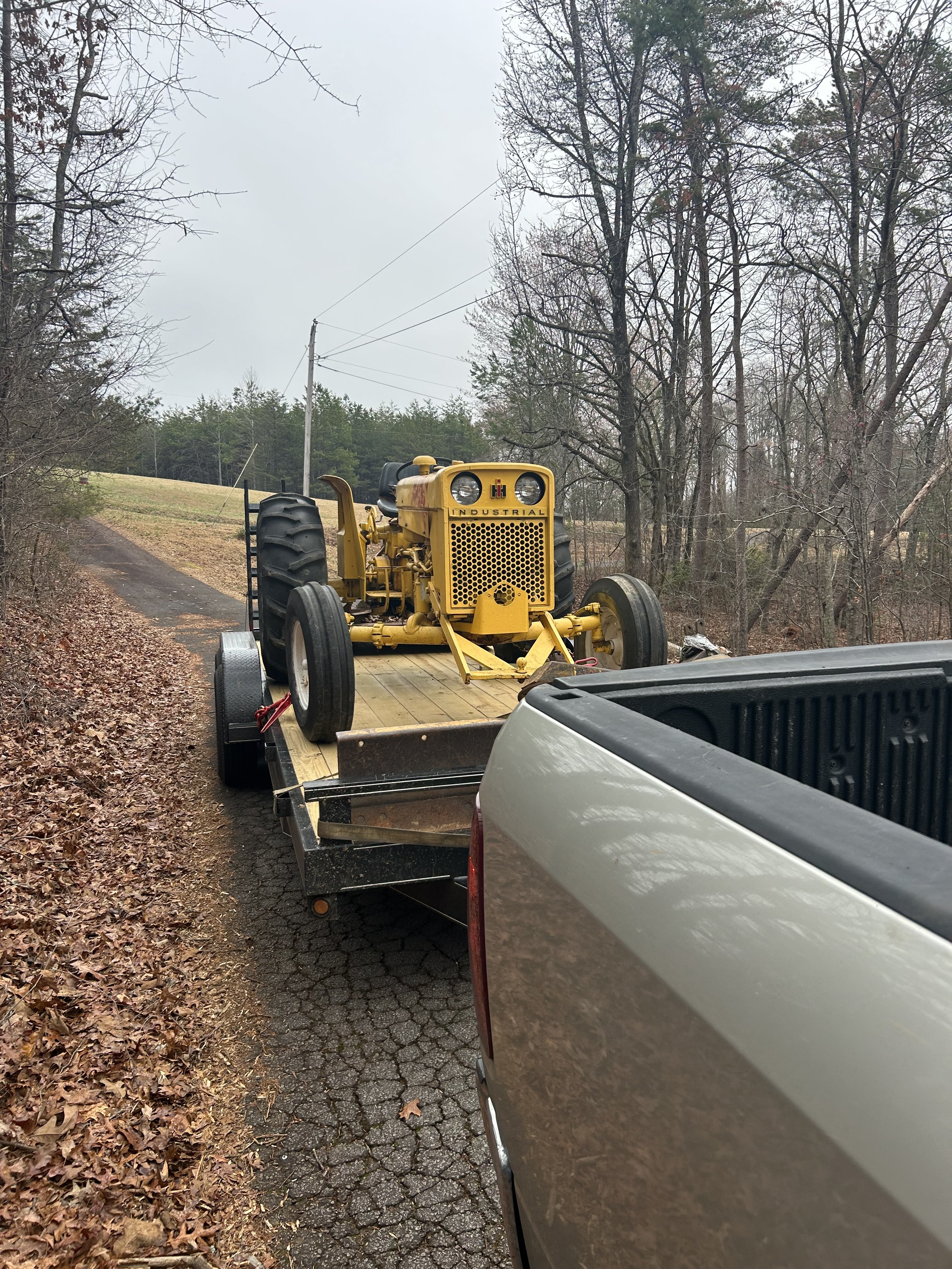

Hello newbie here in Georgia. Thanks for the invite to this forum. So I have been restoring the IH Cub Cadets for 20 years now and thought I would add this tractor pictured to the collection. This one has very low hours 0962 and runs like a champ. The manufacturer tag is still there but the only thing that I can read is the serial number which is 02858-D. I’m trying to figure out the model number for this one. I ran the block casting number and it is the BD154. I have a Cub 70 which is a 1967 model and the headlight panel looks very similar. I started to research the grill pattern and everyone I see comes back to one that has the clam shell fenders whereas this one has the square type fenders. I thought I had it down to the IH 2504 which looks just like it but the fenders are not the same. Anyway just thought I’d ask someone here to see if there is a way to identify this one. Thanks in advance!

Looks like a 2424 or a 2444. Both shared the same diesel engine.
Judging by the bracket on the front, behind the home made hitch, it had a loader at one point. That would have most likely been a model 2050.

It's an IH 2444 - the sheet metal and fenders line up with a 2444. Your tractor was made in 1968.
Basically the industrial version of a 444.
