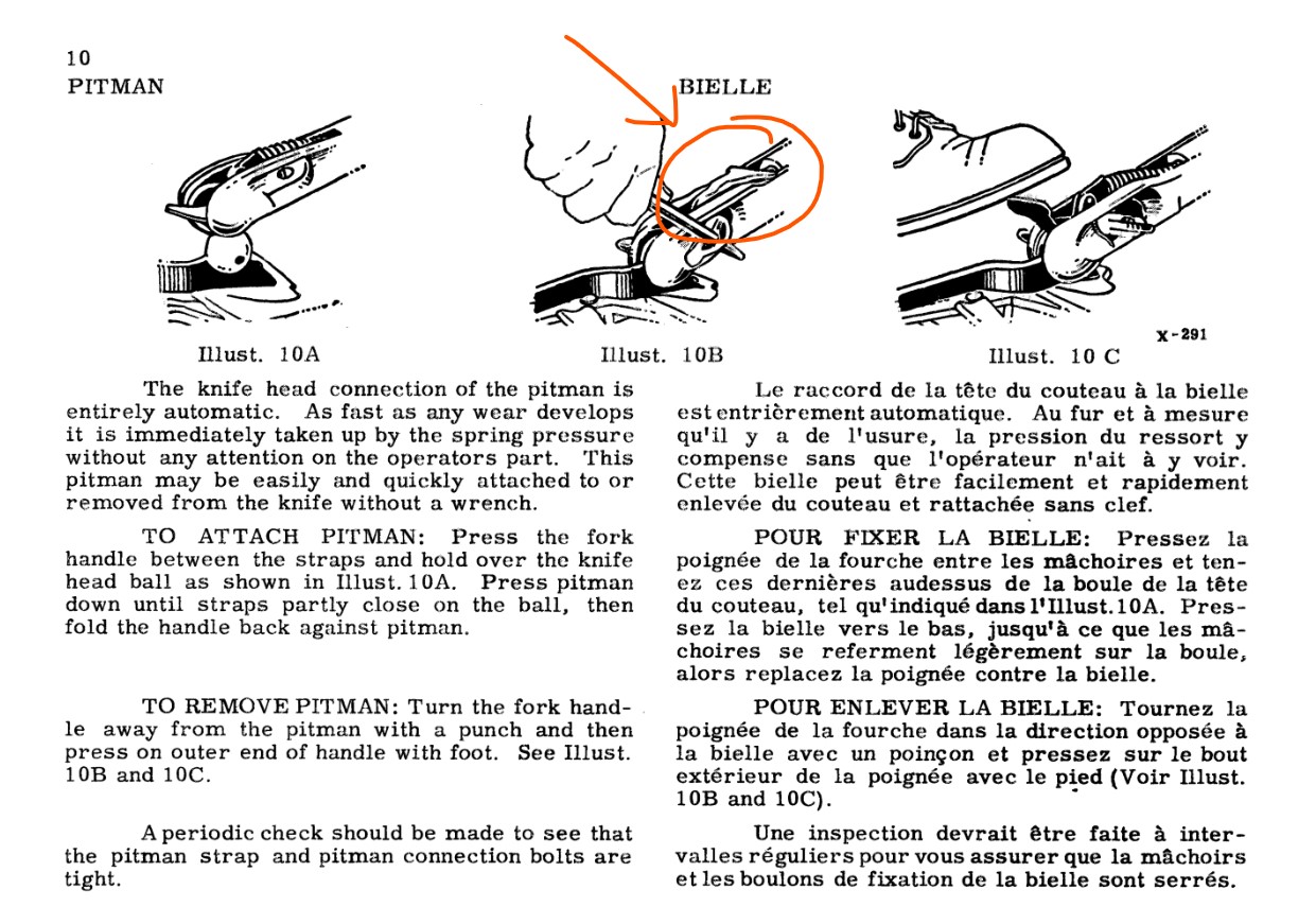

Hello, I have an IH McCormick pull behind sickle mower. For the most part a good machine. I do have an issue lately though, of breaking pitman boards. I had to order new pitman straps, plunger lever and spring. When assmebling, the spring that goes into pitman end then into the plunger is so tight when trying to close the plunger I've had to use a tie down strap to pull and eventually snap into place. It lasted one row before the pitman board broke. I had to order a new spring and board, the other parts I found in the grass. Does anyone have suggestions on why the spring is so tight that there's no spring left when trying to tighten? I believe the straps are correct as the holes match up with the old ones. The plunger is the same as well. Any help would be appreciated.

Hello, and thank you for the reply. Many great tips. Regarding the knife portion, yes it does slide easily back and forth. I bought the sickle knife piece from an IH dealer. You mentioned is the sickle registered correctly. I'm not sure what that means. An explanation would be appreciated. As far as the knife head, I'll have to check to see if it is an IH-McCormick. The unit ran fine for a couple of years with out any issues. But I'll double check stock number MA999. My Hobby Farm is located about an hour from where I live. Thanks for the drawing. I've included a picture of that assembly. I measured the hole with from you drawing which is 1 5/16". That checks out. When I was at the CaseIH dealer, I ordered another pitman. When they looked it up they ordered the correct one. I had to order another spring, as mine went flying in the grass. I should go look for it, as the new one is $44. Wow! I'll check the slop on the bearing. As I mentioned, it had been running great. I know I have a few knives that should be replaced. I'll work on that as well. I'll check the depth of the spring hole in the pitman. I'm picking it up tomorrow.

Question, when snapping down the fork, should the handle of the fork rest on top of the pitman? Earlier you said (i think) the top of the fork handle shouldn't rest against the end of the pitman.
It should rest against the pitman jaws. It's been a few years since I had both a newer knife and newer jaws on any of mine: Perhaps it being so tight on yours is just a case of everything being so new/tight.
The geometry of the fork is such that when it's clamped down all the way and resting on the jaws, the spring is pushing 'over centre' and working to keep the latch down and in-place. But it only has to be lifted a small amount before the spring's gone 'over-centre' the other way and working to push it open.
Thus: If it isn't latched down all the way, it will probably not be 'over centre' correctly and may spring up during cutting. Which could be part of your problem. This is inherent to the IH/McCormick design- carrying over from the days of the McCormick horse mowers. The 'idea' is that if the knife encounters an obstruction too tough to cut through, the jaws will be forced open enough to push the latch open and unlatch, saving the knife from damage (and only causing damage to the pitman, which is cheaply/easily made and replaced). I can't say that I've ever seen it actually work too successfully, but that's the theory.
I'll send pictures later on during the weekend.
Sounds good. I see where the confusion came from in my fist post. Yes, the latch should rest on the pitman. When I said in my first post that 'the fork will be too close to the pitman if the jaws are wrong', I meant that the socket of the pitman will be too close to the end of the pitman - i.e. the mount holes on the jaws are closer to the socket - compressing the spring too much even in its open position.
