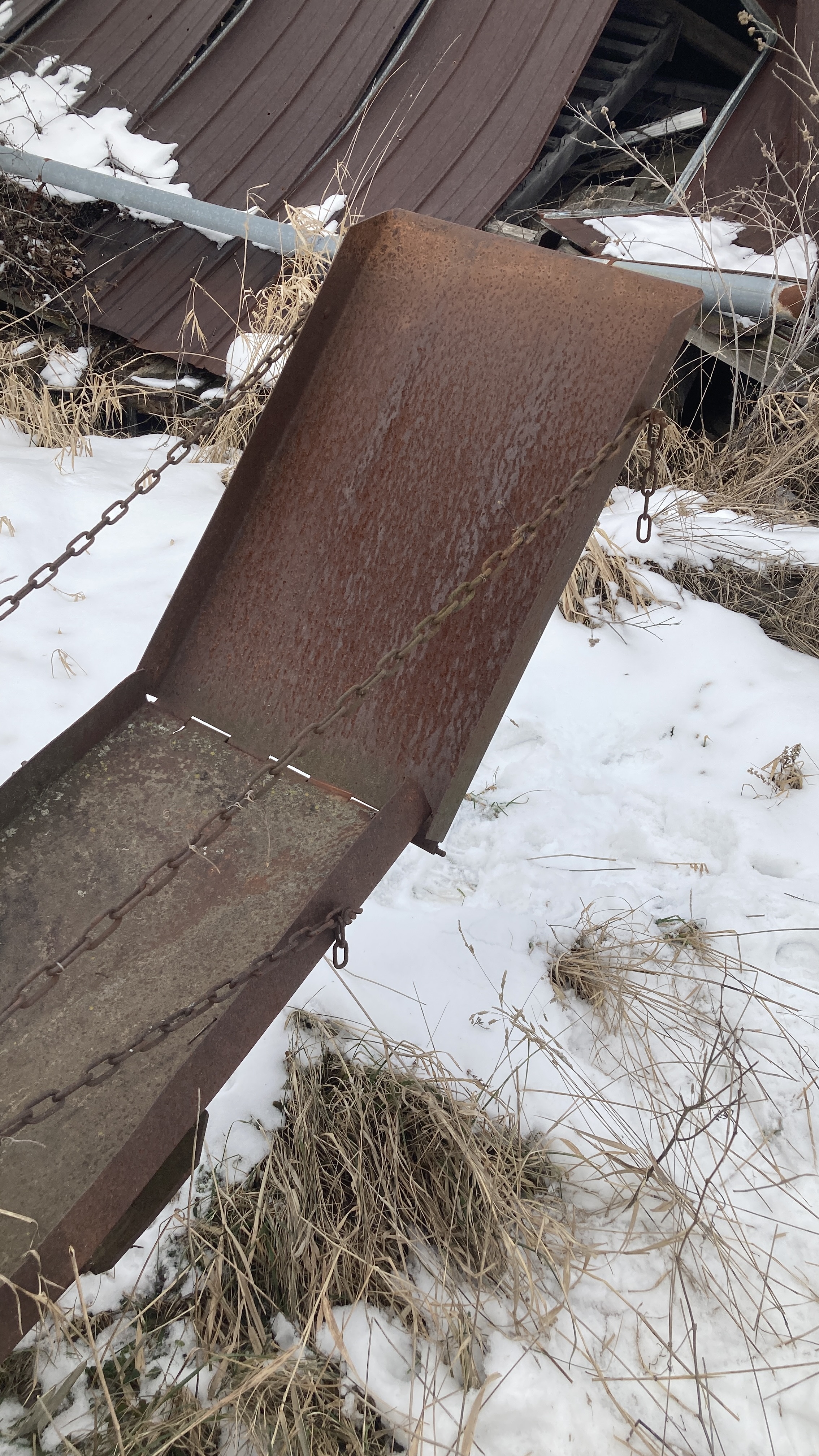

First off I know everyone hated these balers but I found it on auction for less than 100 bucks so I couldn’t pass on it and have enjoyed tinkering on it as I only bale a acre of hay so it works for me. Anyways when I bought it the bale chute was bent all to heck and I don’t think it was the right size to begin with. Does anyone on here have a 45 baler that could send me a couple pictures and dimensions of the bale chute. Also if anyone has gotten one running well and has any tips and tricks it would be much appreciated. Thanks,

Since 14” x 18” bales are common throughout the IH baler line just about any baler they made would likely have a very similar bale chute configuration. If you were somewhere around NE KS I could probably give you the chute parts of a 47, they have had some welding done on them. If you’re not an “old cermudgen” that thinks the government and the major part of the population are aiming to seek you out steal all your stuff and make your existence miserable then add your location to your profile. It can be helpful in many situations.

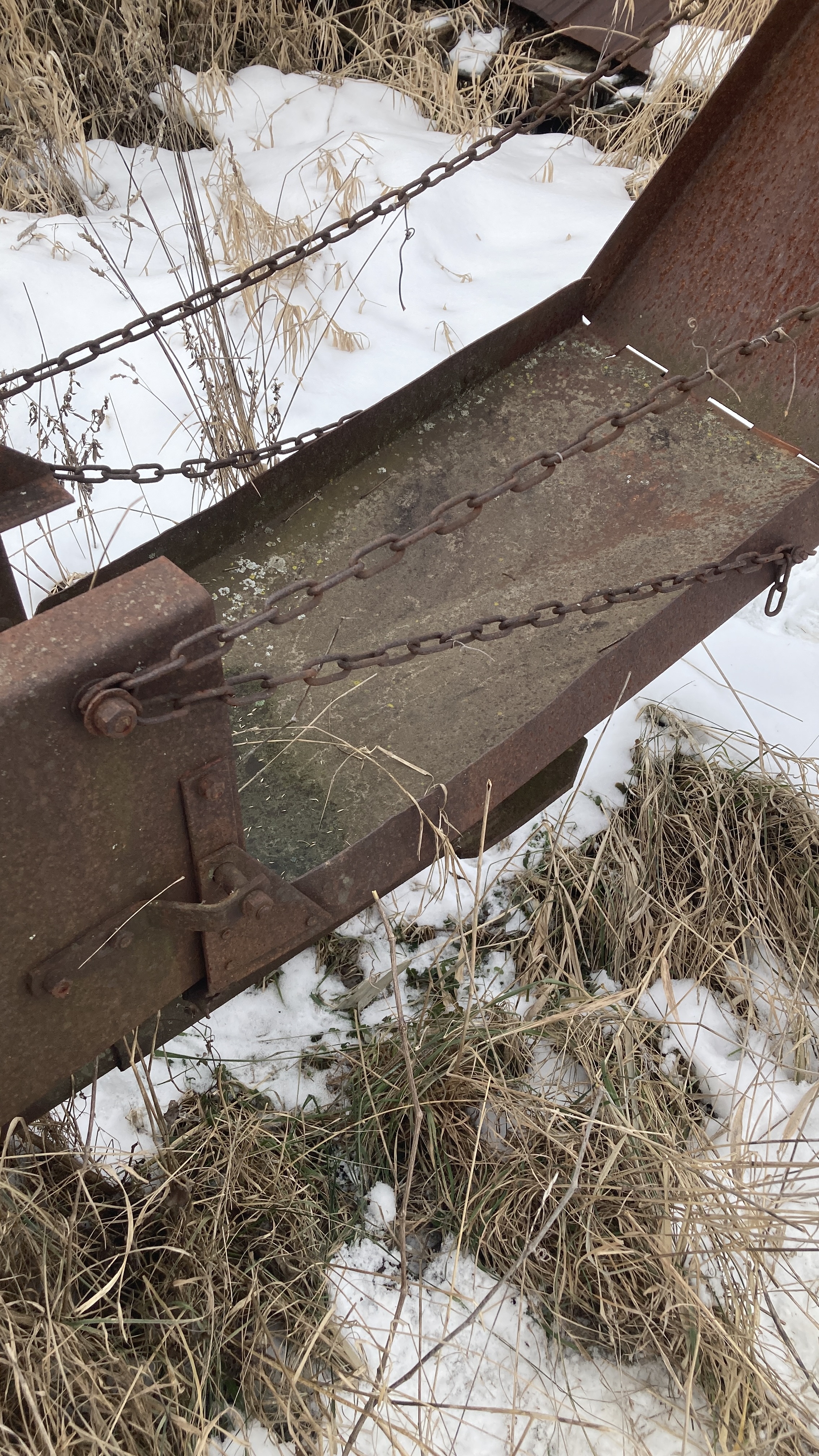

Welcome to YT forums and PartsASAP. If you still have the old chute, take it to a metal fabrication shop and they can make one. I would use a steel that was next thicker than OEM. We had one when it was only 15 years old. it made thousands of heavy bales. The knotter was fussy about the type of twine, and required some effort, but for 100, there good reason to play with it. You may find yourself looking for more hay to make. Jim
I have an original chute, I'll take pictures tomorrow.

Lower chute is 37-1/2 inches to the center of the hinge. Upper is 32 inches to center of hinge
