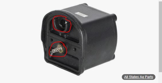

Sometimes, the little tab or the spring (both circled in red) on the coil don't mate up with their respective contacts on the distributor. All it takes is a little bit of misalignment, or a little bunching of the gasket between the distributor and coil...
They might be making contact with one distributor body and not the other.

update as of tonight, tests went well with wiring apart from coil wire, tractor needs 12v coil already on getting one from the parts guy as we call him, alternator tested as bad brushes that can start working occasionally then stop working, and coil wire was shorting to the battery platform so we fixed that, i'll probably have ol' buster (9n) running in no time. (the name came from me calling the tractor buster when upset) also incase ya'll were wondering, the possessed john deere in question is a 1990 John Deere 180 :)
