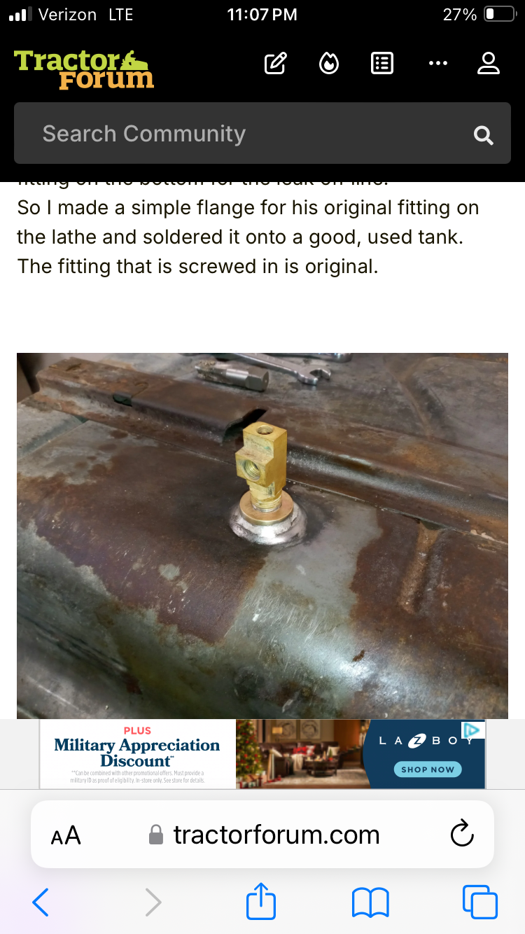

The problem is on both ends the flare was split. Which is where it was leaking. Therefore I will have to flare at least one end. Fittings are not npt. Yes going into the block is npt which I can change to whatever I want. The bottom of the T under the fuel tank is 1/8” inverted female flare. So that’s the end I’m having problems with. I cannot change that T because it has a riser on the inside on the tank. I can’t get the T loose from the bottom of the tank because I don’t want to take a chance on ruining the tank. Also it is half full of fuel! The tube that was on there was definitely 1/8”! If you try to put a npt into an inverted flare it will leak. Which is the problem in the first place! Any more ideas?

1st one is the tee out of the tank. 2nd one is the brass 90 coming out of the block. 3rd is the side of the motor showing tank on top.
