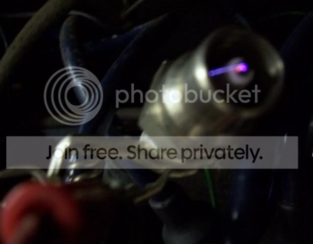

spark look good on all plugs?

What does your spark look like.It should be FAT ADND BLUISH-WHITE, the color of lightning. If it"s not, then there"s a problem most likely in the primary ignition circuit. Make sure the points are not corroded, burned, oily and that they are set correctly. Check the timing and the advance mechanism with a timing light. make sure that you have the correct firing order.Make sure that the small wire from the coil to the disributor is connected to the same terminal with the same sign as the battery ground( i.e. if the battery ground is negative, the small wire to the distributor to the coil should be on the (-) terminal of the coil). Check all the connectionsin the primary circuit for cleanliness and tightness. Jumper across the keys witch to see if that improve the situation. Key switches develope "high resistancitius" and limit primary current.

adding choke leading to a weak spark diagnosis is the dumbest thang i have read on tractor boards,,, it tells me they don't know chit,,, I will say weak spark can fool the best,,, i can also say the color don't mean chit,,,it can be fat and what ever color your heart desires,,,it still may not lite the fire,,, nuttin wrong with replacing the coil they can fool ya also,,, I can say for damm sure use a spark checker if it will jump the gap on a spark checker move on spark is not your problem,,, yours sounds like a fuel issue...
invest in a good checker... you will not be bit again...[/img]

You see this type of suggestion made regular on the net,,, its open ended with no real means of confirming the recommendation... Now being one that gets paid to chase my tail and get beat up when the issue could be confirmed fast and simple... live and learn I have been beat up by weak spark when it should have never happen... Fat are what ever color you like what does that mean,,, we are not their holding the plug wire close to a ground,,, we can not judge the distance, we can not see are hear the snap it throws... With a simple spark checker it will eliminate the systems ability to reach out and knock your socks off... That's information I can see hear and confirm no guess required,, a guess will get you in trouble,,, assuming spark is up to sunff will get you in trouble...
Applying choke could mean your spark is weak :roll: now we are off on a wild goose chase theirs no good diagnostic info in that statement,,, it never hurts to check so install a spark checker,,, spark could be good are bad you could have mutable issues, its a issue you need to eliminate so you can focus on the real problem...
