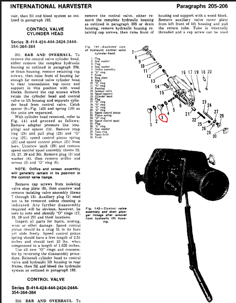

Hello. Would you be able to describe where the plug that has the brass strainer screen on the Ih 2444 hydraulic pump block? Thanks
Hello, see photo below from Service Manual, Plug #3 has the screen behind it. Read the NOTE in the photo.
