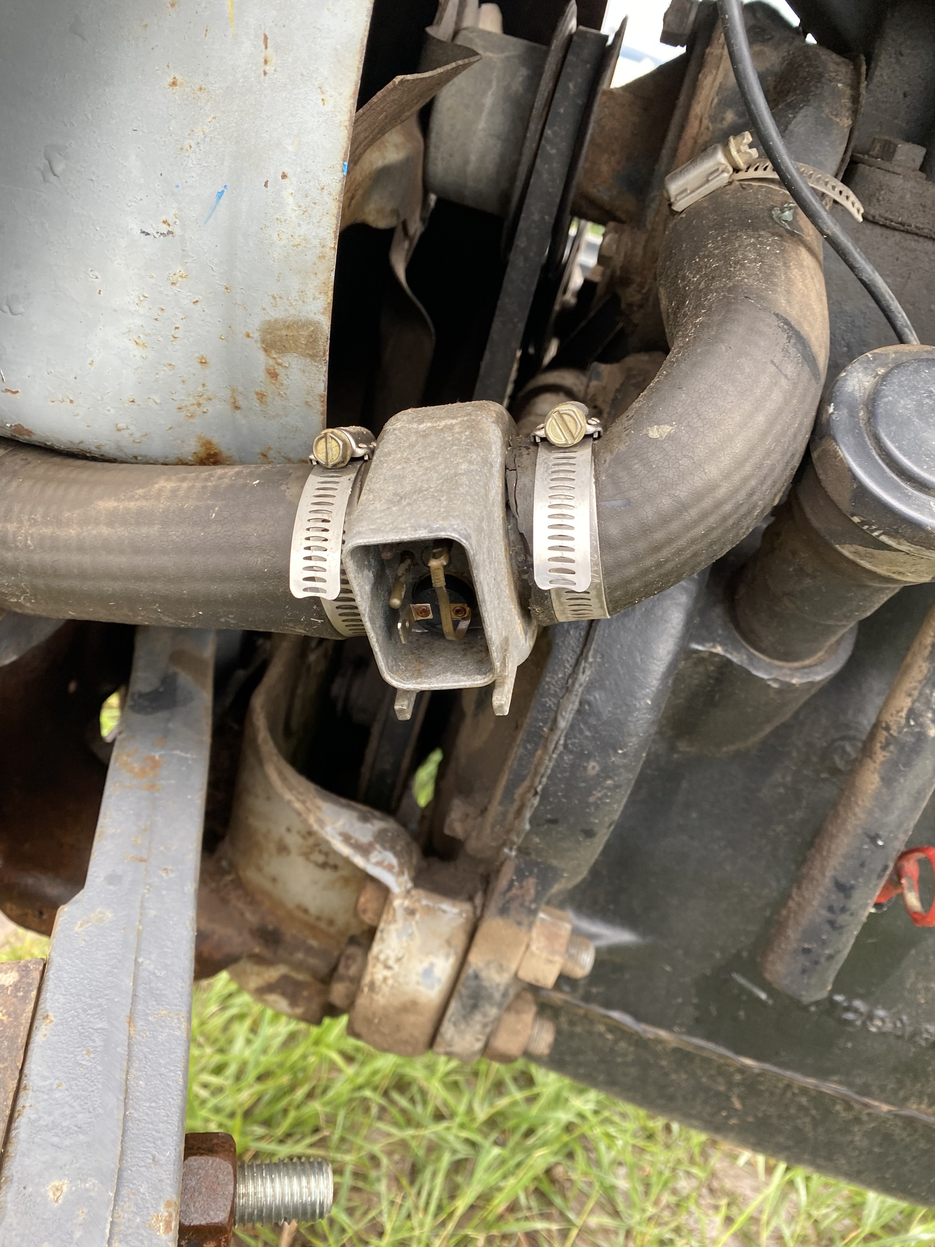

My son-in-law just acquired a 1952 Harry Ferguson TO-30 after checking the fluids and messing with things we discovered the toggle switch to give ignition was bad. We bypassed the switch and drove it for a while. What a kick.
I’ve got lots of questions but I’ll start with two unidentified parts
The first appears to be some sort of electrical connection on the lower radiator hose.

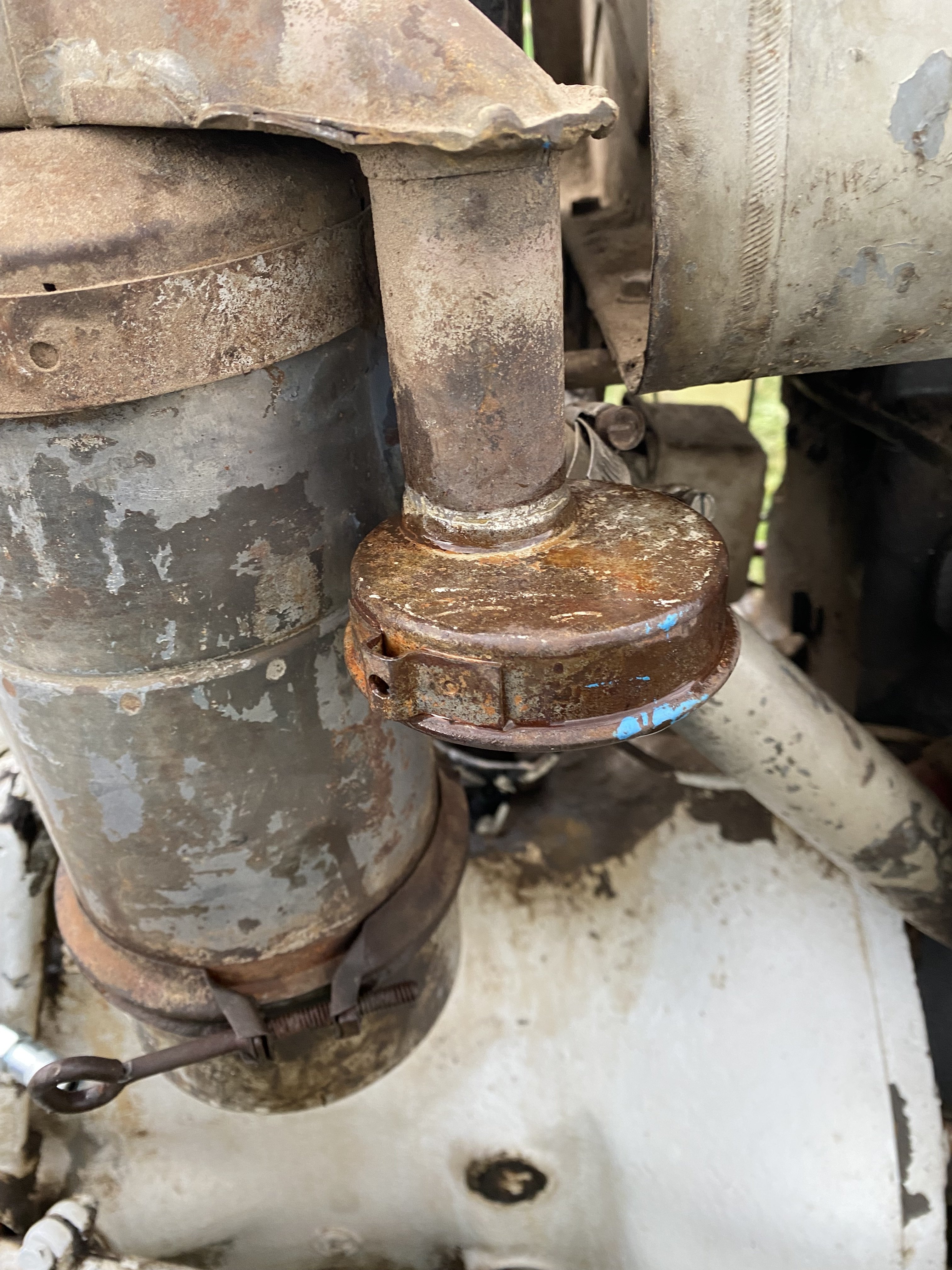

The second looks like a place to connect something to the air oil filter

The item in the lower radiator hose is an aftermarket coolant heater which is missing its power cord.
It looks like the piece on the air cleaner inlet is the flange a glass Mason type jar would thread into. Some were OEM and some were aftermarket add-ons as a pre-cleaner arrangement.
The TE-20 I got from Dad has the inline hose heater. It was hard to start when it was cold. After he changed it over to 12 volts it wasn't really needed but it's still there.
