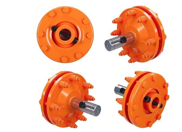

Convert from the shear bolt to a slip clutch on the gearbox. They are available. Below is a sample. The PTO shaft may need to be shortened to compensate for the length of the slip clutch.
An over running clutch will not help with reducing breakage of shear pins. It will prevent the inertia of the brush hog from turning the PTO when you disengage it. That will help save the life of the Independent PTO brake, if your tractor's PTO brake still works. Adding one may also require shortening the PTO shaft.

Thank you, Jim. I ordered one off ebay just like the one you have pictured.
