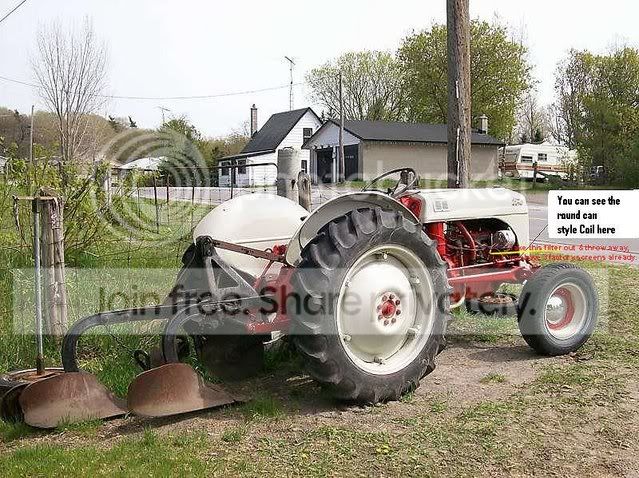

Well, I think i MAY have found a problem.. I had spark when it shut of, no leak as a propane torch didnt make a diff around the manifold. As soon as it stopped, I checked spark, it was good. I then opened up the carb drain and it just trickled out. I pulled off the fuel filter it just trickled from there. removed the filter and it pours nice and steady. Has to be my fuel filter. Now, I need to find one local!
(quoted from post at 14:53:03 08/29/08)
Are you saying you have an in line fuel filter on it??? If you are then yes that is probably 75% plus of your problem. When new these tractors had 3 filters in them. One in the tank, one in the sediment bowl and one in the elbow on the carb. In line filters or most of them are made for fuel system that have 7-75 PSI to push fuel out of them but your gravity flow system is lucky with a full tank to have 1/-2 PSI so the in lines do not work well. I have been payed many times to remove them from tractors. Going rate is a case of beer and believe me I have drank a good number of beers for fixing that problem
Like Old sez, if you have an in-line filter, chances are that's been your problem all along. When you go to look for one, make sure it is for a lawn mower w/ a gravity feed. It might work for a while, but sooner or later, you need to fix the problem: a rusty gas tank. Once you get that fixed, replace the cut-up fuel line & it will last another 50+ years.
If I ever re-do the 50 Tips, I think # 51 will be: "Fix the problem not the symptom: do not install an in-line fuel filter, or get rid of it if you have one. Clean or replace the gas tank!"
