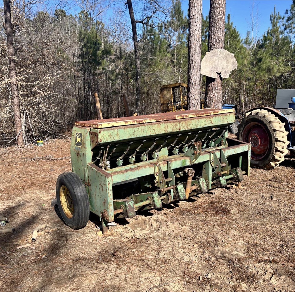

I purchased a JD 1500 power seeder for planting small food plots and it’s in pretty good shape. The only things that need replacing are the cutting discs and they are not available along with a host of other parts. I set up a CAD file to duplicate the discs out of mild steel and sent it to send cut send where I’ve had previous parts made and was pleasantly surprised with a price of $30 each and down to $19 each in larger quantities.

We took the drill to the farm yesterday and hooked it up to the tractor to make sure everything works, lube it up and assess any needs. After spraying the parts that need to move with AeroKroil it loosened up nicely and the right wheel turns everything smoothly. There are a couple of plastic ‘closers’ that need repair or replacement and I don’t see them available anywhere, so it might be time to have some 3D printed. All in all I’m very happy with my purchase and I should have less than $2k in it once all is said and done. I’m hoping that the manual arrives soon!

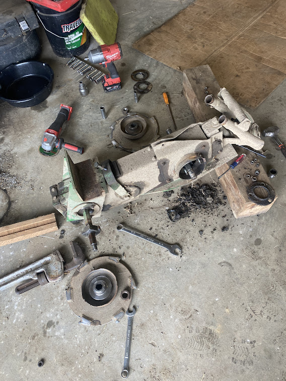

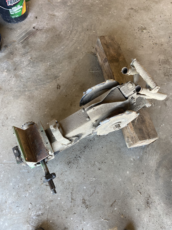

Not knowing what other equipment you have, my recommendation is to remove them and run a cultimulcher after planting. There is so much debris that wraps on them and dirt flying they don't roll great no matter how much you grease them. Also there is no down pressure. Assuming yours are hanging from a chain like mine were. They just kind of bounce around back there. If you look at my picture above you will notice that they are removed. I have all the parts if you are determined you need them. Some of mine are missing chunks out of them.
My advise though don't waste the money and run a packer instead.

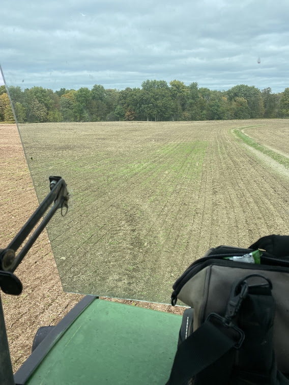

Some field shots of the rye planted with the drill.
Make sure the chains are properly adjusted and check for any play in the bearings. Make sure all boxes have plenty of corn head grease in them. Repairs on these are not fun.
View attachment 144090View attachment 144091View attachment 144092

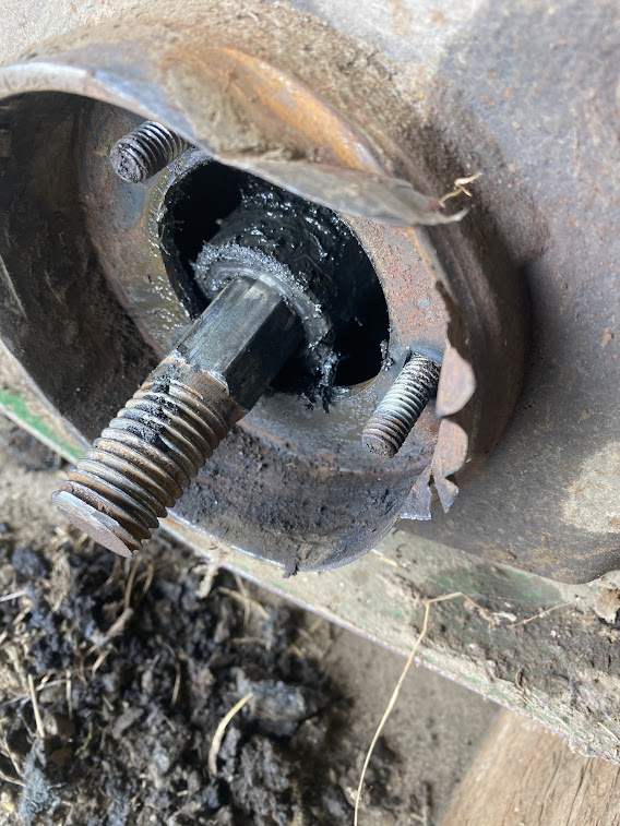

View attachment 144094View attachment 144096
Thanks for the great advice and I’m very much a novice with grain drills. I’ve got plenty of cornhead grease and I’ll load the boxes up when I install the new cutting discs. The 1500 looks a little different from yours where the cutting discs mount, it’s just a clamp on style with the retaining nut tight. I understand they are notorious for getting loose and I might install locknuts or castle nuts to keep that from happening. The man I bought it from showed me how to swing the cutter boxes down and forward so I would have good access when changing the discs using a torque wrench. Also, would an cultipacker do a good job? Any other advice will be more than welcome!
