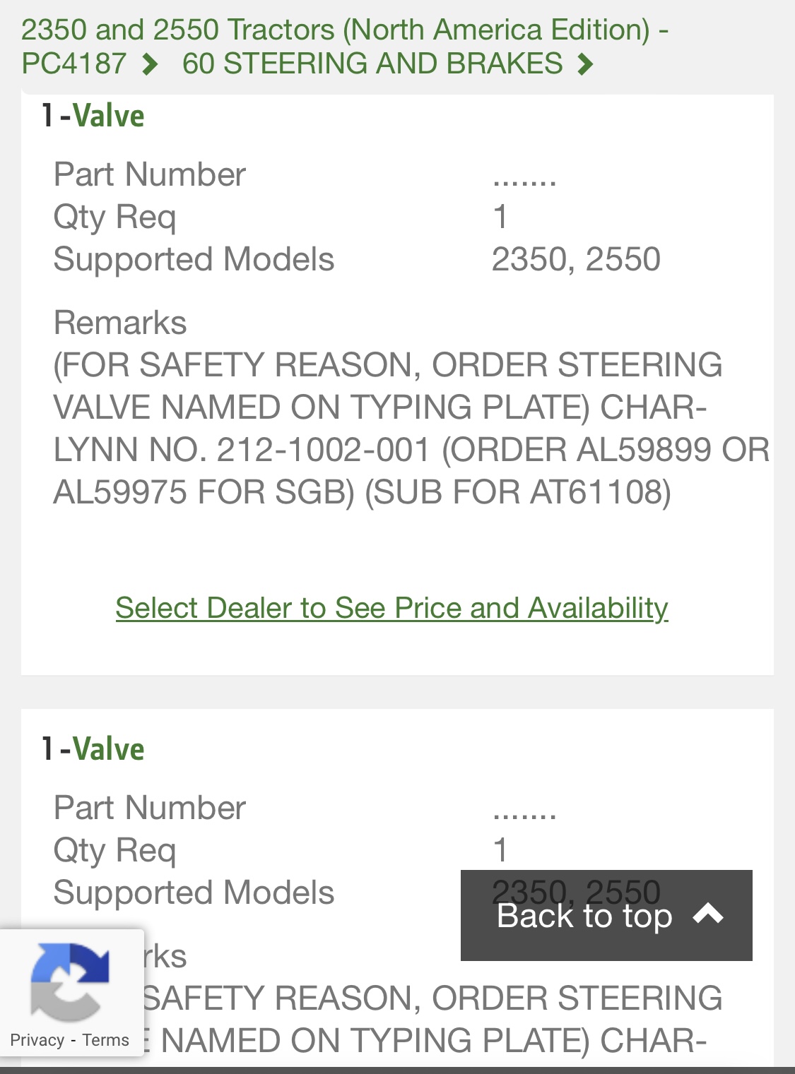

The JD 2350 steering pump is a AT61108. So you believe I got a new "bad" pump? This particular 2350 has the valve that attaches to the pump, not directly hosed. I cleaned the "valve", but it is more of a port block to direct flow, not actually piloting any valve per say. My next move is to directly hose to the pump to eliminate the valve from the system as some 2350 schematics show. It it continues I guess Im in another 1K for a pump.

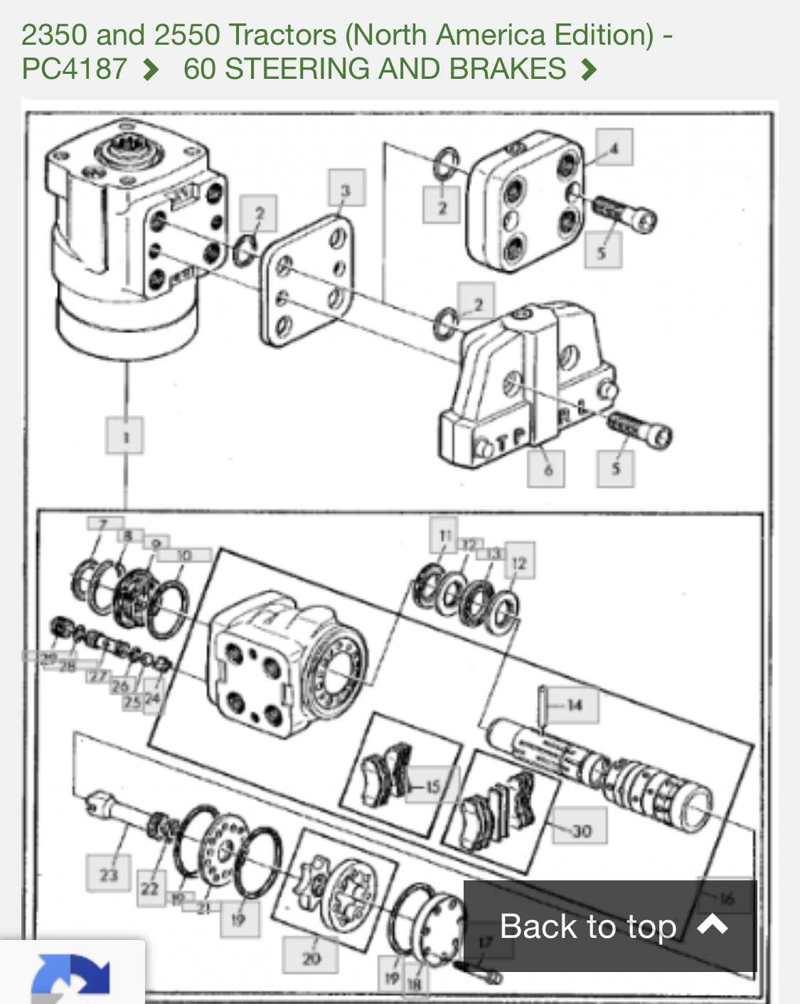

Is this what you are working with ?
So, in your view, should I disassemble the pump to see if the seals are blown or dislocated in some way?
I failed to mention a detail. When the tractor is running, and you turn the steering wheel, energizing the pump, both the bucket and the draft will begin to work immediately. It would appear no oil is making it's way thru the valve/pump until you turn the wheel. Pump?
It a steering control valve , it is not a pump .
No oil should flow in or out of it until the steering wheel is turned . This is a closed
Centre , not an open centre system .
Odds are the steering valve has failed and is diverting the front pump’s high pressure output to the transmission sump . Leaving insufficient oil pressure and volume to operate the rockshaft , SCV and loader .
btw , how are the loader hydraulics connected to the tractor ? What kind
Of valves ?
Some loader systems are incorrectly setup to take the oil from and return to the SCV . This causes the front pump to cavitate as the transmission pump can not keep up with sustained high flow loads .

I suggest your return the faulty power steering valve & install a functional steering valve. I've heard later styled steering valves such as yours referred to as a pump but I never understood why the term pump was used for a control valve.
Of valves ?

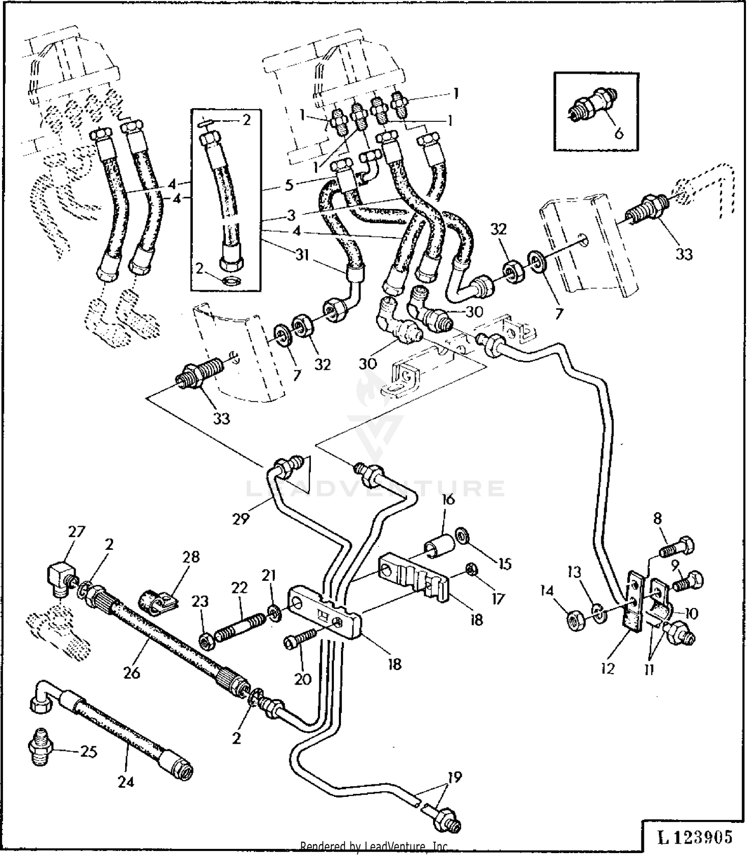

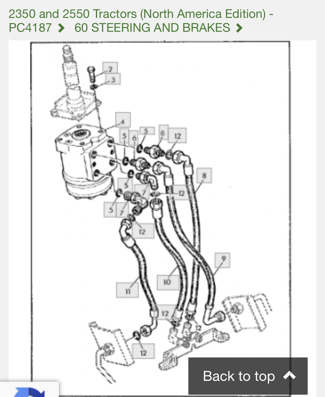

Which one is the supply? There are two that come from the hyd pump in front underneath the battery. Step side or opposite?

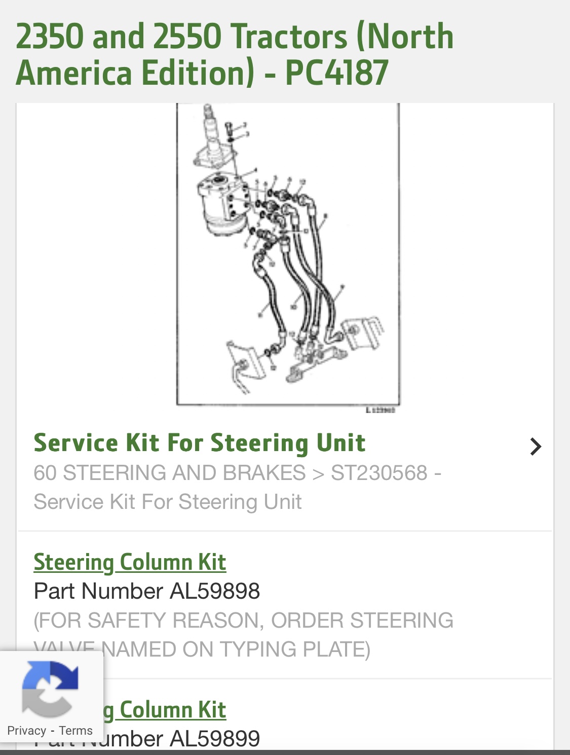

Are you SURE all hoses to the steering valve are connected correctly?

One is supply and the other return. Or both supply?
