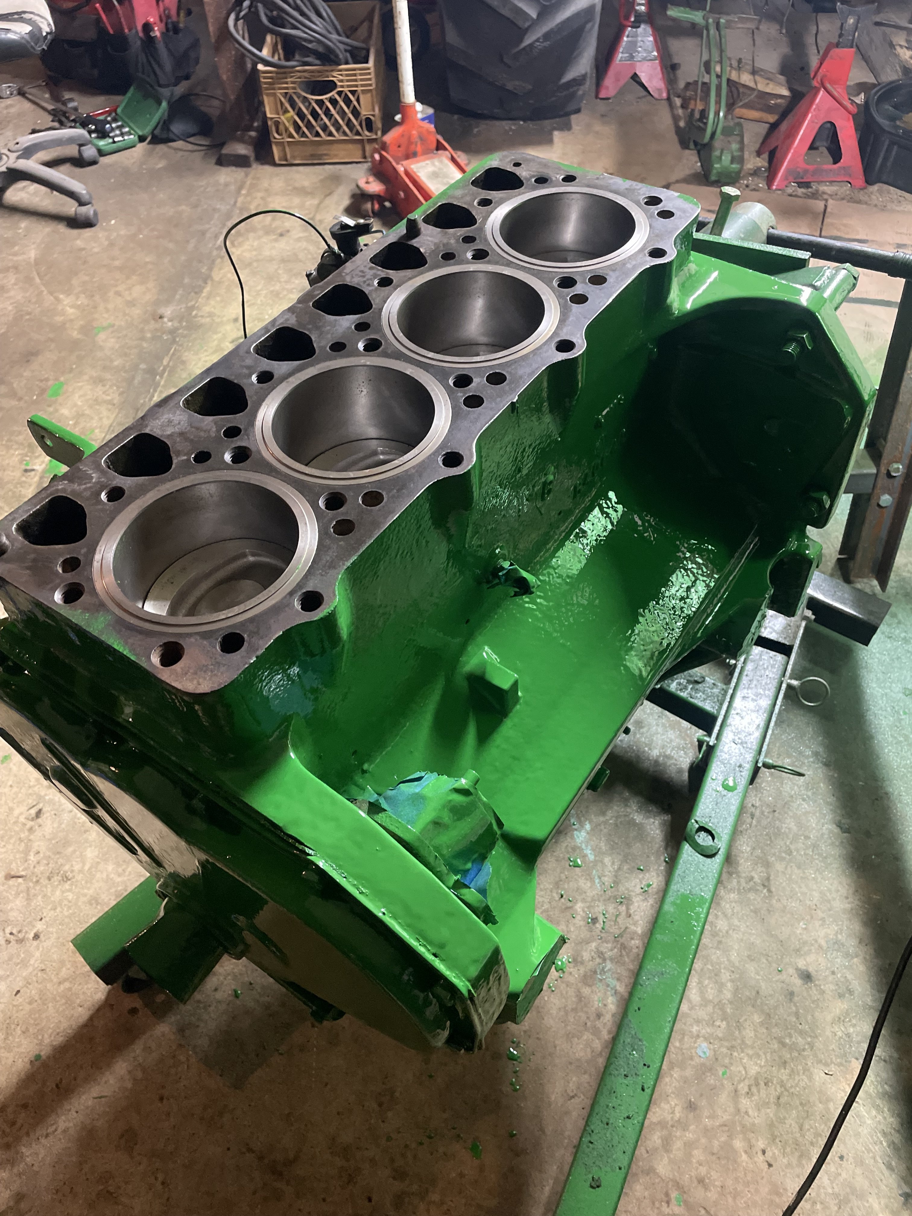

Hello all, I have a 3020 gas that i have completely rebuilt as a project on and off. Before I begin I’ll add I have never had it run it sat under a tree for 30+ years. I completely rebuilt the engine bearings, liners, pistons, rings, head. The whole deal. Literally nothing is origonal. Finally got around to crank it up and I cannot even get it to fire.i believe I may have two problems 1st I have great spark especially after putting in a new wiring harness. Timing? Second, The carb has an issue I have to resolve as it is flooding gas back to the intake but I believe that is the needle sticking. Carb is full, intake is damp but plugs are dry. Carb is rebuilt and a zenith. It is pulling good vacuum when cranking. Upon rebuilding the engine the oil pump was out and I did have the service manual and remember having to time the oil pump and then the distributor 15 degrees off of a certain point which I cannot recall. I’m curious if anyone can tell me what the proper procedure would have been to time the oil pump and also they can make any sense of this. I am confident the oil pump was installed correctly but it was some ago now. Shouldn’t I at least be able to get it to fire if the timing isn’t spot on? Thanks
(Just a pic of doing the engine)

The oil pump/distributor drive position on the gas version ISN'T critical compared to the diesel version because if the oil pump hasn't been timed "by the book" the distributor body can be rotated and the wires rearranged in the cap as needed to get the timing "right" for "1, then arrange the other wires in firing order in the direction of rotor rotation.
You need to find TDC on #1 at the end of it's compression stroke, position the distributor body so the points JUST start to open, then put the #1 sparkplug wire where the rotor points, and the others in firing order.
That should get it started, then check timing with a timing light at high idle.
Does it fire on ether? Distributor should be counter clockwise rotation. Firing order is stamped on exhaust manifold on left side.
