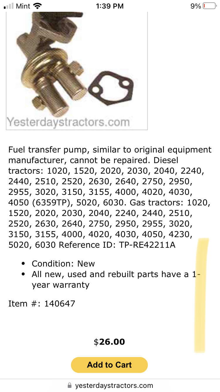

Thanks for your suggestions. This morning I checked the dipstick and it was above the full mark. I decided to drain the oil and it filled a five gallon bucket. I thought I was going to need another, but luckily I didn’t. A mixture of oil and diesel fuel.
so half of the oil or so is fuel. Probably why more is making it out the breather tube if there’s so much fuel it will be lighter. It’s highly likely it’s a transfer pump leaking into the crankcase that’s where I’d start it’s cheap
I changed the filter and oil. Got the new pump installed. Primed the fuel line. Tractor started and ran fine for about 15 minutes and then died slowly. I’ve bled the fuel filters and it would run for a bit and then died again.

Hello Bellschool, welcome to YT! We need to know a bit more about the tractor. Have you been using it as a working tractor before this happened? It sounds like the governor weight flex ring is coming apart in the injection pump. When this happens small chunks of plastic plug the check valve in the return line coming out of the pump. When this happens pressure builds up in the pump housing and the high pressure pumping elements in the pump can’t return to draw in fuel for the next stroke so the engine stalls. A way to test for this is to slightly loosen the two screws on the small rectangular timing window to let some fuel leak out when the engine starts to stall. If the leak off allows the engine to continue to run this verifies your problem. If this is the case the bottom line is the pump needs to come off to be rebuilt.
Edit to add: I asked about it being a working tractor because it seems odd that you would have a transfer pump problem that filled the crankcase with fuel and then turn around and have an injection pump problem as well. Odd coincidences can happen. If this is a tractor you are just getting familiar with and are running it more than it has been for a time then coming across multiple problems is not so unheard of. Secondly, leaking drive shaft seals on an injection pump can also let fuel into the crankcase so you may actually have “a two for the money” problem with the IJP.
