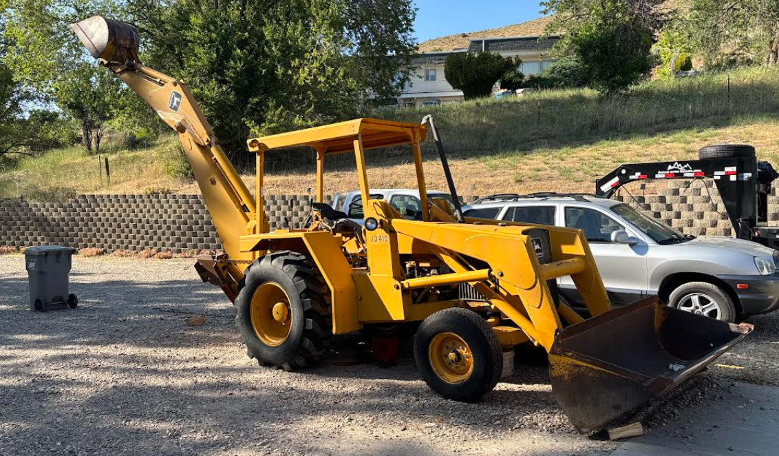

I recently acquired a JD 410 backhoe that had been sitting idle in a field for several years. First order of business was just getting it home.
Some background:
  • After charging the batteries, it fired right up without hesitation. It runs extremely well. The diesel tank had been topped off before it was parked, and the fuel still looks surprisingly clean.
  • When I first checked it, the hydraulic oil was super low and it wouldn't budge—I'd guess it was down about 15 gallons. I added 10 gallons just to get it mobile, but once I got it onto the trailer, it immediately lost all hydraulics and drive.
  • I winched it off the trailer at home, started it, and let it run for about 15 minutes.
  • I then agonizingly slowly compressed as many cylinders as possible and drained what I could from the hydraulic system—what came out was a full-on milky mess.
  • I removed both hydraulic filters, which looked nearly new. Which tracks with what the previous owner was saying.

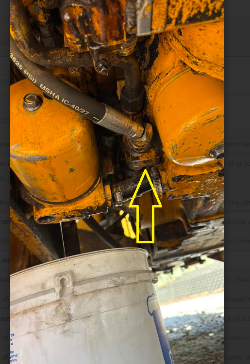

Be sure to check/clean hyd oil suction screen(item 70). I would use the cheapest hyd that meets spec's of J20C for flushes. I hope moisture in hyd system hasn't ruined the clutches that operate in hyd oil.
Is that it (yellow arrow)? I didn't actually replace the filters yet (ordered), I just put the covers back on empty to keep the dust out.
No quite right. It should be behind the fitting in the side of the transmission case. You may need to remove that outside hydraulic filter to pull the screen. It is a good time to get a piece of the proper oil rated hose and replace it. You JD dealer should have it by the part number and sold by the inch.
