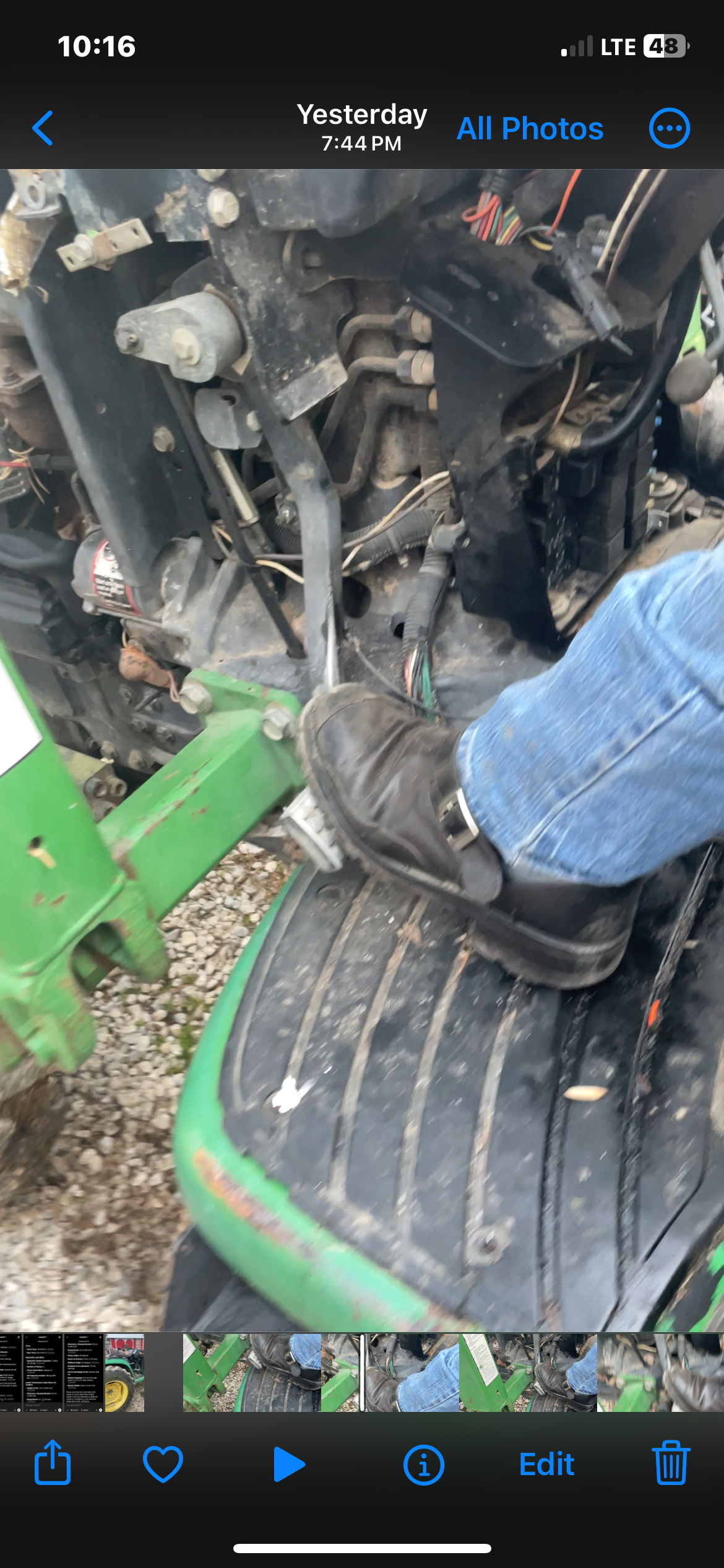

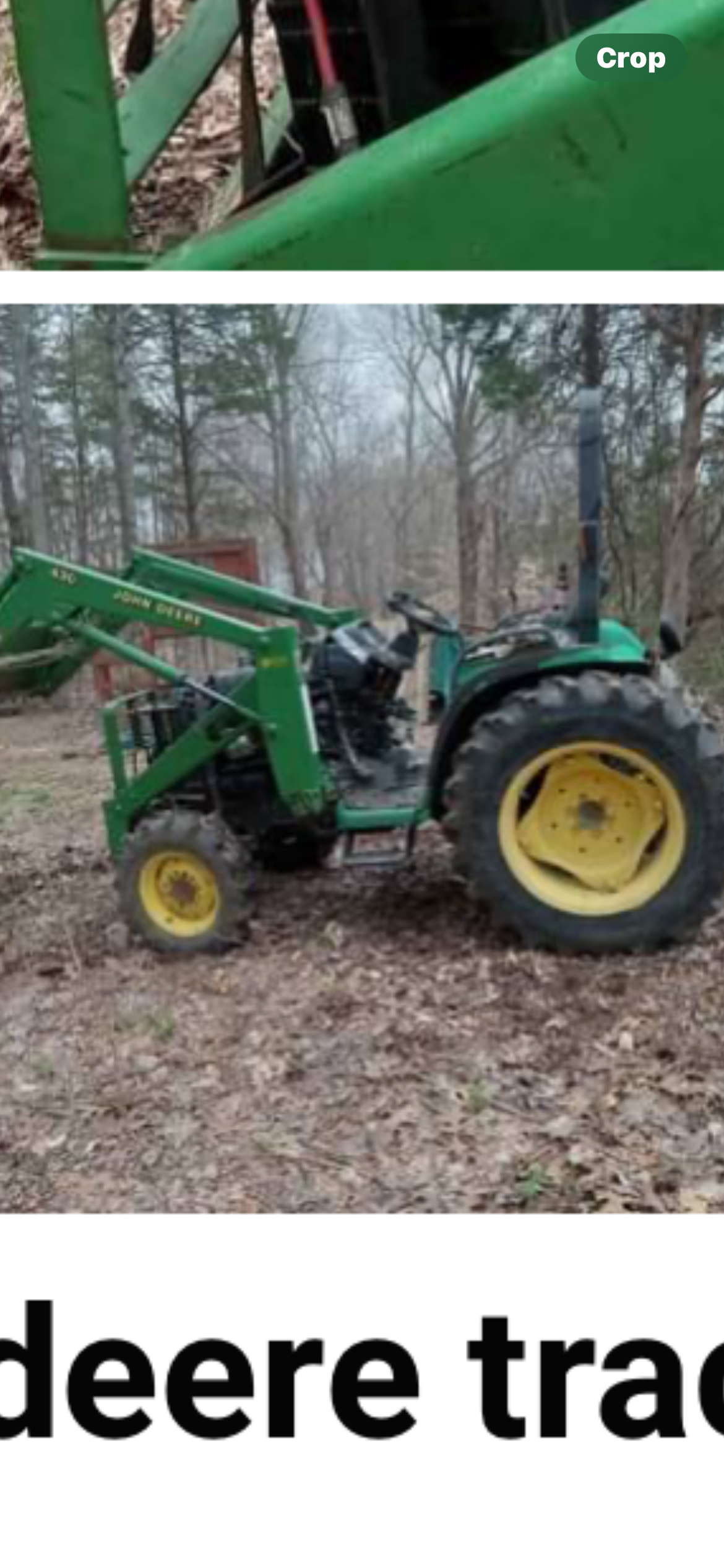

looking to buy this old tractor which she says is a 4300 with a 430 loader, it looks like an older tractor when I looked at it and online looks like a 430 U has the limited slip I guess it's called he said it's not true four-wheel-drive but I can't say I'm not a tractor guy and the bucket and three-point lift incredibly slowly and he has water in the hydraulics because he or his son put water in the hydraulics, he's a drinker. Just wondering whether it's 430 or 4300 and is it worth $3500 if I end up having to do the hydraulic pump and get the clutch adjusted ? Clutch has 4 inches of travel before it pushes and obviously it's not working properly because he can't get it into gear properly. I have a video I'll try to upload but I don't know if they do videos on here my pictures aren't that great. Way to tell by the picture if it's a two or three cylinder? I'm a complete newbie on tractors.

Update, talked to tractor guy other than him and he says if 4300 it has to be 4x4? Also he said he thinks the hydraulic pump is located up front on side?

It's NOT a "430" (built 1958-1960), it MAY be a "4200" or "4300", built by Yanmar for DEERE, and sold 1998-2001.
The transmission and "rear end" casting is used as the hydraulic reservoir, if there's water in the hydraulics the transmission and final drives have water in them, as well.
I don't think you can run away fast enough from this thing.
Parts are $$$ and, (sadly) parts availability MAY not be great, either.

The hydraulic pump is up front at the RH side of the engine, driven by the camshaft gear train, it draws it's oil from the rear housing of the tractor (there's no "hydraulic oil tank") and if water has, in fact, damaged the hydraulic pump the transmission and final drive parts and bearings have had the same water exposure. What transmission does it have, if "Hydro" it would be even more vulnerable to water contamination.
Any clues as to have much water has been added, and how long the tractor has been sitting with water in it?
Have you checked the level of the hydraulic oil? Also, LOOSEN the hydraulic/transmission/rear end drain plug(s), oil floats on water, so any water will have settled to the bottom and you can get some clue as to haw much water is in it by letting it drip out while the plug(s) are loose.
There should be a Serial Number plate on front-right tractor frame, above front wheel that will also show the Model Number.
Once you have the model number you can go to https://techpubs.deere.com/en-us/Search/Equipment and download the OPERATOR'S MANUAL for FREE, which will tell you have to check the oil level and where the drain plug(s) are.
