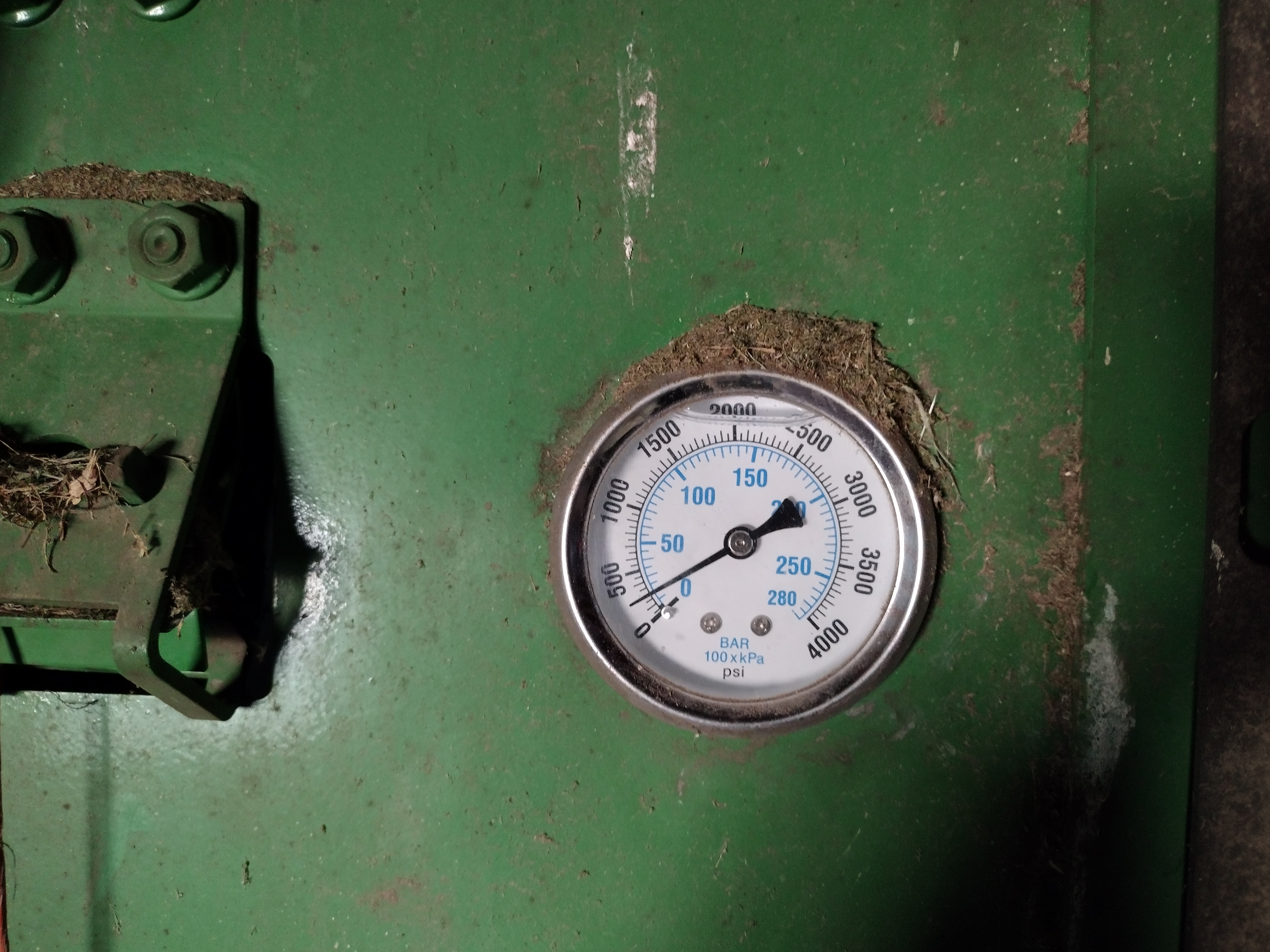

JD 56X balers. If it has a fixed pressure relief valve is set at 4000 PSI. If it has an adjustable pressure relief valve high value should be 4000 PSI. Low value is unknown. It would be hard to read the pressure gauge from the tractor seat. You could T into the tensioning block and run it to the cab and have it right next to you while baling. Also works great for for detecting early failures before they happen.
A bigger diameter gauge would allow for reading and a mark on the glass at the correct pressure would also solve the problem .Other wise it is just another thing to deal with hitching up and unhitching.
JD 567 will have an adjustable hyd tension valve from the factory. Have you attempted to adjust that valve to a higher bale pressure?
I've observed pressure gauge on my JD rd balers from tractor seat many times & could determine location of gauge needle. I suggest to install an operating gauge on this baler.

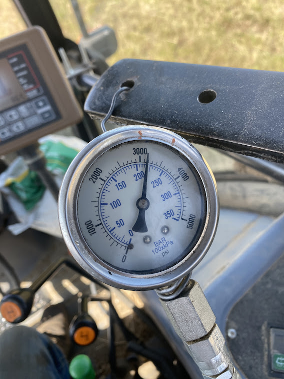

It really isn't that bad. I could tie it up on the baler if I didn't want it in cab. I can also remove at any time and cap the T. Having it easily accessible and visible has been invaluable. And because it was easily accessible my son was able to make a video of the baler operating properly so I have a baseline to compare should I have issues. Also has been very beneficial for other member of other forums that are questioning if they have issue. The only way to get ahead of an issue is to install a gauge. Otherwise your just wondering. I'm running a 459 but it applies across Deere's line of balers.

You could mount it in the cab and have a quick disconnect right outside the cab to couple the line to when baling.
I would NOT put any high presdure gauge in a cab! Put it outside. Tape it to the window.
Thanks for all the replies folkes, all of them were helpful.
I'll put ina 5000 PSi gage in place of the original.
