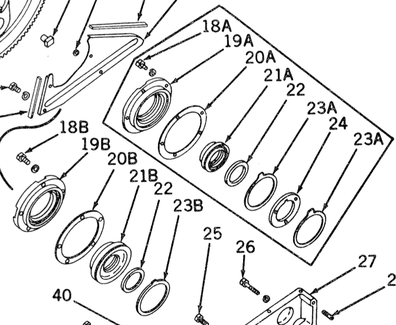

(John Deere 730 diesel standard) Well bought a new tapper lock flywheel (Allen machine) as well as the wrench. I am working on taking off the spacer and thrust washer behind the flywheel and cover to freshen up, but for whatever reason the spacer is tight, sprayed some penetrating oil a softly tapped with a brass drift and hammer with no luck. I would appreciate some advice on this. Manual says pull the spacer off, that's it! Not this time! Thank you in advance.
IIRC that spacer (slinger) is held in place with a small screw with a square head like pictured below. The surface of that slinger (spacer) is probably worn smooth and the head of that screw may be difficult to see. # 18A or 18B.
Actually that is #14 spacer pin not 18A or 18 B.
Actually, the "slinger" has a cork ring in it (or possibly rubber) and simply slides over the crankshaft. Either is stuck in place with hardened "varnish deposits" from years of operation, or possibly someone has stuck it in place with some sort of gasket sealant
As to the "small screw" the other poster mentions it is not a screw at all, but actually a non-threaded pin that pushes into the "slinger" with it's square head exposed. There is a slot in the flywheel into which the square head engages as the flywheel is installed (the slinger must be positioned so the head of the pin and the slot in the flywheel match up).
With the flywheel removed the little pin has NOTHING to do with sticking/holding the slinger in place.
Before putting this together, IF the head of the pin is worn off, look closely for it's remains and drill a small hole on it's center and engage it with an extractor or self- threading screw and twist it and tug it out of the slinger.
