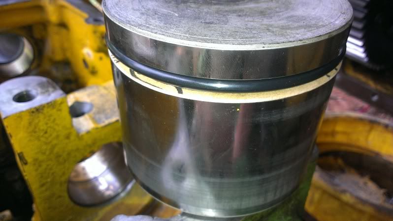

JD 730D Powertrol piston
730d se
Well-known Member
New o-ring and wiper, should fix the drifting down issue of the hitch.
