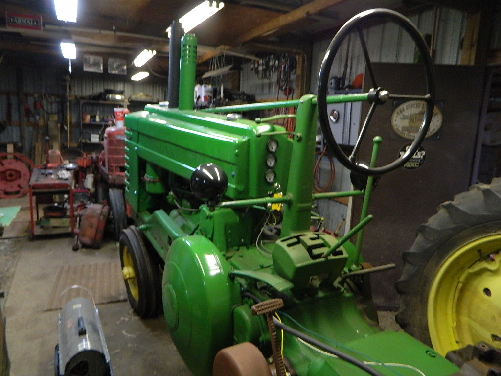

Howdy folks, two simple, unrelated questions for other A owners out there.
First, from an operator standpoint, how do you know what RPM to set the engine at when using the PTO? I'm used to running a tractor with a tachometer and want to make sure I don't overspeed the implement. Any advice appreciated. I know its probably a dumb question but nobody I know has run these tractors other than in parades so some of the knowledge of how to use them in the field is lost around here.
Second, does anyone have the dimensions for the choke rod? My tractor is missing the rod completely (probably rusted away) so its a chore to start the tractor. Specifically looking for the diameter of the rod and ideally the length so that I can fabricate a new one.
For reference this is a styled 1950 JD A.
Thanks!

The choke rod is 1/4"
You should be able to stretch a tape measure to get the length. Add enough for the 90 degree bend at the carb end and enough at the other end for threads to screw the knob on.
I'd go out and measure my '52, but we got a foot of snow last night and I'm not inclined to go out and battle that right now!

We used to push it all the way forward and then pull it back a wee bit to run the New Idea picker. Pa had one of those Stewart Warner hand tachs he put on the pto one time and determined that's where it needed to be for 540.
The choke rod on my A is 49" long plus an inch for the bend. I have the 18 gallon tank and the choke rod is mounted to the light bar.
