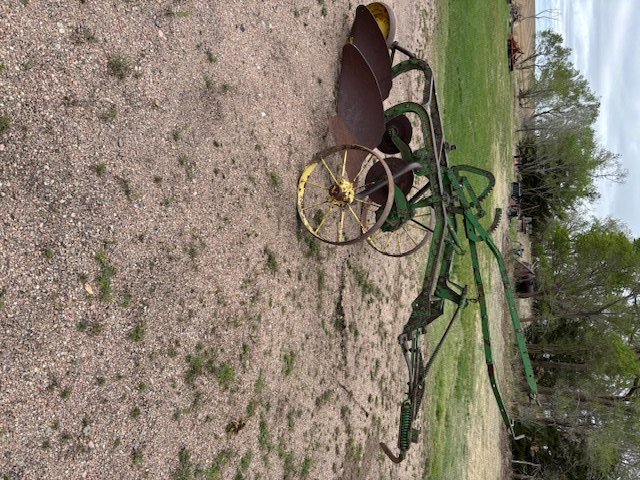

Well, I've been working, trying to post the picture. No matter which way I rotate my picture in my files, it will not post right side up! For some reason I have this problem whenever I try to post on YT...no other site anywhere. So, here's the picture...but sorry, you'll have to figure out how to look at it.

thats an oldie ! way older than the 55's. could be 30-40's vintage. and the other thing them old plows used shares

it would be furrow width.
and them shares are blacksmith shares, not the replaceable throw away ones. once worn out you took them to the blacksmith and he built them up and sharpened them on the trip hammer. i remember watching this procedure when i was young when dad took them in. i got a j.d. 4/16 plow with them shares and dont want to use it too much to wear out the shares.
If it’s a 4D, they were made from 1938-1949. Beam numbers will confirm.
Looking closer at the picture, what appears to be the rope trip lever seems to be bent too far forward, but I’m not sure if that is indeed what I’m seeing. The hitch release hook looks like it’s backwards too.
No the hitch release is right. It turns all the way around from top to bottom. When you hook it in the ridgid tractor clevis you swing it around and push it in from bottom. Then you slide the collar over it on the top.
You’re correct in how it functions, but if you zoom in and look closely, the release hook looks like it’s been bolted on backwards at some point (or can that rotate on the spring?). As is, it won’t flip up and lay flat on the tongue so the collar can slide over. No big deal to correct if it’s the case.

Shares, lays??? Most called them lays in my younger days (1940's - '50's). Blacksmith shares; I have several old plows (55ABH models) with them and have a few hanging in the shed that have never been used since being rebuilt.
