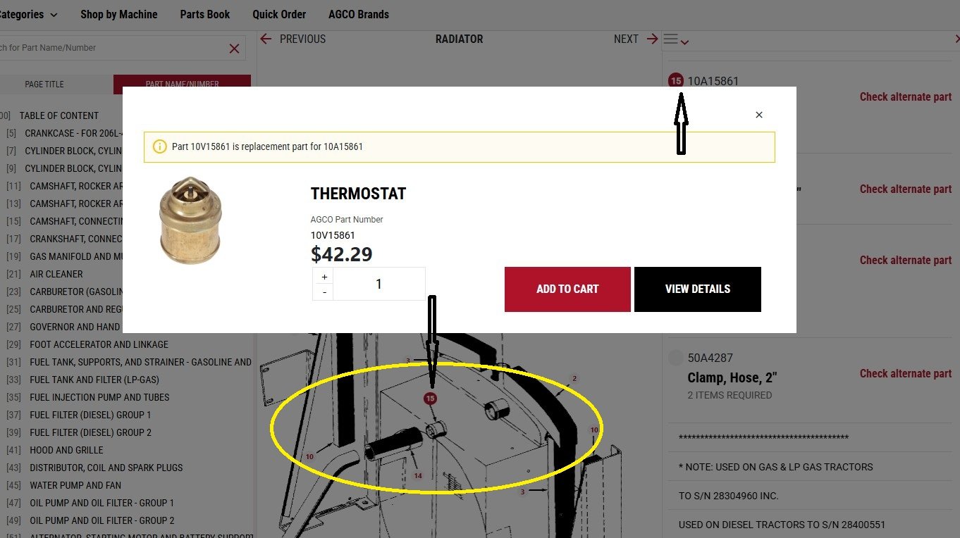

1967 JS3 Super gas. Is it necessary to drain the coolant in order to access/remove/replace the termostat? I assume it is located in the top hose, near the radiator tank.
Also, can anyone provide me with the part number for the proper replacement thermostat? I cannot seem to find a part number offered in various parts catalogues.
Thanks!
The online Parts Book shows part number 10A15861 which is replaced by 10V15861. Price is about $43.
It shows as in the top hose at the tank. You will need to drain coolant below it, unless your radiator is real low.

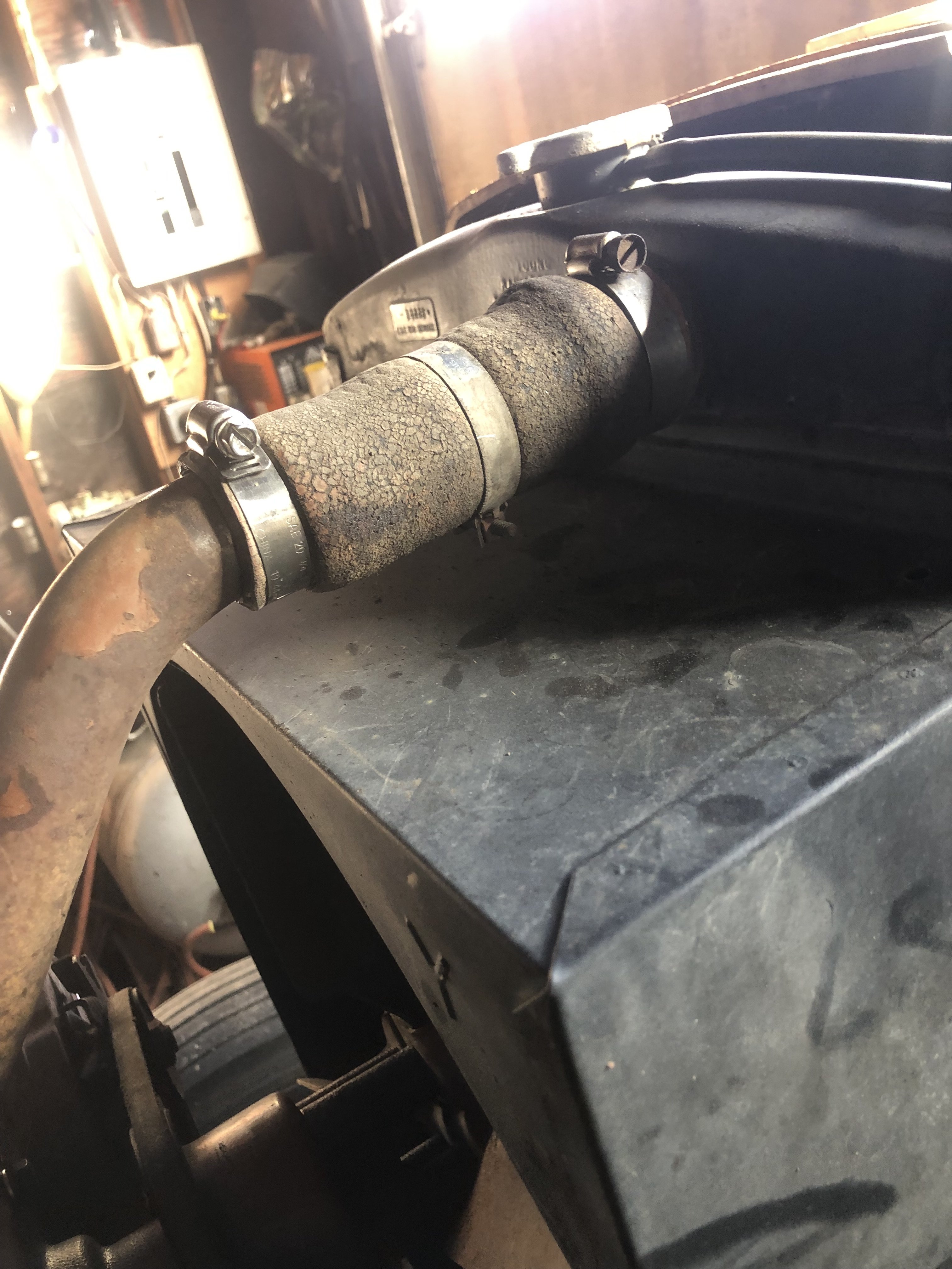

I am working on a jet star 3 and it has no thermostat. Unless you’re saying it’s in this top hose. ?
I had that hose off and nothing was in it.

I actually have no idea where it is located or if it even has one. I just assumed that it has one, but not certain of that. I also just assumed it was in the top hose, but not certain of that either. Since I wasn't sure if coolant needs to be drained, I have not yet removed anything.

From the parts book.
